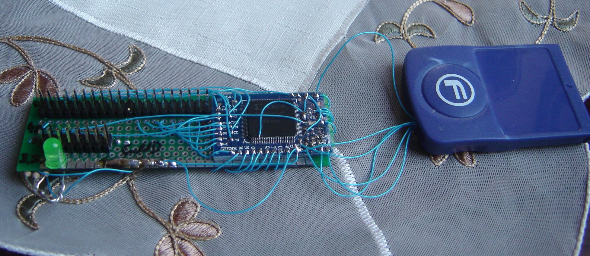

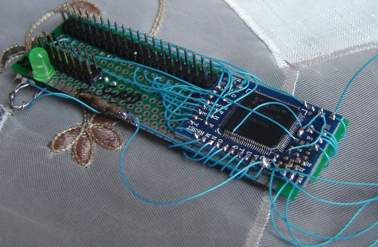

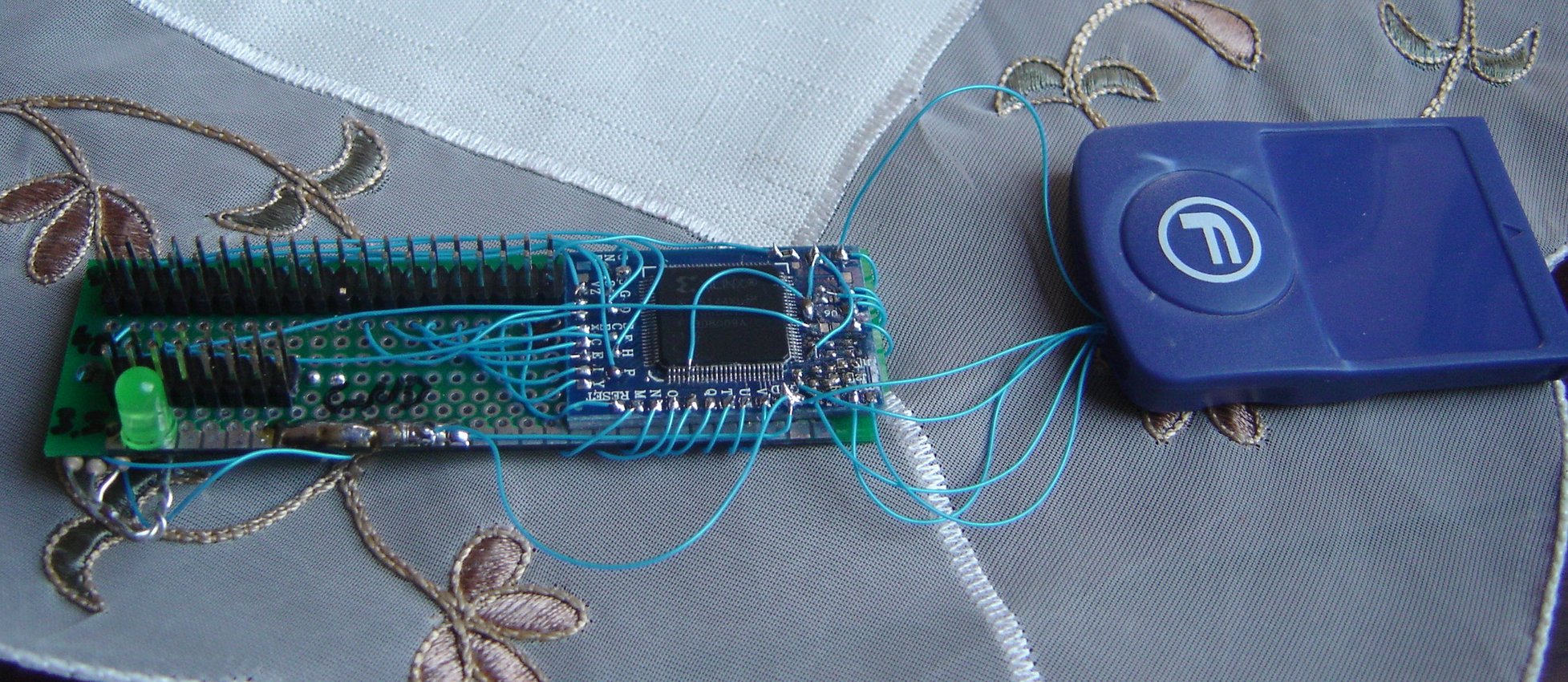

status update:
I've built my adapter but I must've screwed up someplace, I'm going to re-check connections and try again tonight :)
Posts: 4927
Re: Homebrew HDD adapter for Gamecube Tutorial
Post by emu_kidid » Wed Oct 27, 2010 8:16 am
Got it working :D
Time to implement it into the new SD-Boot.
I had too many pins on the IDE grounded (pin 28) and I also had cpld pin not connected. I'll post up a guide on how it was built later this week.

emu_kidid wrote:Got it working :D
my pin 28 is also connected to ground, is it used for something in this or could i just cut the pin? might be why mine doesnt work.

emu_kidid wrote:Nope, it's not used for anything, feel free to cut it.
i did but got the same fault anyway. my act led does light up as soon as i start the hdd-loader, but just lights up, no blinking or something like that.
could you maybe upload a video of yout hdd-adapter in work?
