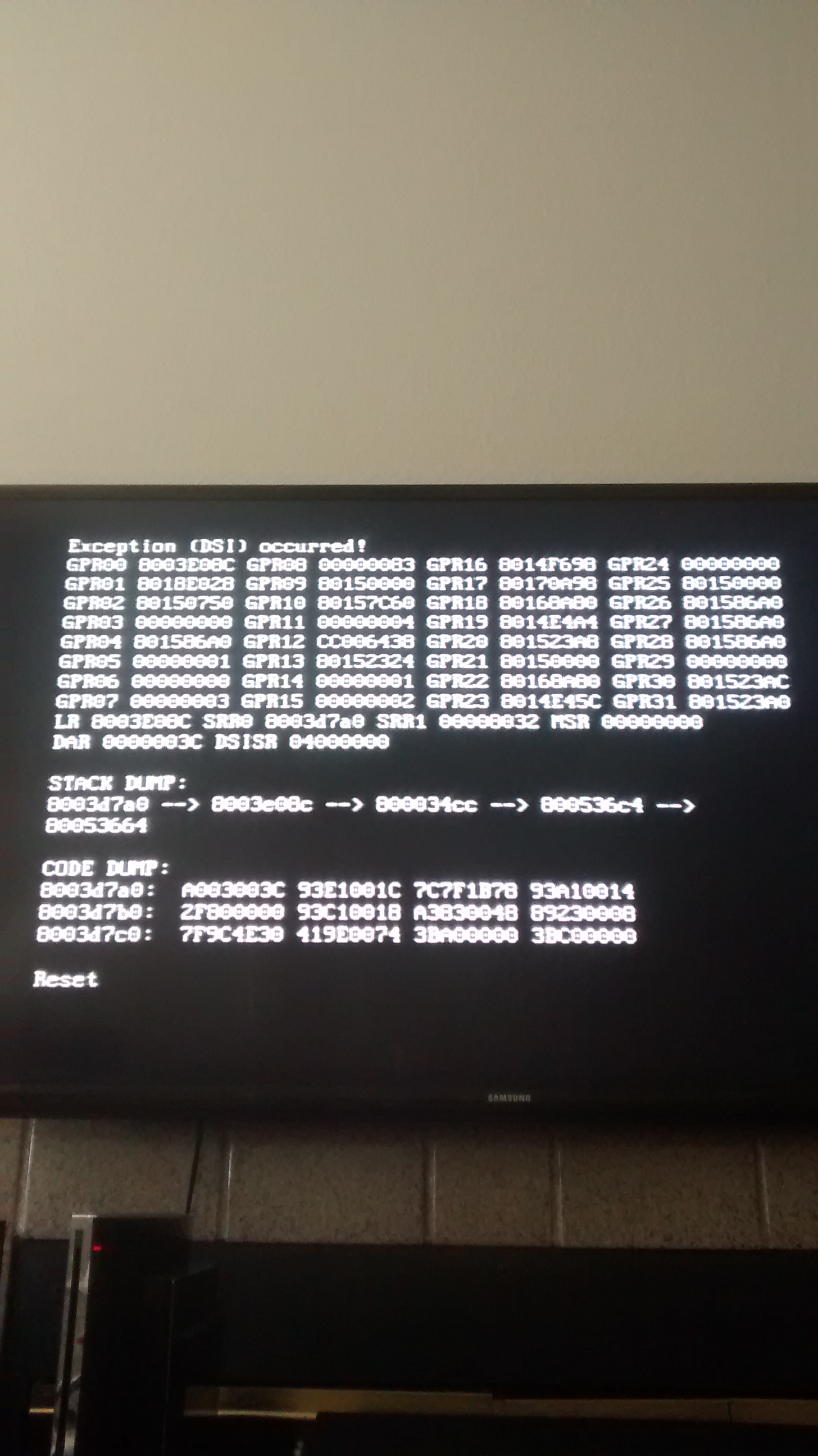

It was brand new. I have a xeno installed on the reader but that doesn't really do me too much good with the megadrive v3. I was dicking with it some more and if I press the "mounting..." Entry on the wkf it black screens and gives me a shitload of errors.

Re: Wasp fusion not mounting sd
You can remove the dvd drive and plug the wasp in once swiss has booted (yes with the gamecube on). It's relatively safe to do.
^^ exactly...hot swap
plug in your xeno modded drive and boot swiss..
then remove the DVD drive and plug in v3 with wasp...
make sure you have a fat32 formatted SD card in the wasp slot and try to read the contents of the SD card thru swiss
ive found that sometimes WASP do not always work properly with official firmware but once after loaded with swiss WASP has regained its functionality, sometimes.....
