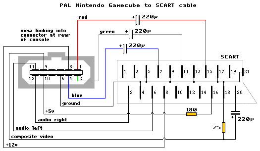

Hmm, thank you guys for answers. Still, may you please direct me to some how to how to modify the normal cable into RGB? I bought today the SCART plug so I can make my own with a help of a friend. Still, I have an composite one, and I always thought that it has too little pins on that side that goes into GC, but if it's somehow possible it's only better.
pr0ton
Posts: 186
Location: NL
Re: Kabel RGB Scart AV SNES / GameCube - is it good?
Post by pr0ton » Tue Feb 19, 2013 7:13 pm
Maybe someone will explain in detail, but you can't go wrong with this scheme:
wiring
(3 KiB) Not downloaded yet
With some care you can open the AV connector, and unplug the wires with a flat screwdriver. Then you can plug these in the other AV connector, and hopefully have enough wires (nine) to solder on the SCART plug.
The boards in the AV cable can be removed, maybe it has a 220u capacitor and 75ohm resistor you can use.
