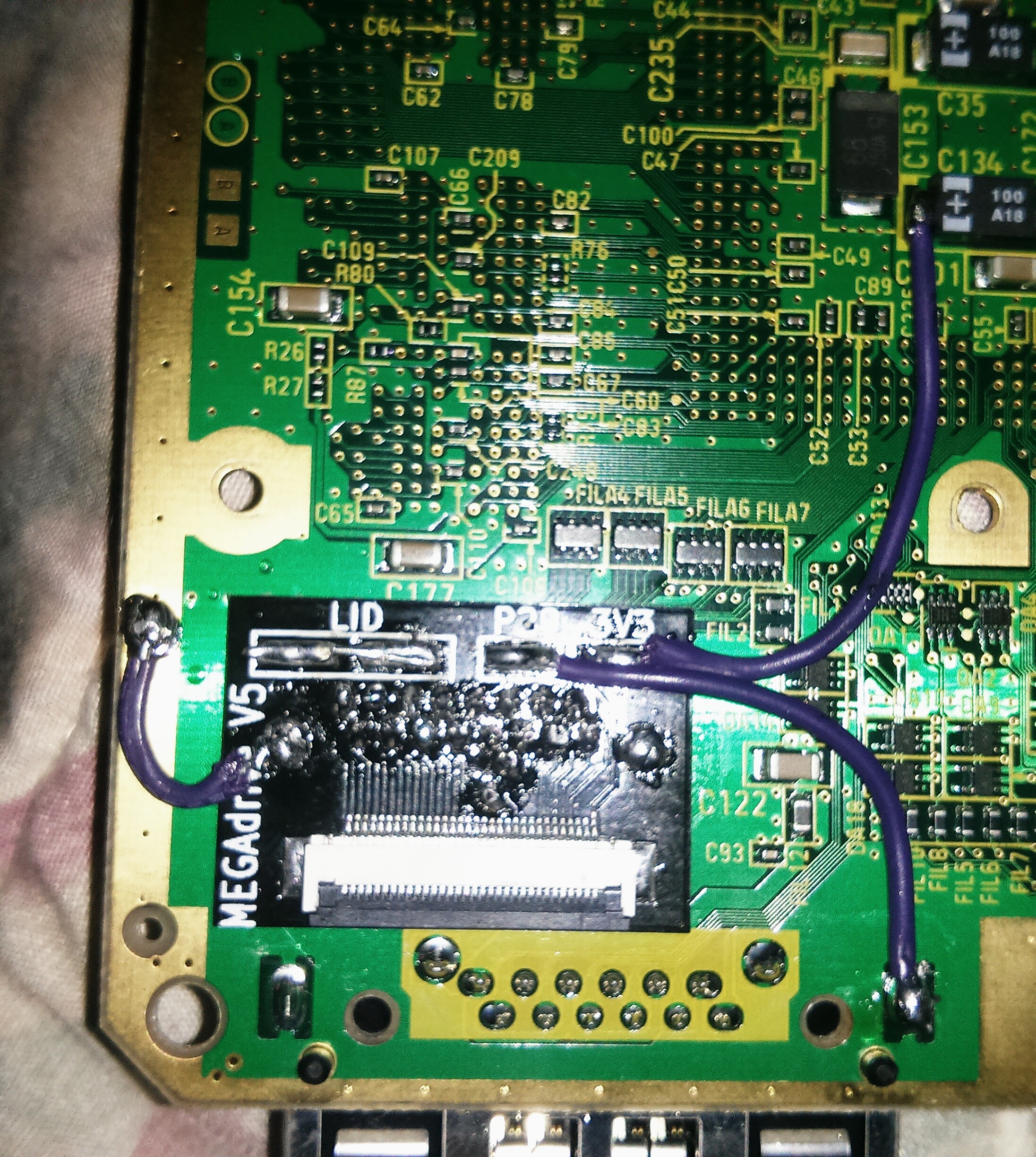

andre104623
Posts: 694
Re: WASP fusion stopped working after swiss update
Post by andre104623 » Thu Jul 10, 2014 1:24 am
megalomaniac wrote:do you know exactly which version of swiss you tried to load and did you load from the wasp slot or gecko slot also did you use the fzn only or both the fzn and fzn.fw when you flashed the firmware did you ever see the flashing complete message one time or two times after reboot the blue light flashes on and off or does it stay lit do you have a pin29 switch installed or did you jumper the two lid pads together you never did post a new clear pic of your install

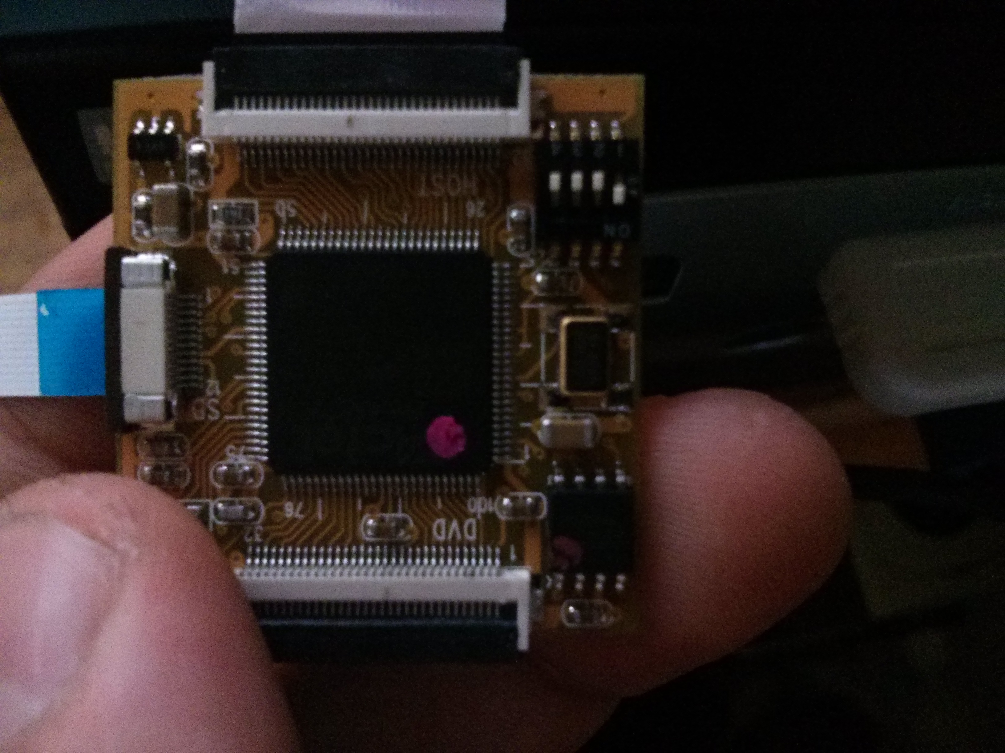

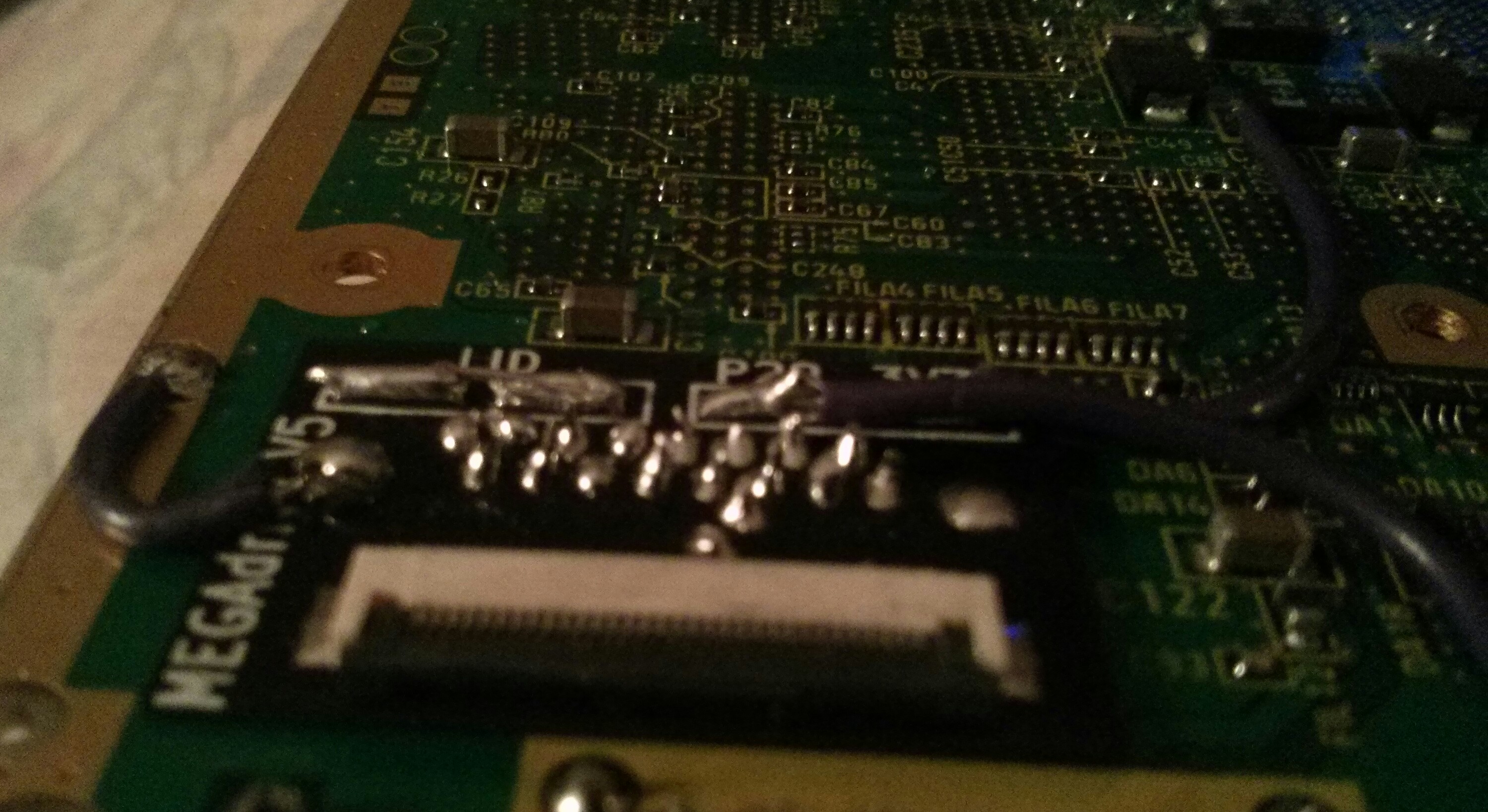

R268 I loaded the fzn from wasp menu popped up and said found firmware file because I put both file s in the root of the SD card lid is jumped and pin29 is grounded I tried the wasp on my Wii and used every guide I could find about recovery for wiikey fusion it just doesn't work at all the LEDs on the wasp light up like they are reading the SD card but the wii can't see a disc

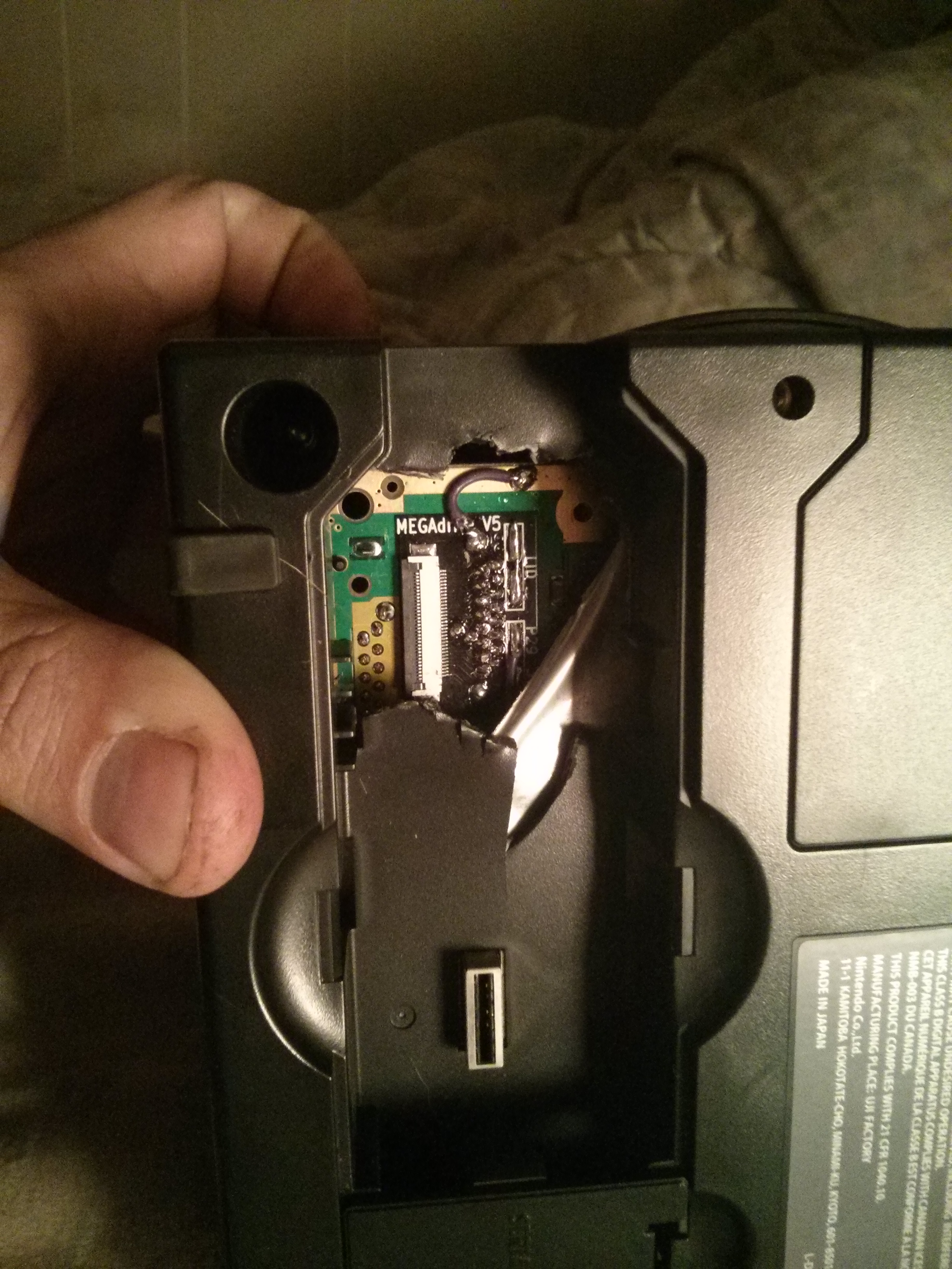

andre104623
Posts: 694
Post by andre104623 » Thu Jul 10, 2014 1:34 am
(1.76 MiB) Not downloaded yet
andre104623
Posts: 694
Post by andre104623 » Thu Jul 10, 2014 1:43 am
(2.5 MiB) Not downloaded yet
andre104623
Posts: 694
Post by andre104623 » Thu Jul 10, 2014 1:45 am
(2.37 MiB) Not downloaded yet
andre104623
Posts: 694
Post by andre104623 » Thu Jul 10, 2014 2:01 am

andre104623
Posts: 694
Post by andre104623 » Thu Jul 10, 2014 3:16 am
(1.34 MiB) Not downloaded yet
andre104623
Posts: 694
Post by andre104623 » Thu Jul 10, 2014 3:18 am
(1.95 MiB) Not downloaded yet
andre104623
Posts: 694
Post by andre104623 » Thu Jul 10, 2014 3:21 am
(1.98 MiB) Not downloaded yet

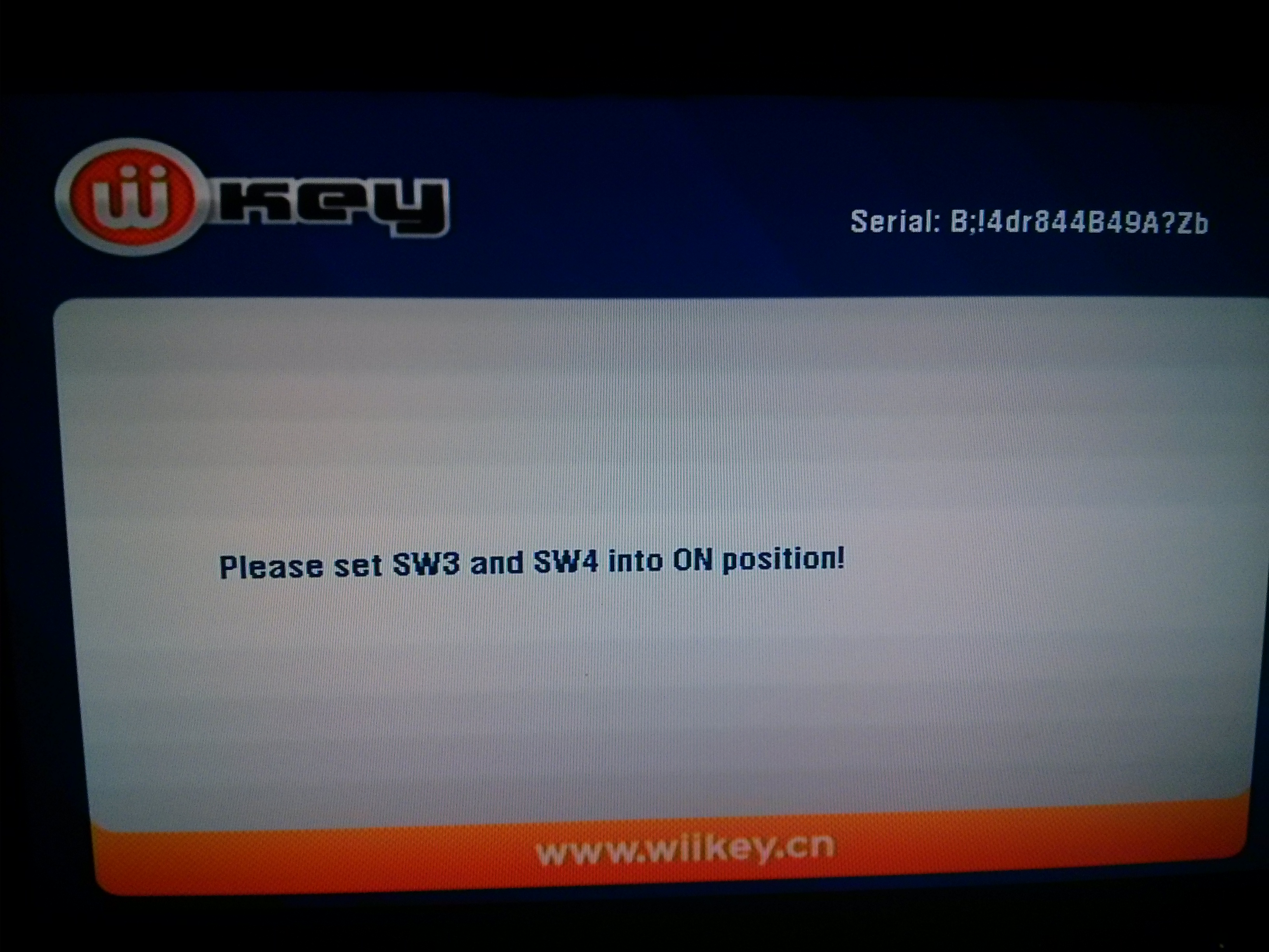

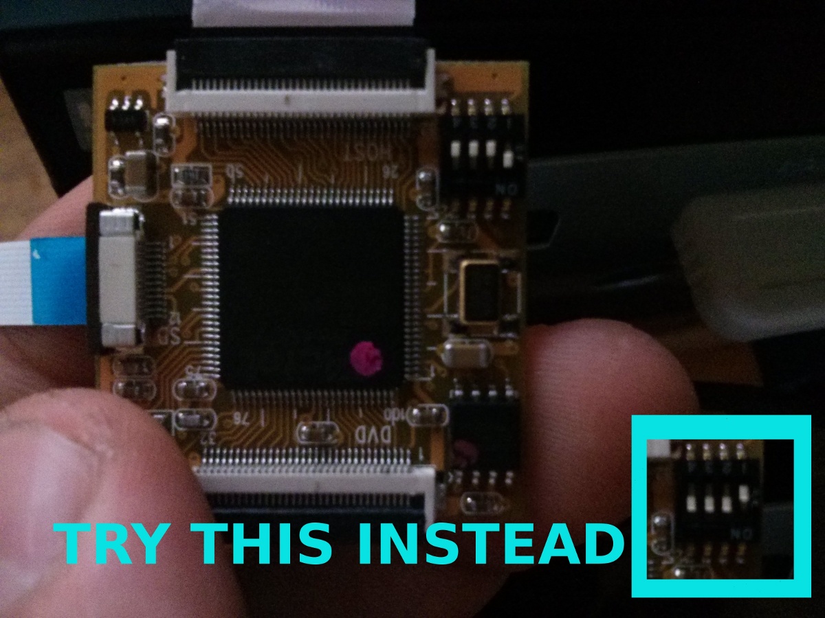

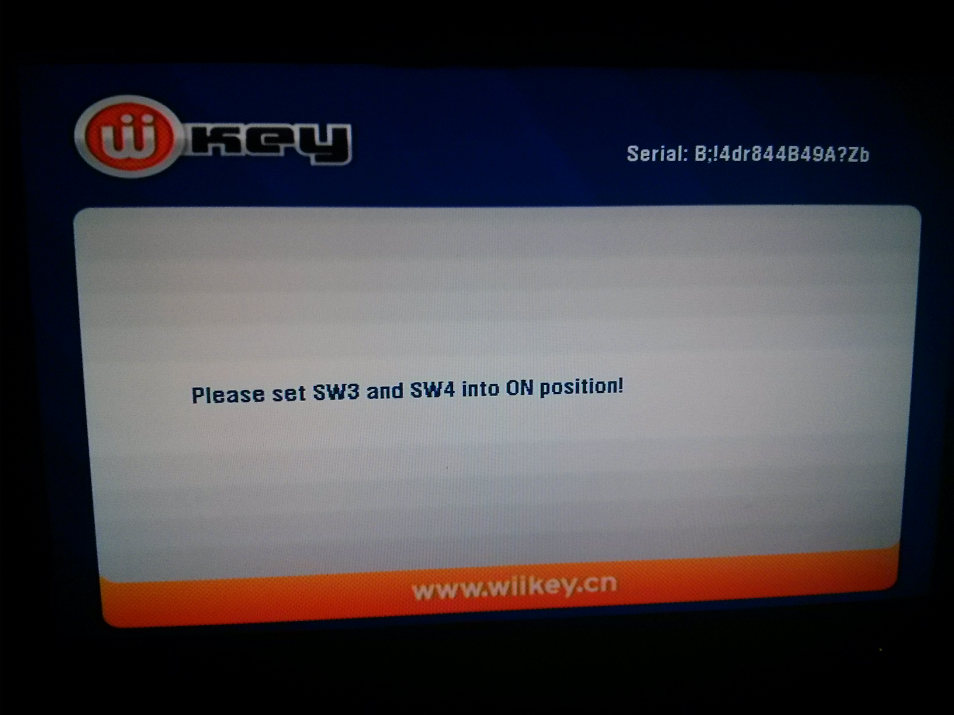

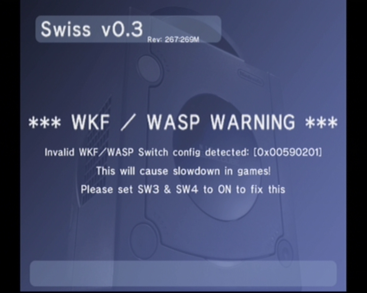

Post by megalomaniac » Thu Jul 10, 2014 3:38 am
(303.29 KiB) Not downloaded yet
tueidj
Posts: 564
Post by tueidj » Thu Jul 10, 2014 7:03 am
But that's not the ON position, that's the NO position!
noobcube
Posts: 134
Post by noobcube » Thu Jul 10, 2014 7:45 am
tueidj wrote:But that's not the ON position, that's the NO position!
Only down under.... ;)
Posts: 4972
Post by emu_kidid » Thu Jul 10, 2014 11:40 am
Implemented a check in r270 for incorrect switch config.
