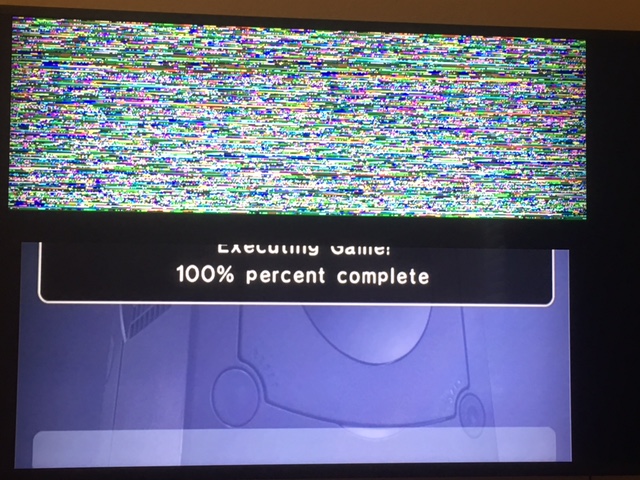

New to the gamecube mod community and I have a couple of weird issues. First I am running Gamecube with Xeno modchip booting off Swiss r401 disc running off SD card.
1) Every time I boot up the gamecube and launch Swiss my screen goes all messed up. I have attached what it looks like. The weird thing is I can get it to view properly if I turn the tv off/on or switch input back and forth. It seems to only happen when booting swiss because I can run backup or retail without experiencing the problem.

1) Does the Swiss menu still work after that? It sounds like your TV doesn't like video mode switching.

Yes the Swiss menu still works afterwards. I do have a short delay before I can navigate the menu but then it's fine.

So I found out I was able to fix the messed up screen issue by changing the Swiss video mode from Auto to 480i. Now it boots into Swiss without any issues.
For anyone else who has this problem I probably should've also mentioned this has an HDMI mod and connected to a Vizio M55-D0.
