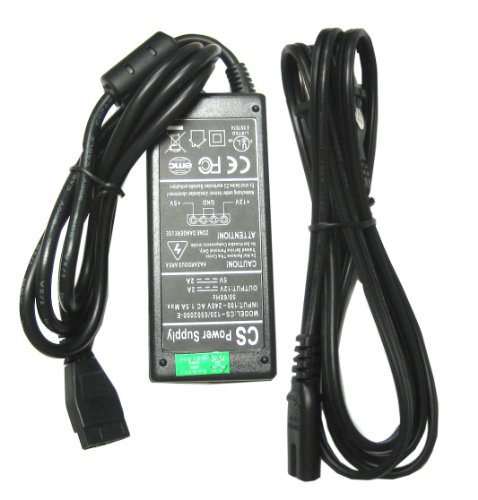

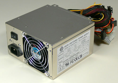

kevstah2004
Posts: 308
Location: UK, Hull
Re: Power Source
Post by kevstah2004 » Fri Feb 11, 2011 6:50 pm
There different
(35.53 KiB) Not downloaded yet
(35.34 KiB) Not downloaded yet

i am using the second picture. my friend uses the first picture

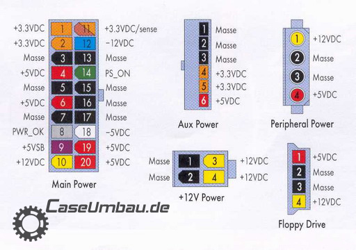

yamaharacer wrote:you only need to bridge pin 15 and pin 14 on the atx connector then the power supply starts without a mainboard ;-)
yamaharacer
Posts: 448
Re: Power Source
Post by yamaharacer » Sat Feb 12, 2011 5:16 pm
the pin is called PS_ON (power supply on) :roll:
(114.69 KiB) Not downloaded yet
tglaria
Posts: 62
Re: Power Source
Post by tglaria » Sat Feb 12, 2011 5:52 pm
yamaharacer wrote:http://www.caseumbau.de/test252/atx_belegung.jpg
I've tried this and works.

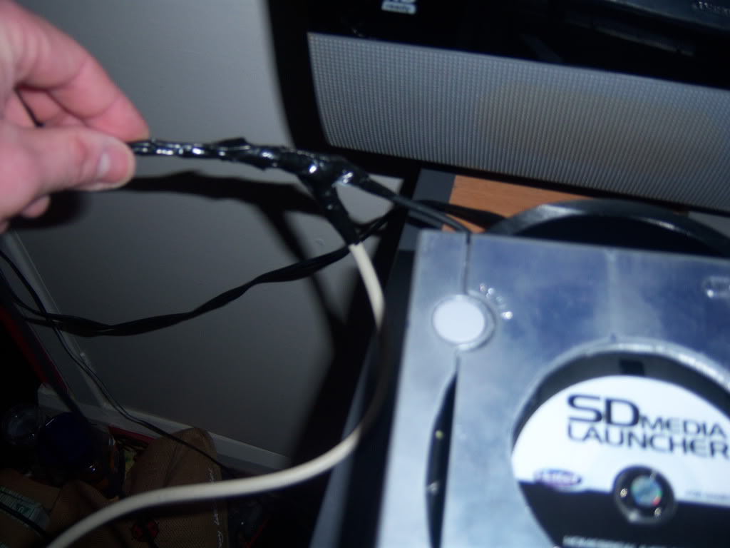

Post by Jaecus » Sat Mar 12, 2011 9:35 pm
I recently purchased this:
12V DC 4-Pin Molex External Power Supply Adapter
http://cgi.ebay.co.uk/ws/eBayISAPI.dll? ... 0566955679
I want to warn you that the one i recieved worked for 5minutes and then something inside went bang. :evil:
The device had severely overheated and I am assuming that a component reaching cooking point was the bang i heard.
It may be that I was unlucky, and these items are normally fine?
I thought its best to mention it anyway as I for one will avoid this specific adapter in the future.
cissou
Posts: 12
Joined: Mon Feb 07, 2011 6:36 pm
Location: France
Re: Power Source
Post by cissou » Sun Mar 13, 2011 8:54 am
I use an old ide hdd case usb, which the usb part doesn't work anymore.
Jaecus
Posts: 77
Location: England
Re: Power Source
Post by Jaecus » Fri Mar 18, 2011 2:02 pm

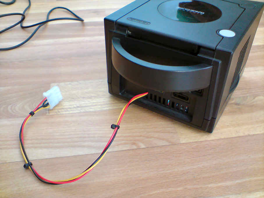

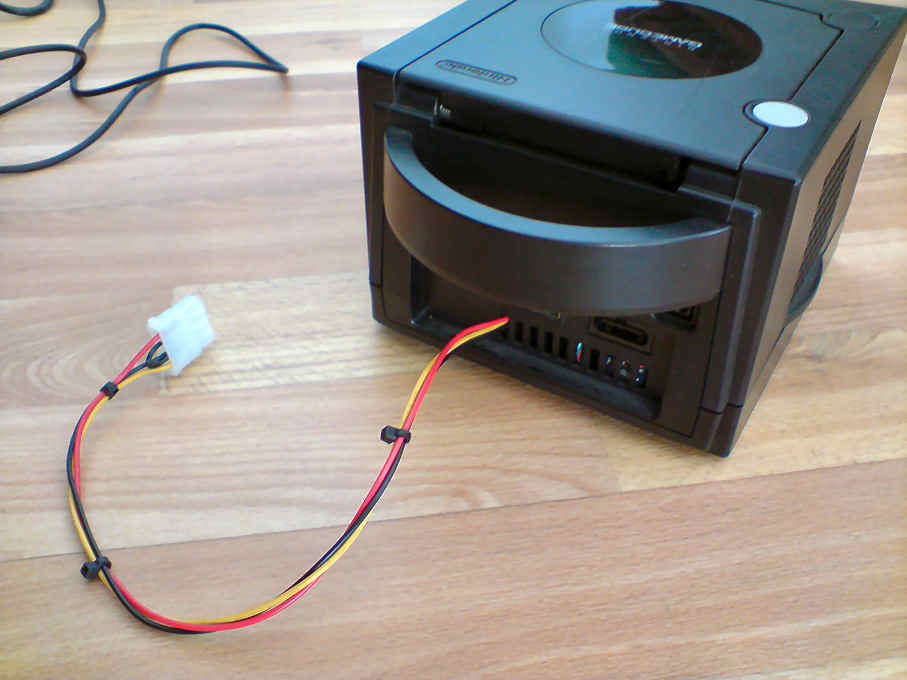

Having had the power supply blow up on me, I decided that I would do away with the old PC PSU (too big and noisy fan!)
I made a power supply mod for the Molex HDD supply
I took 12v from the power cable
I took 5v from the memorycard EXI pin6
and added a switch to power off HDD
Its working very well and not having cloudy problems
(65.18 KiB) Not downloaded yet
(83.9 KiB) Not downloaded yet

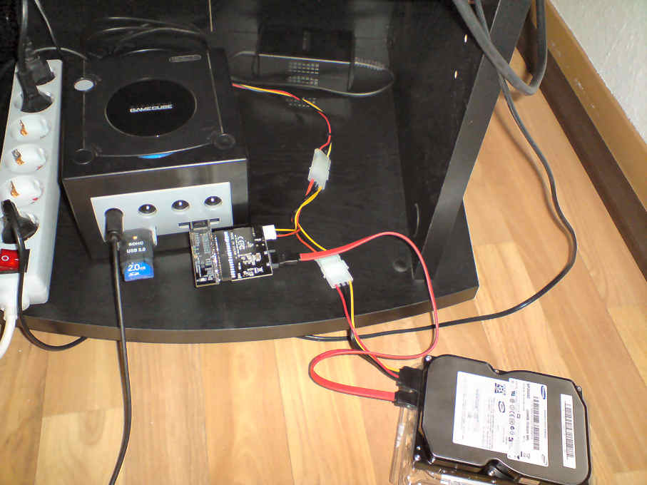

Post by rs5001 » Sun Apr 03, 2011 11:52 am

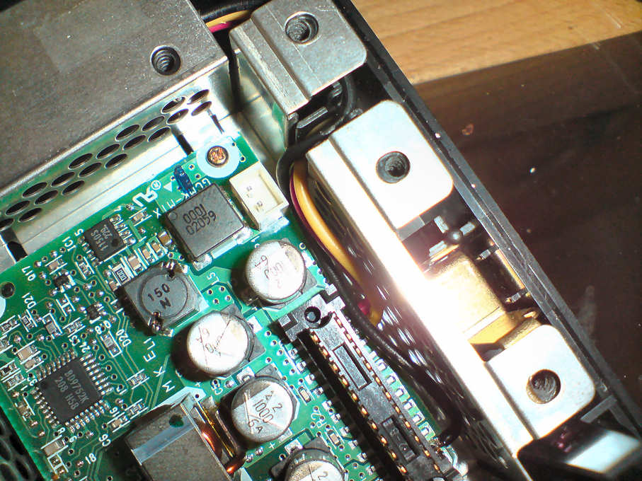

Hey guys,
inspired by Jaecus i also build a power source for the hardisk.
I think its the best solution and its very easy to make.
I soldered it directly to the power board.
(55.59 KiB) Not downloaded yet
(46.58 KiB) Not downloaded yet
(123.31 KiB) Not downloaded yet
Posts: 1814
Re: Power Source
Post by liquitt » Mon Apr 04, 2011 6:35 am
nice, looks clean and tidy :)
