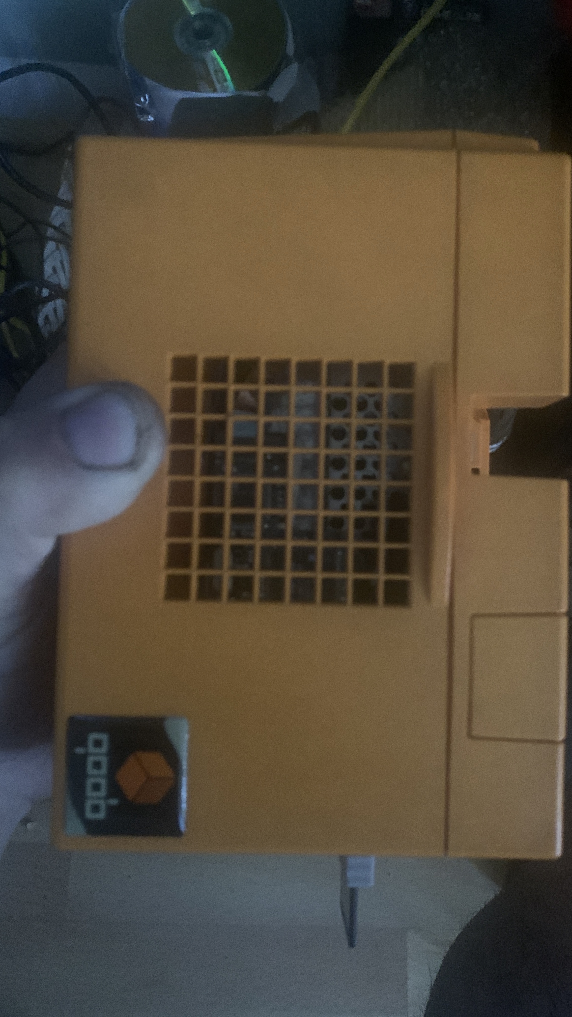

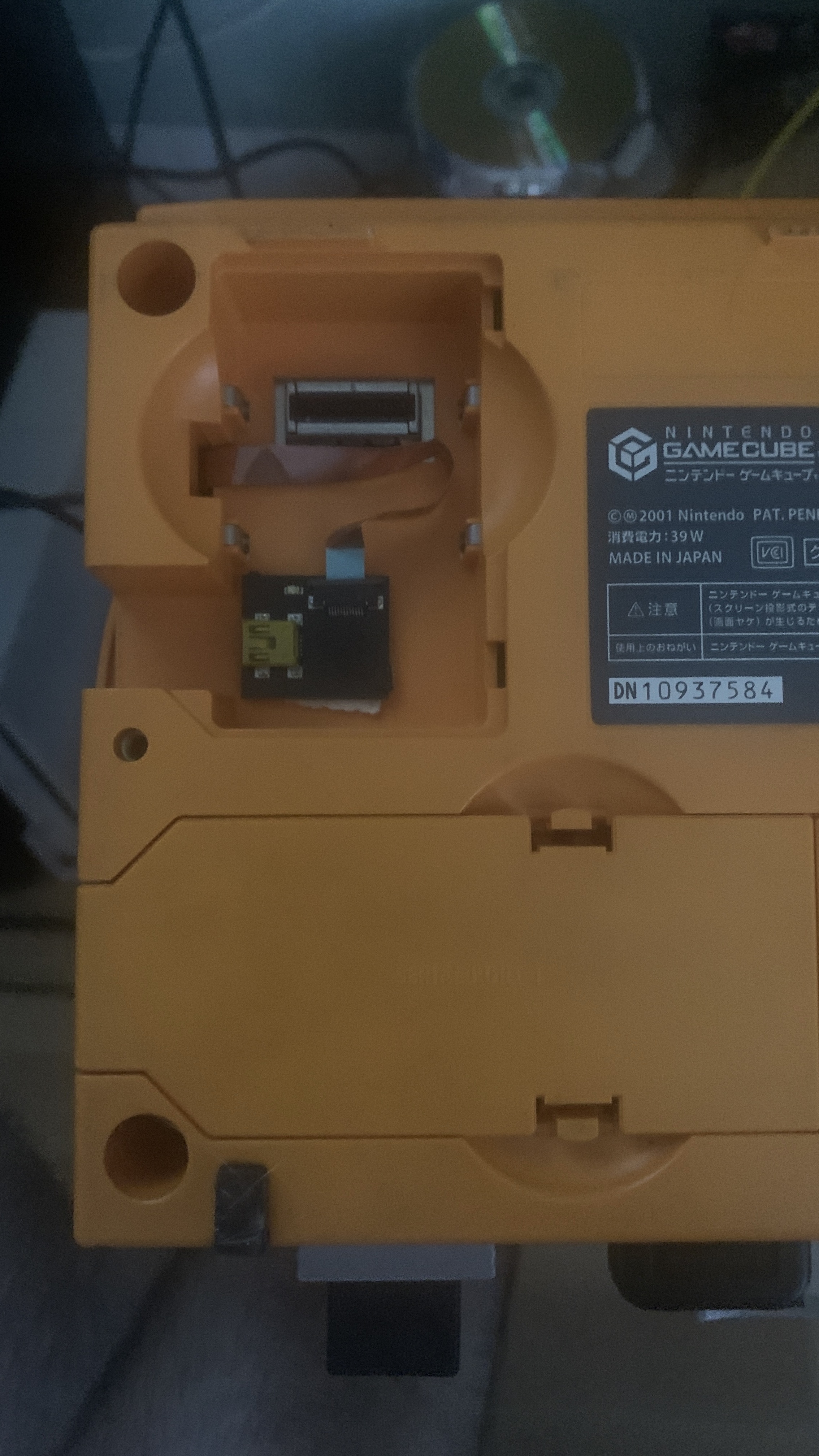

No there is a small breakout board on the bottom of the cube at lease that’s where it should have been installed

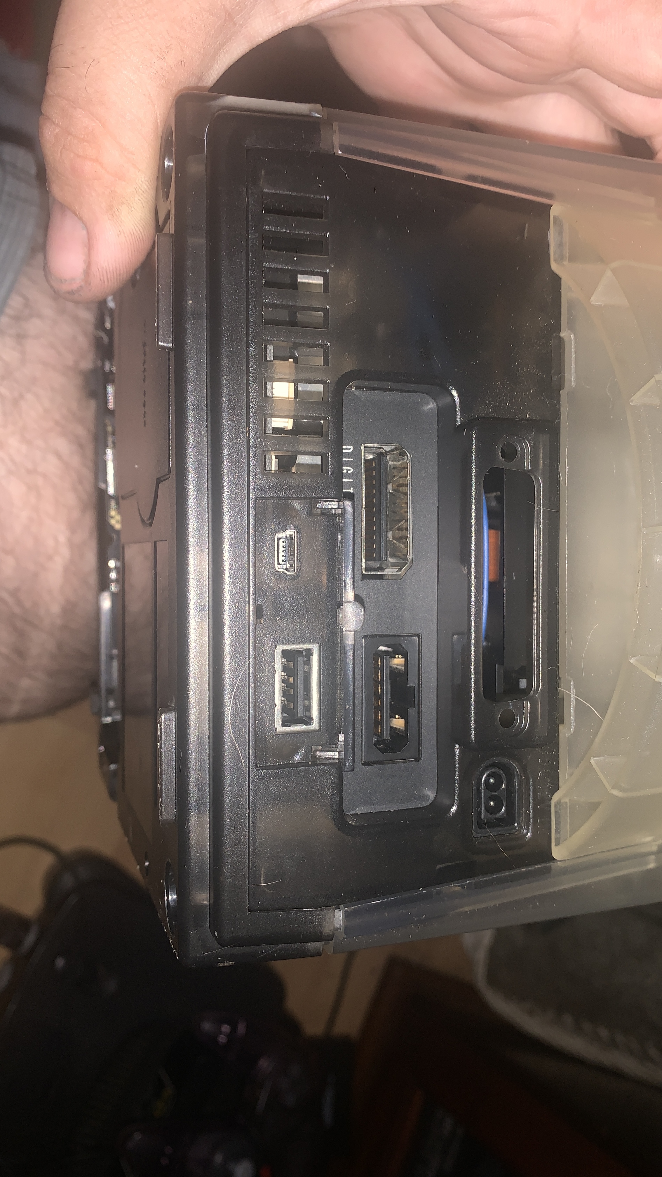

If these is the USB ports your talking about which is part of the viper gc case then no it won’t work as far as I can tell you I’ve never used them because I have a viper programmer so I never saw the point of them since well it’s a viper gc case not a qoob case and also the plug is different then the viper extreme so I figured it was for the viper 1st gen since I never seen one

If you link the USB port on the Qoob Pro to a PC (even Windows 10) while the GameCube is off you can run the Qoob Flashing Software 1.3 here:
https://www.gc-forever.com/forums/viewt ... ?f=36&t=23
The Qoob chip will be powered via USB and you should see an LED lit on the main Qoob board in the case, and also a separate LED on the breakout mini board with the mini USB socket on, if it's working properly. I have found that occasionally I need to re-seat the flex cable in the connectors to get it working.
Don't overwrite the Qoob BIOS, but instead write the swiss compressed DOL to the spare blocks on the Qoob Pro. It can glitch out and say Not Responding while it's writing but if you wait a few minutes it should complete and return to being responsive.
