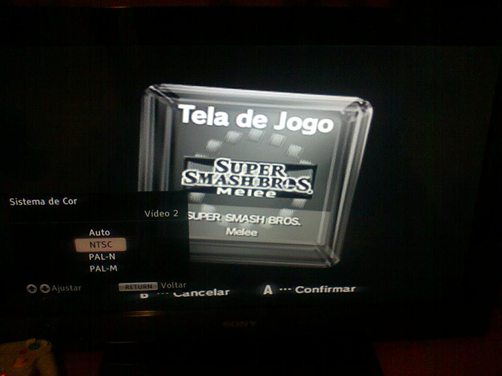

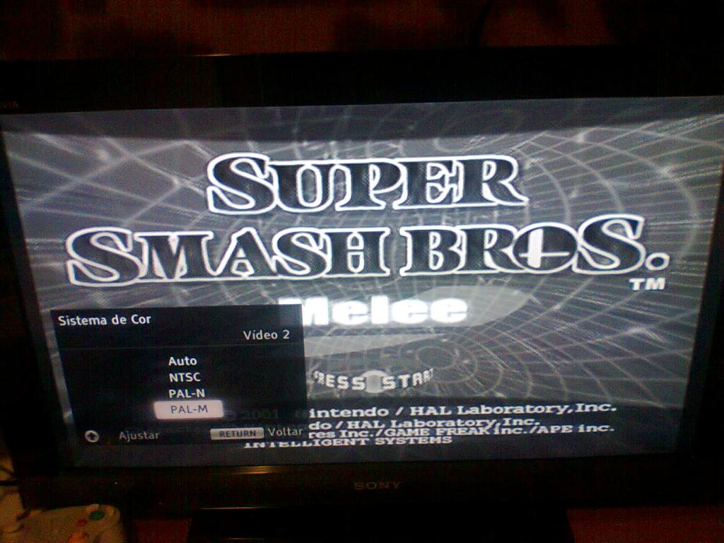

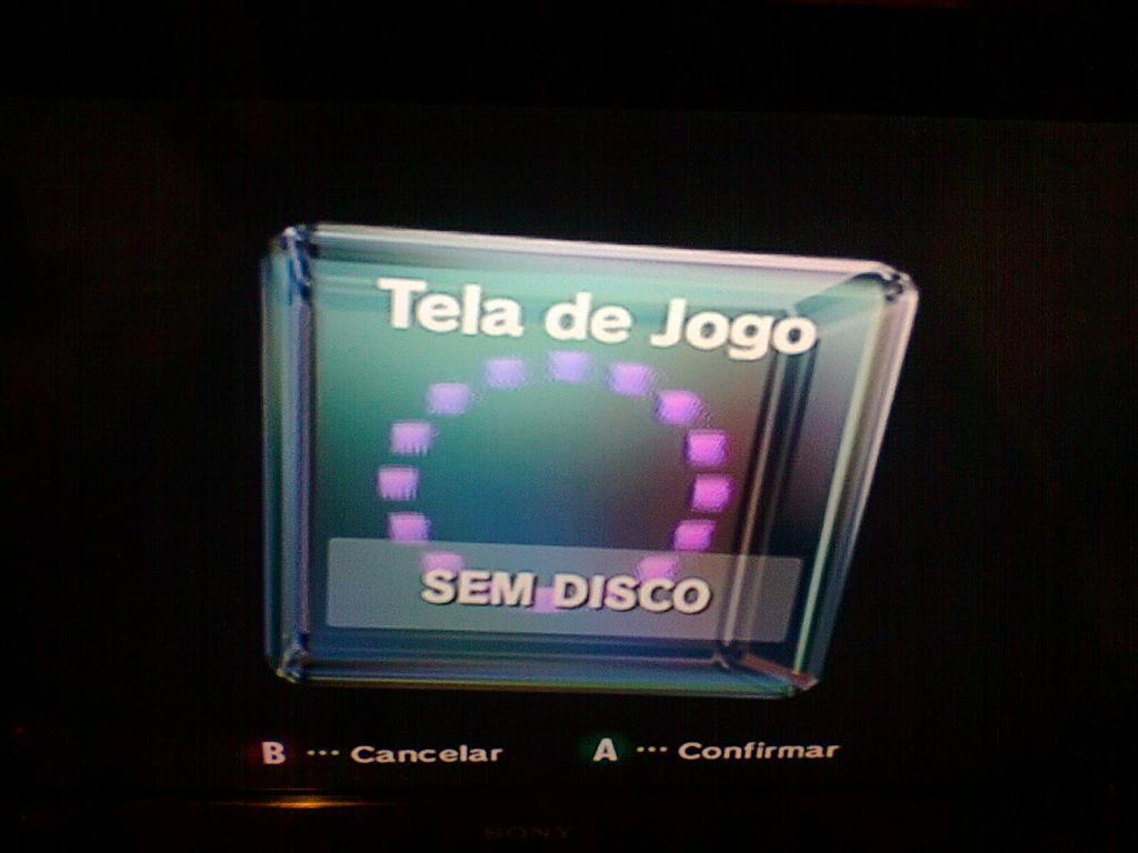

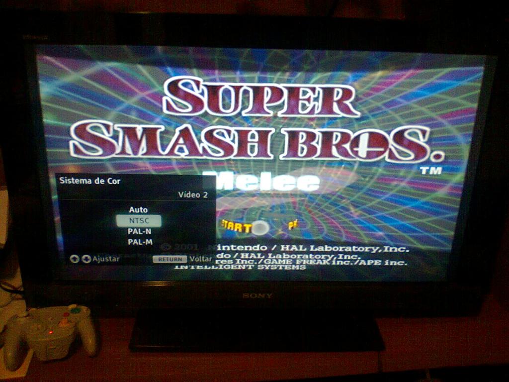

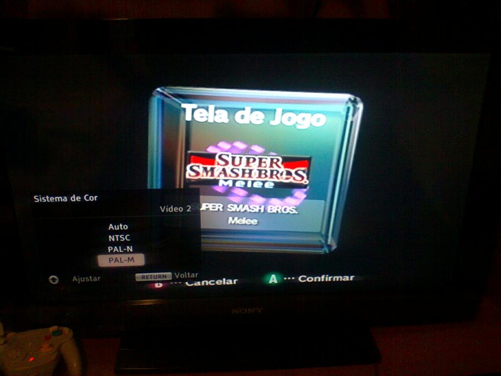

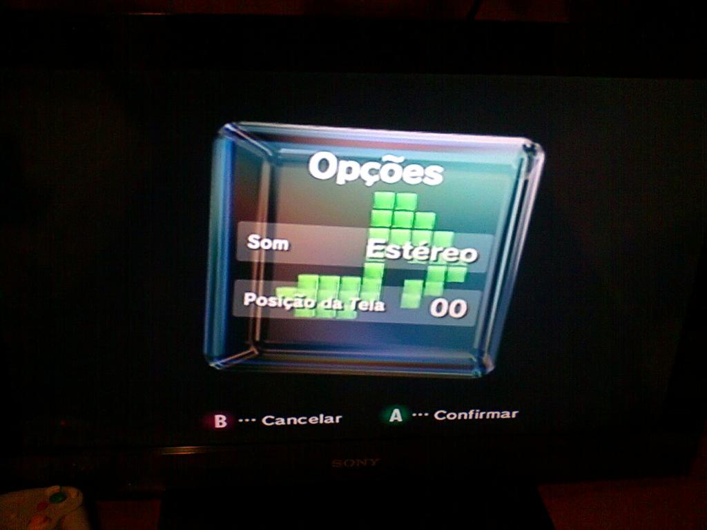

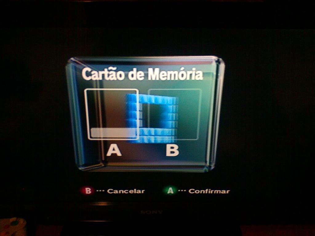

Well, it seems my console is the so called "very special" version with "Portuguese menus and co-produced by Nintendo and Gradiente".
In my unit, all the menus are in Portuguese. (yep, only noticed now lol, this is the first time in years since I've used this console)
Here are some pics of the menu:
Now to show proof that it actually changes the video mode by itself, here are some pics of it with the TV's color system selection menu:
PAL-M:
NTSC:
Now let's play a NTSC copy of Smash Bros:
PAL-M:
NTSC:

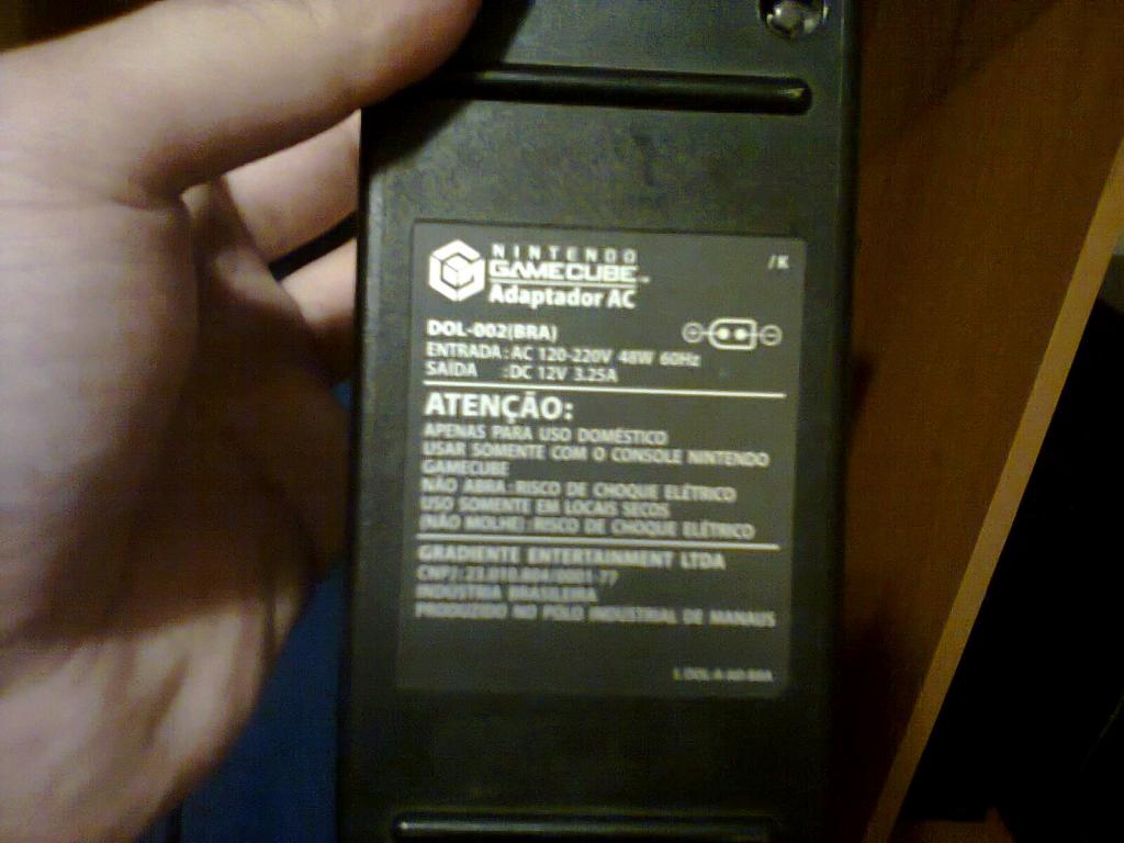

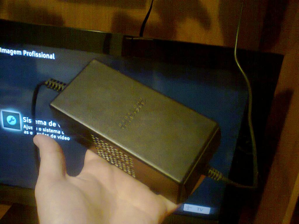

Here's the power brick of this unit:
It's about twice the size of the american one.
The reason:
It's actually a 110-220V auto-switching power supply.
Brazil has both 110V and 220V voltages as standards depending on the region you are, so it's common to see this kind of multi voltage PSU.
In fact, the Nintendo 64 PSU is bigger here too, and for this exact same reason: It's 110-220V auto-switching too. =P

Post by Sugurain » Fri Jan 02, 2015 1:18 pm
Tested Luigi's mansion on it, PAL version.
My TV couldn't auto detect what video format it is. It's behaving like Swiss in the beggining (before I changed video mode to 480i).
The "Auto" option in my TV gives me a blinking a black and white picture.
PAL-N gives me a full, clean, black and white picture.
NTSC gives me a clean black and white picture with the bottom missing.
And PAL-M gives me color picture, but with the bottom of the image missing.
Then, I reseted the console and ran Luigi's Mansion again, this time forcing video mode to 480i in Swiss.
My TV auto detected the output video as NTSC.
The image has color, is clean, and the bottom of the image is there.
I belive it was indeed trying to make a pure PAL image on the first try. Otherwise my TV would detect the signal as NTSC ou PAL-M.

Post by theclaw » Fri Jan 02, 2015 2:24 pm
A pure PAL image would be essentially the same as a European GC, and auto detected by the TV.
PAL-M is intended only for 60hz. Not detected at 50hz is logical.
