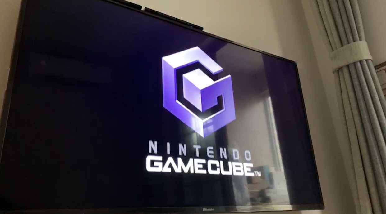

The TV showed black screen when the WASP Fusion was loading "swiss_r650(ntsc-j).iso", and then, If I change the image to "swiss_r650_Recovery.iso" of SD Card,the screen wiil show the attachment. I couldn't see the SWISS menu at next step.

My operation is, 1. Insert the SD card of swiss_r650_Recovery written in DD into the WKF card slot, 2. Open NGC When the picture above appears, insert the SD card with SWISS.ISO WBFS.

I'm not too familiar with it as I've never had to do it but there are threads on this forum where it has been detailed many years ago, have a search to find one such thread. I believe the recovery ISO when written raw is meant to boot up to the original WBFS Wiikey Fusion menu after a reboot. The steps you detail after seem correct to me.
