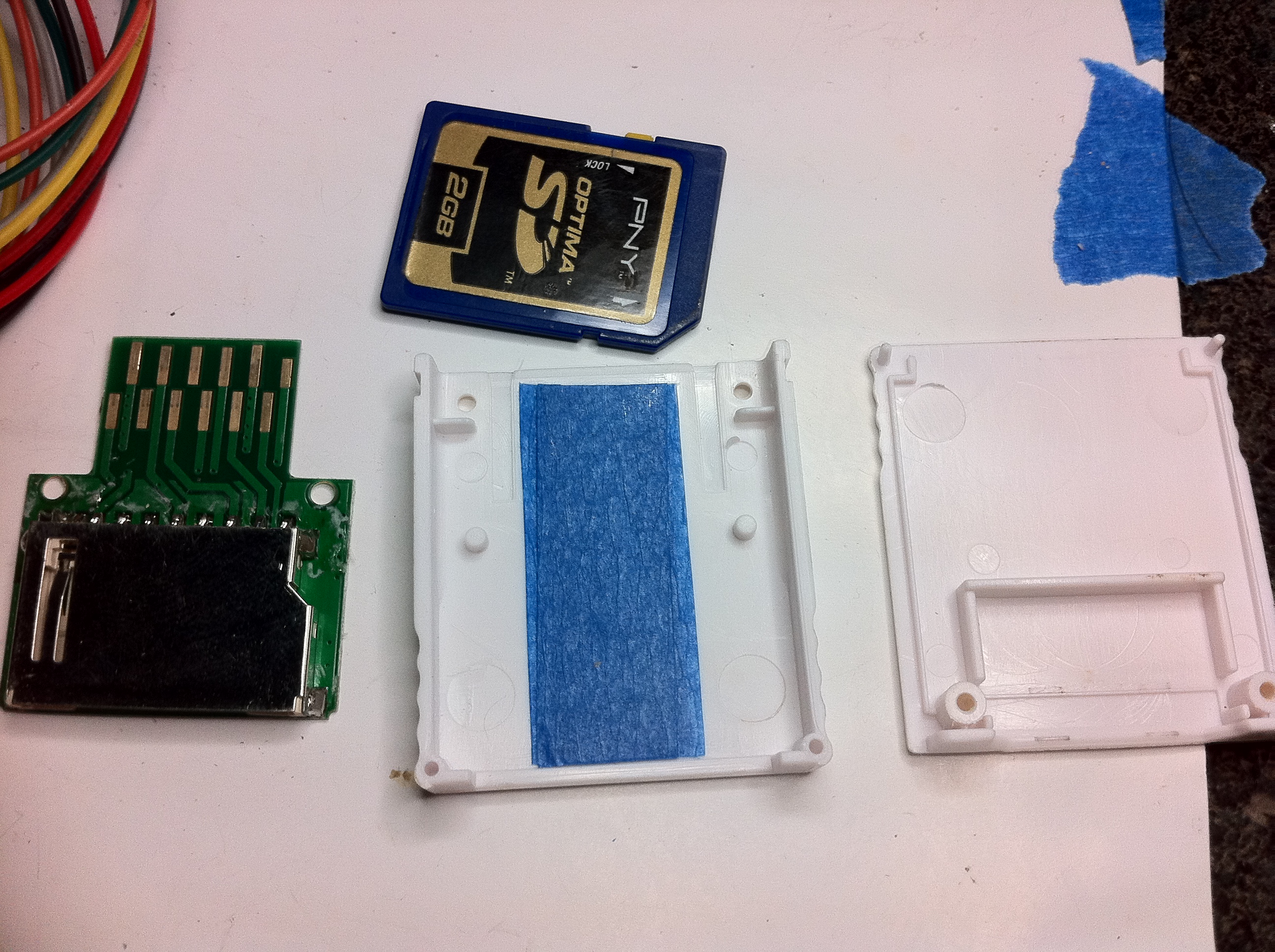

Re: Swiss 0.2
Post by emu_kidid » Mon Jan 09, 2012 8:22 am
they're all the same. maybe 32mhz works better if there is better conductivity between the pins and the slot, I'm not entirely sure. I've used cheap-ass dealextreme adapters and they work fine (apart from the fact that if you bump the card it's over cause it moves out of alignment) - but only on some.

Re: Swiss 0.2
Post by emu_kidid » Mon Jan 09, 2012 10:24 pm
yes, most do, I've had a few though where you touch the card and it loses connection with the contacts (slot is too side and the SD card has room to move).
Posts: 1814
Re: Swiss 0.2
Post by liquitt » Mon Jan 09, 2012 10:49 pm
emu_kidid wrote:yes, most do, I've had a few though where you touch the card and it loses connection with the contacts (slot is too side and the SD card has room to move).
yep i second that, i have one of these too...but normally you don't touch the sd card while using it, so it's all good. otherwise if you by accident dodge it.. :?
Re: Swiss 0.2
Post by emu_kidid » Tue Jan 10, 2012 12:08 am
I accidentally touch it cause my controller cord hangs down as I play close to the Gamecube, or if I'm using it on my portable, same thing again though, controller cable.
Posts: 1814
Re: Swiss 0.2
Post by liquitt » Tue Jan 10, 2012 3:22 am
emu_kidid wrote:I accidentally touch it cause my controller cord hangs down as I play close to the Gamecube, or if I'm using it on my portable, same thing again though, controller cable.
yeah i can see that, i have one of my cubes on my desks so i'm close to it with my computer mouse :)
Re: Swiss 0.2
Post by megalomaniac » Tue Jan 10, 2012 3:39 am
tape is your friend...
a few layers inside bottom of SD housing will help the connections get nice and snug.
no more issues
(1.96 MiB) Not downloaded yet
