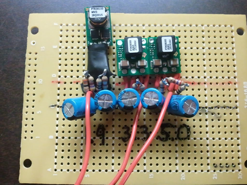

While I'm waiting for my wiikey to arrive, I figured I'd start looking for batteries and start planning out the rest of the portable.
I'm looking at these batteries right now: http://www.batteryspace.com/Polymer-Li- ... h-PCB.aspx with this charger: http://www.batteryspace.com/smartcharge ... isted.aspx
If you can't see them, they are 7.4V and 5A. (how does that look in terms of battery life? Should I go higher?) Now I know this means I will have to make custom regulators to get the 1.9, 3.3, and 5V lines that the Gamecube needs (I'll just use the 7.4 on the 12V line).
My question is, if I want to use SS's diagram for wiring up the charge and play, could I input the 12V from the wall adapter into the custom regs for my 7.4V batteries? Or would I have to get that down a bit first? Sorry, all of this regulator business is confusing me, especially because I should have gone to bed 3 hours ago. :?
As always, help appreciated!

Post by hailrazer » Tue Jan 15, 2013 1:20 am
Those batteries are fine but huge.
Follow my guide here:
http://www.made-by-bacteria.com/forum/v ... ?f=59&t=39
Use the part of the guide for 7.4v. And use the 5000mAh batteries in the guide. They are much smaller.
You will basically get around 2 hours of playtime with 5000mAh batteries.
Yes you can use 12v into the regulators without changing any values..
Make sure the 12v is at least around 3A.

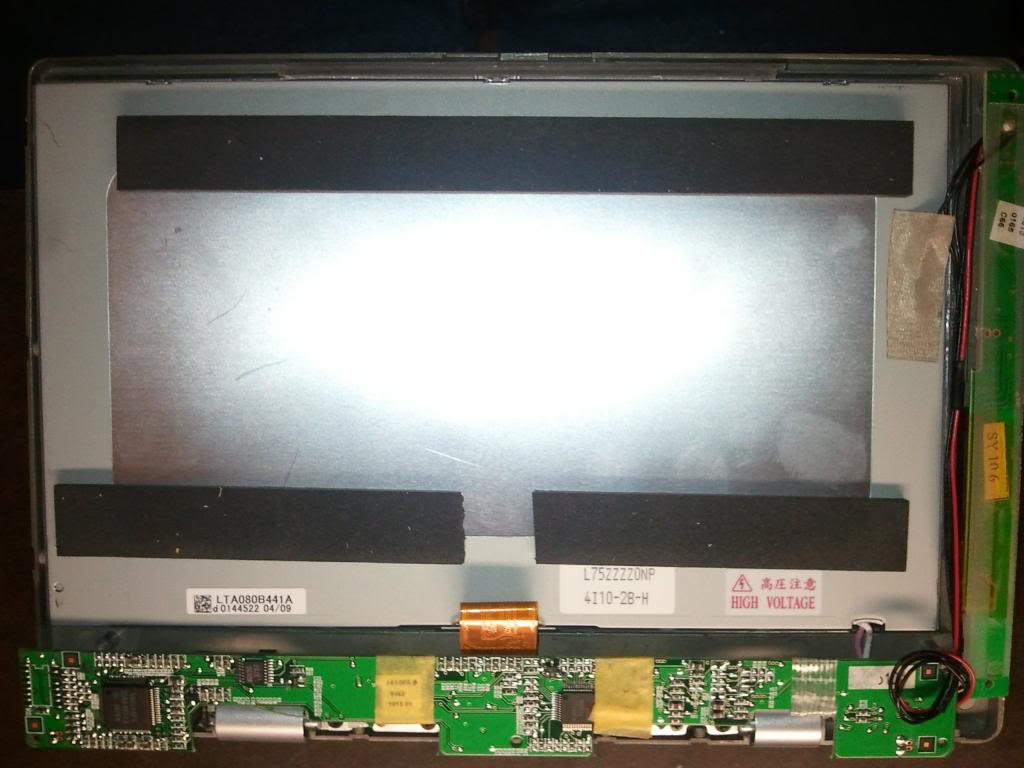

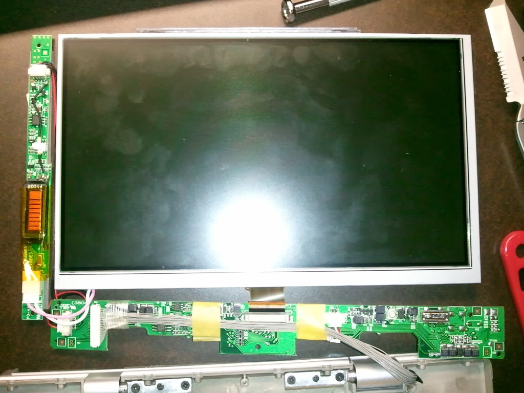

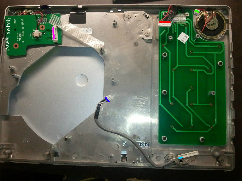

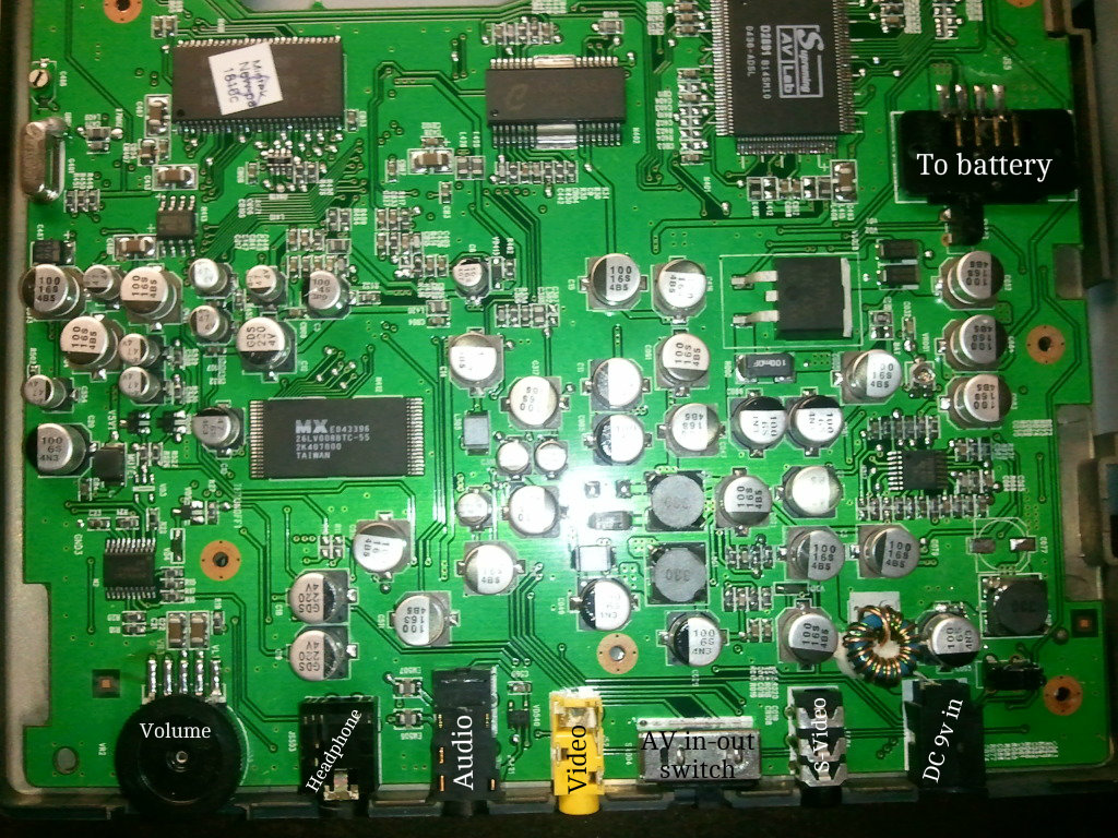

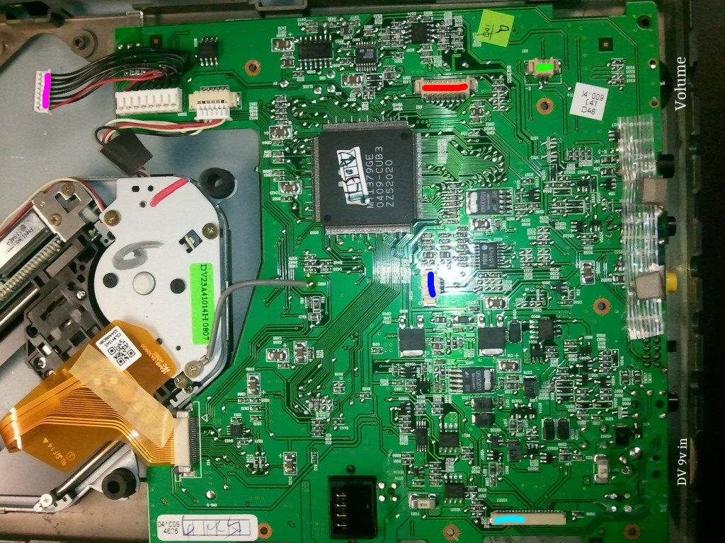

In the mean time, I have something I was hoping someone could help with. I have a portable DVD player that accepts AV in so I was planning on using that screen (and case) if possible. However, I can't figure out where I'd input it too the screen or even if I'd be able to. Figure it might be converted on the main board somewhere. If someone could perform some trace following magic, that'd be awesome.
Here are the pics
Top of the main board
Bottom of the main board
Bottom of the faceplate for the Dvd player. This sits on top of the main board and has all the buttons connected to it
Front of the LCD screen
Back of the screen
Any help with this would be great as I'd like to continue working on this. Still waiting for my wiikey and batteries to get here though :/

Re: Starting a new project, WORKLOG
Post by emu_kidid » Thu Jan 24, 2013 5:12 am
looks like the same portable dvd player I used in this: viewtopic.php?f=26&t=631
Post by Ashen » Thu Jan 24, 2013 6:23 am
Unless the portable DVD player has an AV input jack, then you're probably SOL. Even if it does, you'll likely need to keep that huge motherboard that goes along with it. Not usually a recommended solution. But if it has AV in you could use it.

Post by Fraks » Thu Jan 24, 2013 8:13 pm
@emu_kidid I don't think it's the same one, although they might be similar which gives me hope. This is the one I'm using http://www.amazon.com/Mintek-MDP-1810-8 ... B000087QPQ
How did you connect yours? It wasn't really clear from your thread.
@Ashen yeah I was thinking the same thing. I was worried that there might be some conversion taking place on the main board which would make this pretty much impossible for me. But it does have an AV in jack so hopefully...
I guess I'll have to tinker with it some more
Post by emu_kidid » Thu Jan 24, 2013 10:12 pm
mine had AV Input, so I connected it to that. I had to put the entire screen/DVD board in, but switched to "Input" mode permanently and hardwired the inputs. I'd highly recommend a 5" reverse camera LCD instead, they're very tiny in form factor and make for a great portable screen.

Update: Got the regs wired up the other night.
My parents got my batteries and wiikey to me today as I'm dorming at school. I'm going to start soldering wires to the wiikey FFC pretty soon. Ill keep you all updated

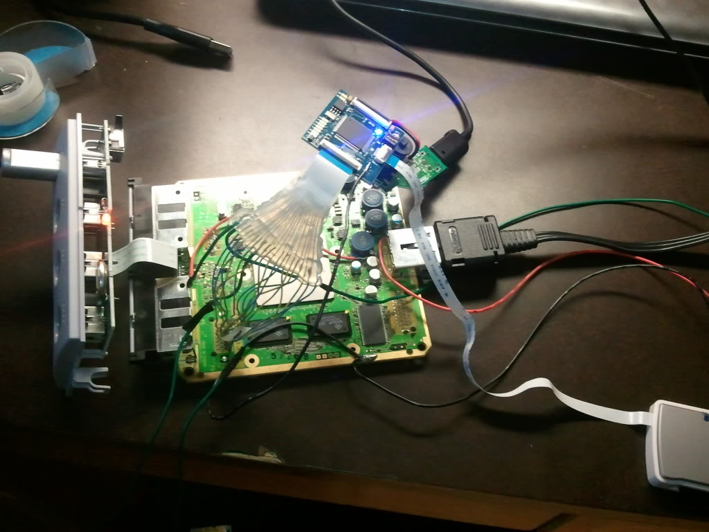

Post by Fraks » Fri Feb 08, 2013 12:34 am

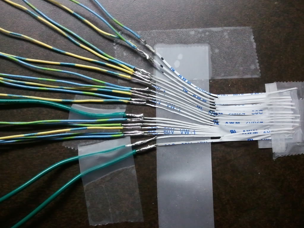

Alright, after three or four tries over two days I finally got the jumper wires soldered to the wiikey FCC. I'll tell ya, it's a lot harder to solder to those tiny traces than I would have thought.
I had to keep cutting the fcc back and starting again. :lol:
I ended up splitting the traces further down so I'd have a little more wiggle room. All of the traces that are bent back are for ground or just unused. I think I'm going to pick up the switch for pin 29 later on tonight so hopefully I'll finish wiring up the Wiikey tomorrow
Post by megalomaniac » Fri Feb 08, 2013 1:01 am
nice job...
also, just to add, all those GND lines can be combined into one single line then soldered to a single GND point on the GC mobo...

Even better news! Just checked and all my traces have continuity!
@megalomaniac I was going to scratch off and connect a wire to the wiikey itself and connect that to gamecube ground. Figure that would be much easier than connecting each of those traces to each other or to ground separately.

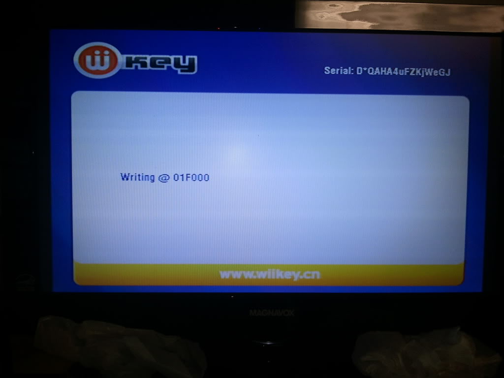

Post by Fraks » Fri Feb 15, 2013 10:58 pm

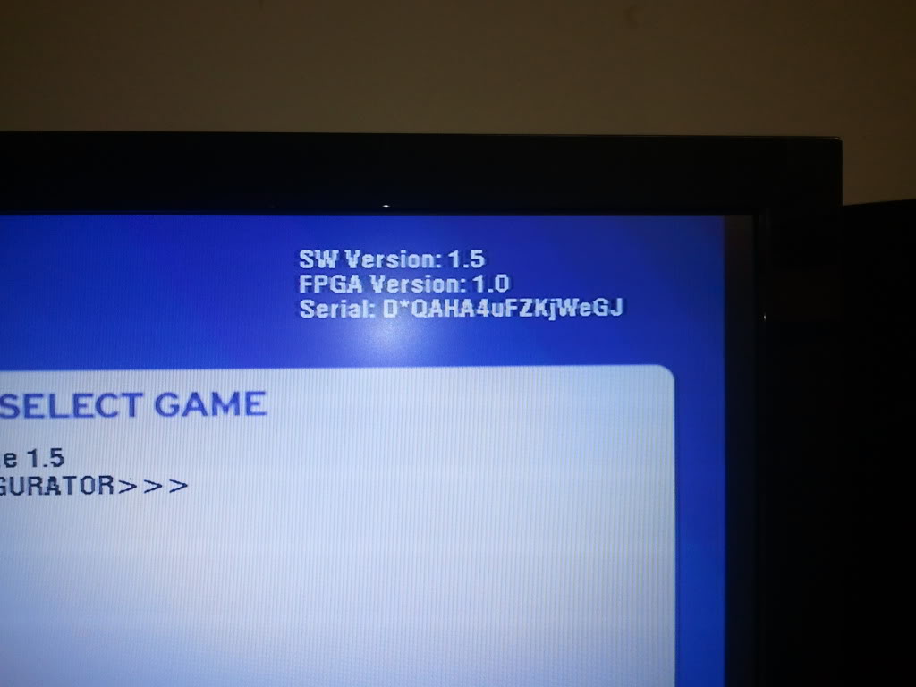

Ok so I finally got around to testing out the wiikey and....
Success!
Here is my set up at the moment:
And here is just showing that it finished the update to 1.5
Haven't put swiss on it yet, but I may wait and do that at a later time. I don't want the gc to get too hot as I don't have heatsinks or anything on it yet obviously. I think the next thing I will do is sort out the power situation (batteries, the charge and play circuit, and get the regs hooked up to the cube).

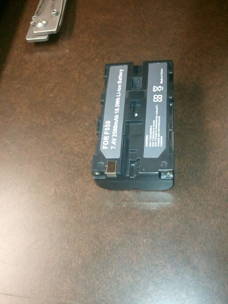

Edit: Quick question: Here is one of my batteries
There are three contacts... I don't get it. In that picture, negative is on the left and positive is on the right. If I measure across those charging holes I get ~8.3V which I expected. I just can't figure out what that third pin is for. I get ~1.4V if I measure across that and the negative hole. Does anyone know what that could possibly be for? I kind of want to know before I wire things up incorrectly.

Still haven't figured out my battery question either btw. I looked online and from what I can tell, it's either a temperature sensor for the battery (although I'm not really sure how that would work) or it's used to tell the camcorder how much life is left in the battery. Can anyone clarify?
