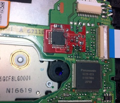

i made my own wiikey 1 download/file.php?id=966
you could also convert a xeno GC into a wiikey 1 and wire solder it
Re: Wii DVD Drive into a Gamecube
The Wiikey v1 and XenoGC use the same basic circuit (except the Xeno has a pair of status LEDs). So, a DIY or retail XenoGC can be flashed with the Wiikey hex and turned into a Wiikey, which should be able to patch the drive for Gamecube backups with working audio streaming. I'll bet it can even read GC backup discs at Wii speed (6x). Another possibility is to make a YAOSM 3.2 using a PIC chip. Both modchip options would require a DMS, D2A, or D2B, Wii drive.

FWIW, I'd suggest doing some research on the SunKey and audio streaming. I tried a bunch of Wii modchips and found that most of them had a broken GC audio fix. Wiikey v1 and YAOSM 3.2 (which patch the drive through the serial debug port) work for sure - I have both. Modchips which connect using an FFC cable cannot play streamed audio - they mute it, although megalomaniac found a workaround for Wiikey Fusion/Wasp.
