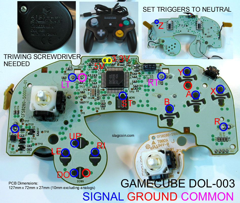

the type of IC on the "wired" controller is different in the wavebird..
ashen has already pinned out this wired controller...
re-read my first post above and understand the two initial questions which must be determined first...( i just edited it to add bold text)

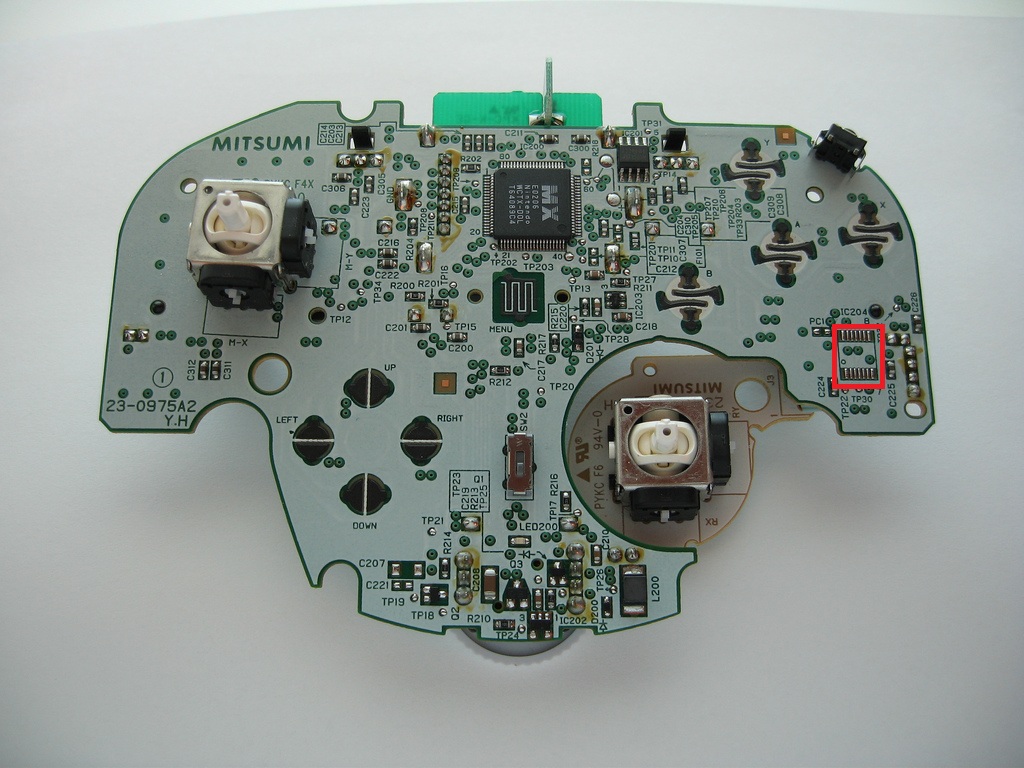

This is fun to think about. Hmm, does this missing IC spot on the pcb look suspicious? Or maybe you guys already have an idea for what it's functions is/was?
edit: I should probably cite the pictures source.
(229.89 KiB) Not downloaded yet

now you should also open a wired controller to compare each layout with each other

Comparing the wired controller to the Wavebird will not reveal anything, as has already been pointed out, they use different MCUs.
IC204, the empty spot over on the right of the board, was more likely to have been some kind of Rapid Fire chip than Rumble, as it's connected to the main buttons on board for the most part.

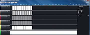

It could be the LED on the Receiver is for Rx only also, but..
I'll need to retract what I said before about the Receiver being a Transmitter as well. I decided last night to wire up the Logic Analyzer between the RF module in the Wavebird and the MCU to see what's going on there, which is something I didn't do before as I was only looking at the data between the GC and Recevier.
Here you can see, kinda as I have it shown over a 2 second time span, so all of the data is squashed up against each other, but when no buttons are pressed, all Data between the RF module and MCU cease, save the Clock (in Green) on the bottom there, which also stops after roughly 30 seconds or so if nothing is pressed.
My initial guess was the polling command was going via the Receiver to the actual Wavebird, like the wired controller does so it knows to send Data, but now it looks like the GC is just polling the Receiver for whatever Data that the Receiver is picking up, so the Receiver appears to be in fact, just a Receiver. I saw no signs of the RF module picking up any kind of Data at all, either last night form testing via my code, or today while using the GameCube. Kinda wish I'd have tried this first before poking around on all of the free MCU pins, but at least I know what most of those are up to now.
So to put the proverbial nail in this Wavebird + Rumble coffin, so to speak and disappointingly so, there is no way the GC can 'tell' the Wavebird to Rumble via the Receiver.
