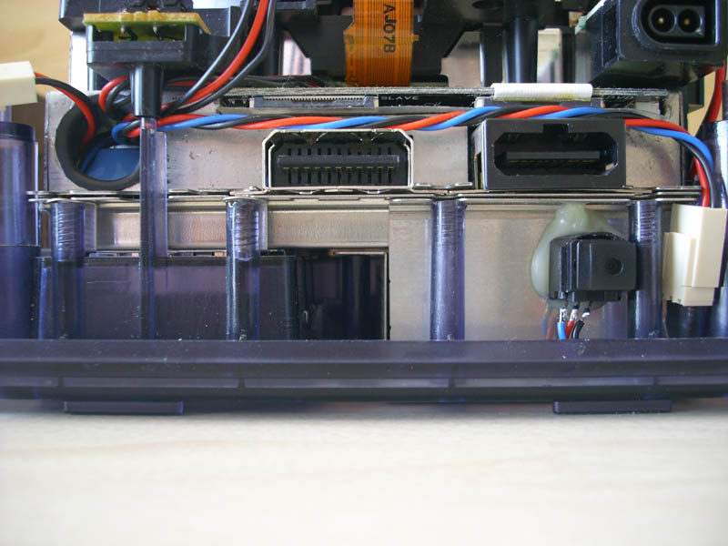

Now you will need to drill a hole into the metal sielding that covers the top of the GC motherboard for the wires to come out of, like the one in the picture below that I had made a while ago for a previous mod. It may also be a good idea to add a grommet to the hole once drilled to keep the wires safe. Please ignore the wires coming out of the same hole with the white connectors on the ends as they are also from the same previous mod. It is the red, black and blues wires that we will be using.
You will need to be very careful when drilling any holes in the metal shielding as it is relatively weak and if the drill snags then you could end up spending quite a while straitening out the bent mess that the shielding has now become I should know, I spent the best part of an hour straightening mine out when it happened to me
Notice the rough square on the shielding for the power regulator board. That is where the optical connector will be going. I have made the suface rough to help the epoxy bond to it. It is totally up to you if you want to bother doing the same but it will give a more secure bond if you do.

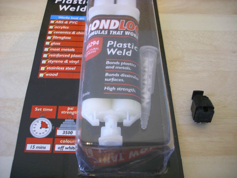

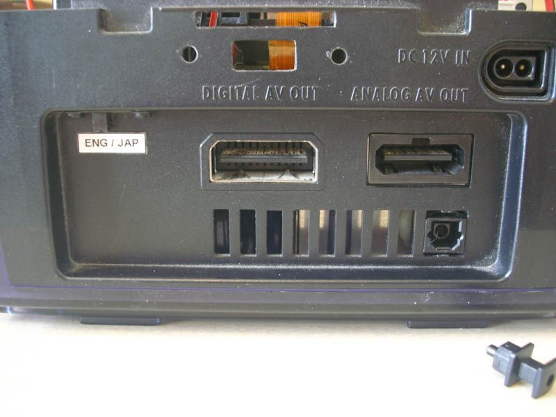

Next up is the back panel. You will need to cut the right most bar away from the air vent under the analog AV out connector hole like in the image below.
Now use a file to roughen the surface on the back of the optical connector and get some high strength plastic epoxy like the one shown below.
Use an optical cable to hold the optical connector in place with the back panel sandwiched between them using the hole that we made earlier by cutting some of the air vent away. Bend the pins of the optical connector toward the back panel to ensure that they don't get covered in epoxy and then apply a large blob of epoxy to the back of the optical connector.
Now tightly hold the optical connector in place using the end of the optical cable and carefully push the back panel into place on the GameCube so that the epoxy on the back of the optical connector also touches the metal shielding of the GameCube's power regulator that I mentioned earlier. Hold tightly in place for about 5 min and then let go and leave for another 10-15 minutes before pulling the optical cable out of the connector, or as long as your prefered brand of epoxy takes to set. When set and the back panel is removed it should look something like this in the image below.
All you need to do now is cut the excess from the 3 wires that we connected to the MEGAudio board earlier and solder them to the terminals on the optical connector. I forgot to mark the image so the connections for the optical connector are from left to right: OUT, 5v and GND same as on the MEGAudio board but you can probably see that from the images anyway. Notice that I have also added a plug between the MEGAudio board and the optical connector. Again it is totally up to you if you want to do the same or not, it is just there so that I can easily disassemble my GameCube without needing to use a soldering iron.
As megalomaniac kindly pointed out in the post below, it is very important that you insulate the pins on the bottom of the optical connector once you have soldered the wires to them to make sure that they don't touch each other and accidentally fry the GameCube. I'll leave it up to you to decide the best way to insulate them being as though I haven't done it myself yet.

...and here is the final picture with the back panel on to give an idea of how it will look once the GameCube is fully assembled.
