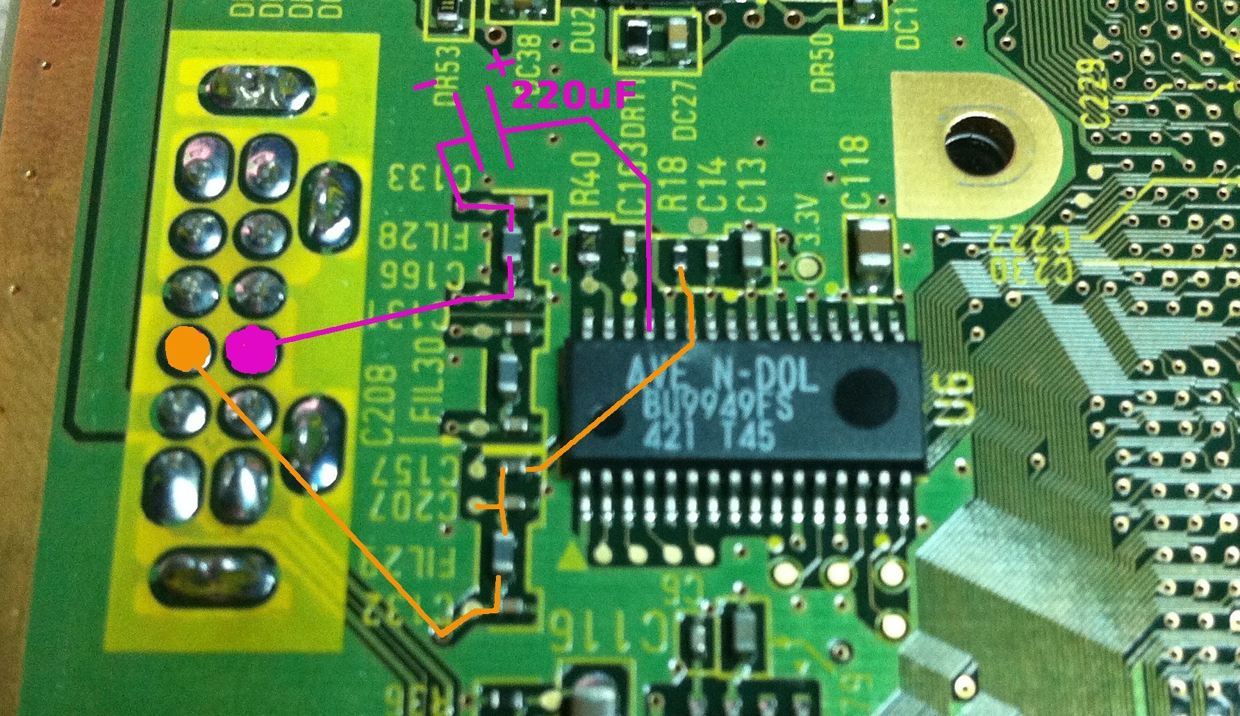

Does anyone have any information on Rev C alternate points for S-video? Forgot to trace it out before trimming my last cube.

Re: The definitive GC motherboard trimming guide, rev C edit
try this...let me know if it works
I'll test this out soon, just need to find my damn Svideo port and cable.
Finally got around to this, the points work fine. Thanks mega!
sweet...it works...
can you post a pic of which points you used for future reference??
I haven't tested the other points yet. I have another Rev C here with me now, I'd be curious to know if there's other points on the top of the board, I think Ashen mentioned that the SVideo lines run through some caps on top.
