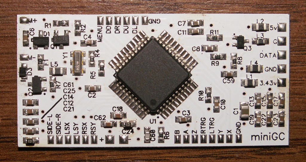

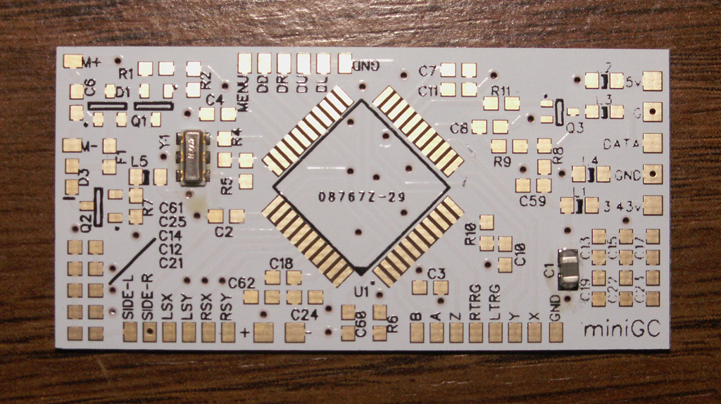

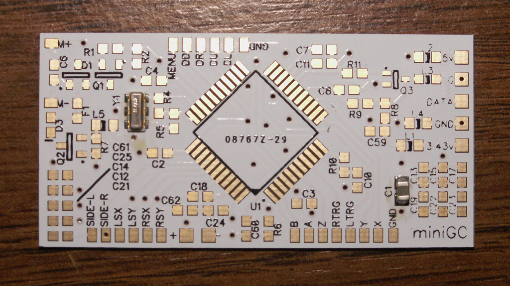

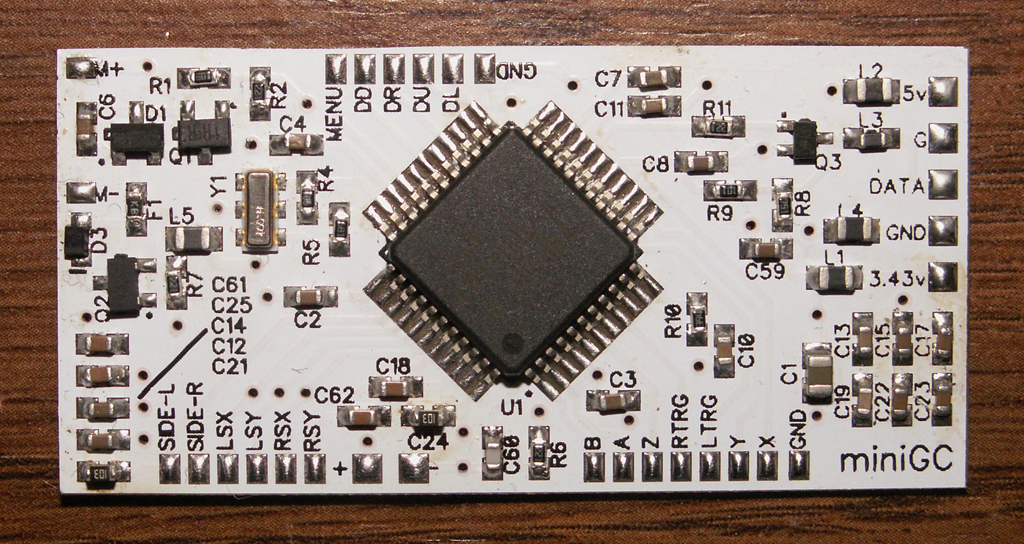

Boards are here now. I'm not thrilled to death with the silk job on them, they offset it for some reason and it's faded in some places on some board. They're not as pretty as they could be, but they're still functional.
Blank board
Full board (with 10k Resistors installed in parallel at C21 and C24 for Digital Slides)
(668.03 KiB) Not downloaded yet
(635.94 KiB) Not downloaded yet

ill volunteer to receive the worst looking board of the batch...
that full board pic you posted should be good enough to use as a guide, but could you also post up the new render too just in case...

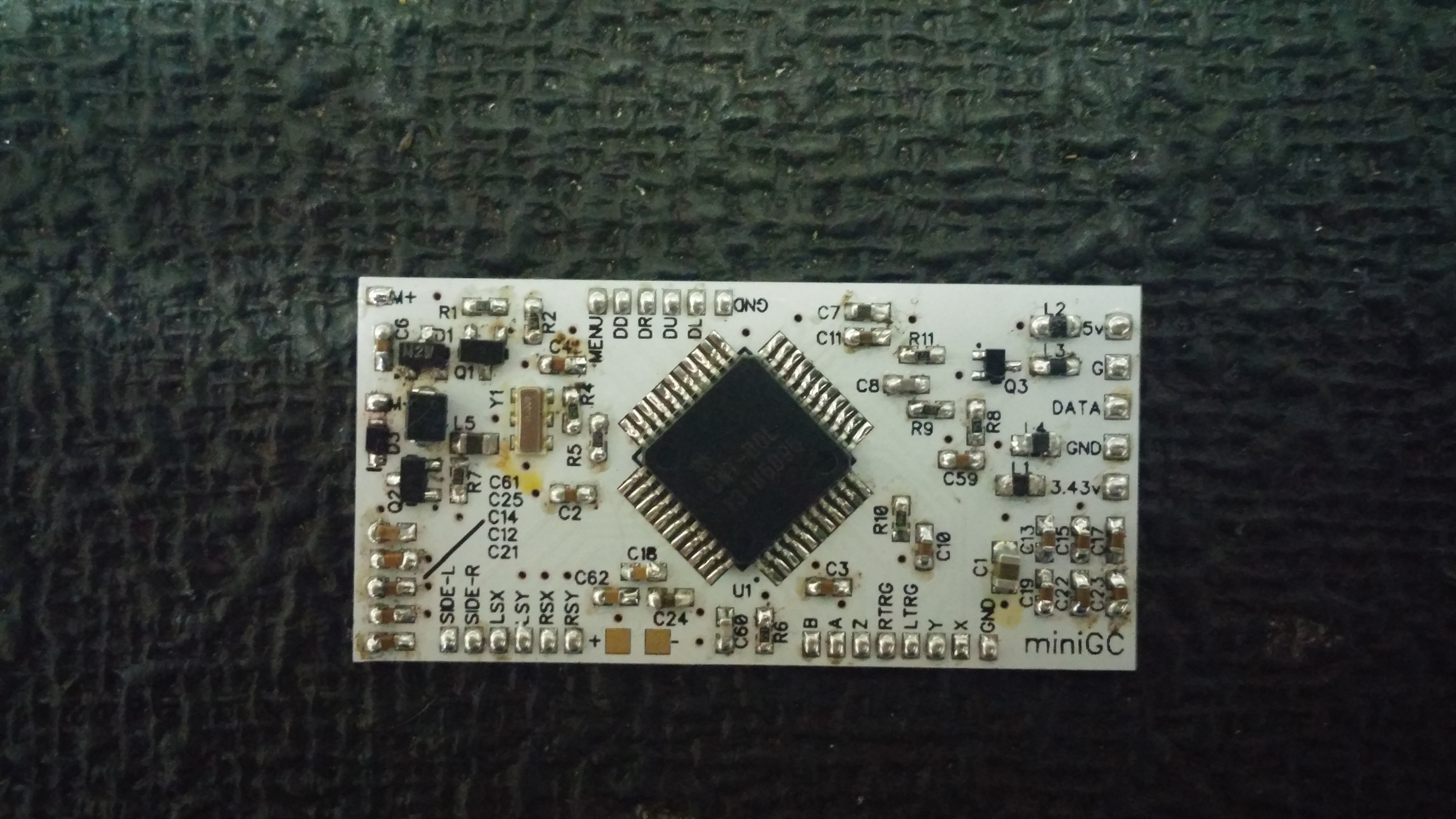

My donor board has F1 as a 1210 size instead of the 0603? size that is on the MINIGC. Is everything else the same?
So far this is what I got done

|RDC| wrote:You can make it fit there, or just toss it and jumper F1 as it's only for the Rumble motor and I've never seen one go bad. Rest is the same.
Yep your right I can make it fit. After 3 1/2 hours labor its done finally. Need to test and clean (and maybe move D1 over a little)
(2.64 MiB) Not downloaded yet

Tested the minigc just had rumble motor, A, and left stick wired up seems to work OK I'm proud of myself only one controller donor. I'm usually not good at desoldering and resoldering but worked out fine and I have a extra also which is good. Thank you very much since I bought your last 2 will you make your Gerber files public so anyone could order a few boards at a later time?
Oh there are two points at the bottom of the minigc labeled + and - obviously - is ground but the + is 3.3 volts correct for the analog sticks

Correct, the + and - at the bottom of the PCB is for the Analog Sticks as well as the Sliders, SIDE-R and SIDE-L as they are Analog as well.
