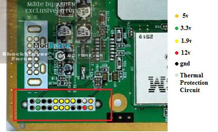

DigitalAV port pin out:
Details: http://gamesx.com/wiki/doku.php?id=av:nintendodigitalav
It can be found, Pin1 is used to detect whether the plug cable is inserted (1.8V means "inserted", grounded or floating means "no inserted"). So, it's easy to handle, we can give a 1.8V signal to Pin1 to simulate inserting component cable. GC internal power module output 1.9V, it‘s closer to 1.8V and can be used:

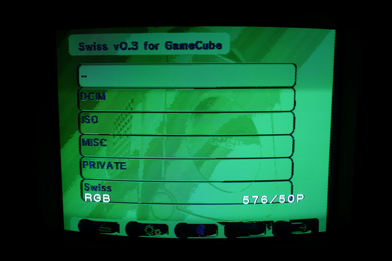

Short 1.9V and Pin1, GC with RGBS connected to the monitor and boot, first the GC boot menu is interlaced, after into Swiss, the screen flashed, we are happy to see, the monitor OSD info has become 576P:
However, although we've got a progressive picture from MultiAV port, but the picture is not perfect, maybe red is missing. After inspection, it should be a problem in sync signal, and it causes red missing.
PAL GC MultiAV port has no independent sync pin, the sync signal of RGB is extracted from composite video, I found that the composite video signal disappear while output progressive signals. (or become very very weak, I guess. Use composite video signal to monitor while output progressive, monitor will prompt "no sync", and has a very blurred image.)
From above research, GC will turn off composite video while output progressive signals, so it will affect RGB sync signal and cause the screen not normal.

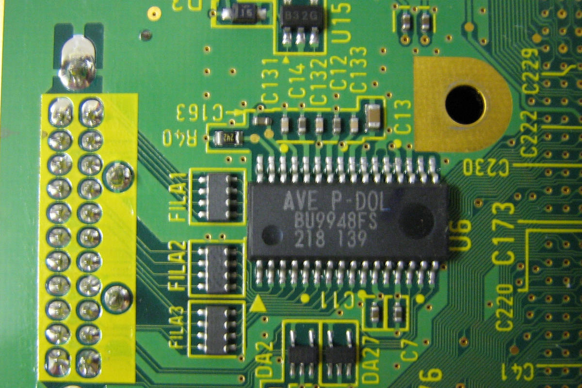

all this information has been posted before...
the composite signal will always cut off because the clock detect in the AVE...
there is no way discovered thus far to allow "proper" progressive video from the analog port of a PAL GC..

It's a sad news for me, thank you for the advice. I'm a newer, and didn't see any previous posts here.megalomaniac wrote:all this information has been posted before...
PAL GC's video chip is "AVE P-DOL", I do not know if there is any way can hack it, is it impossible? Does anyone has the datasheet of the chip?
