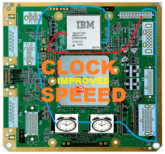

APE992 wrote:This thread is great for some laughs.
APE992 wrote:I'm doubtful we'd see much use for it.
Muh emulators, much clock speed (see clockspeed attachment for visualisation of faster clocks).
(587.6 KiB) Not downloaded yet
Jokes aside, My opinion (while not of high value) is something I stand for. It is a worthy cause.
