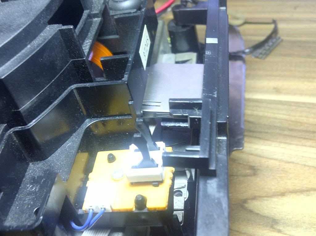

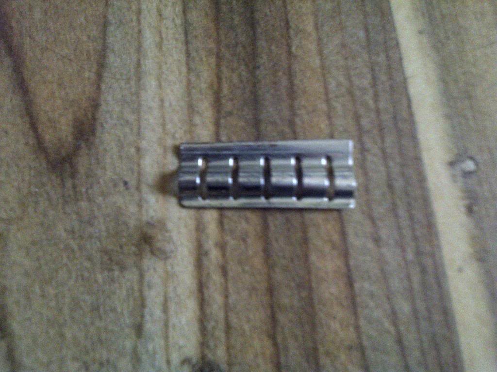

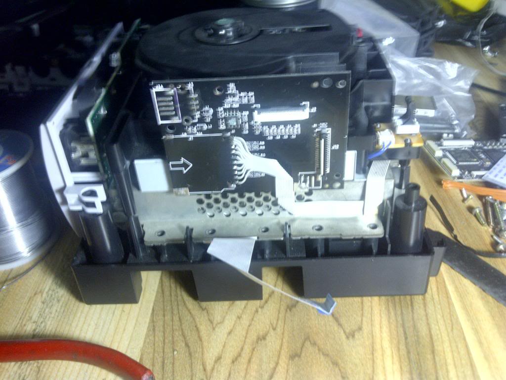

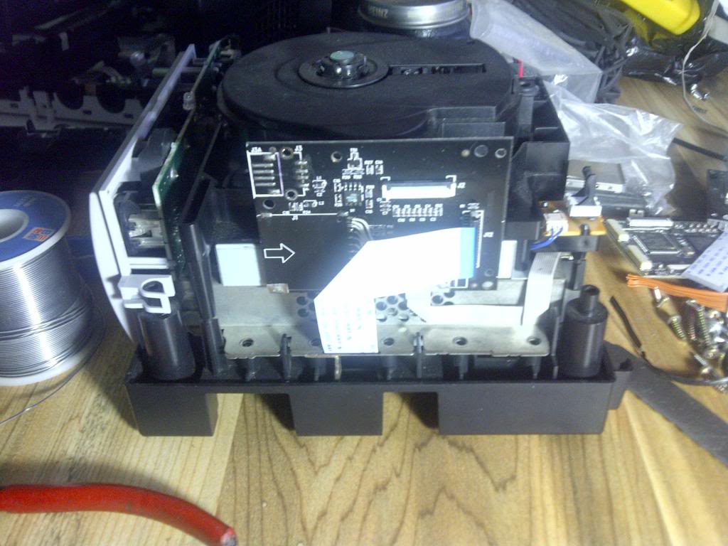

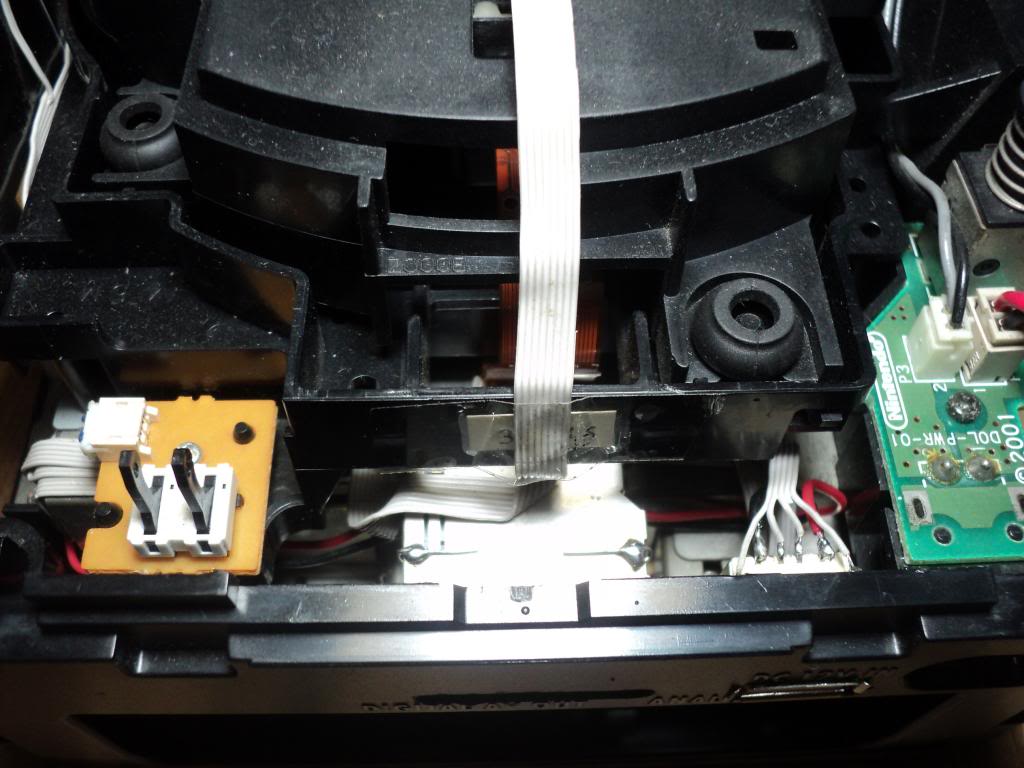

Hello guys sorry for the absence, i was sick the entire week, and didn't worked these days in my GC mod. Today i feel better and start my work again. This is my idea about the place of the other board of wode in my gamecube.

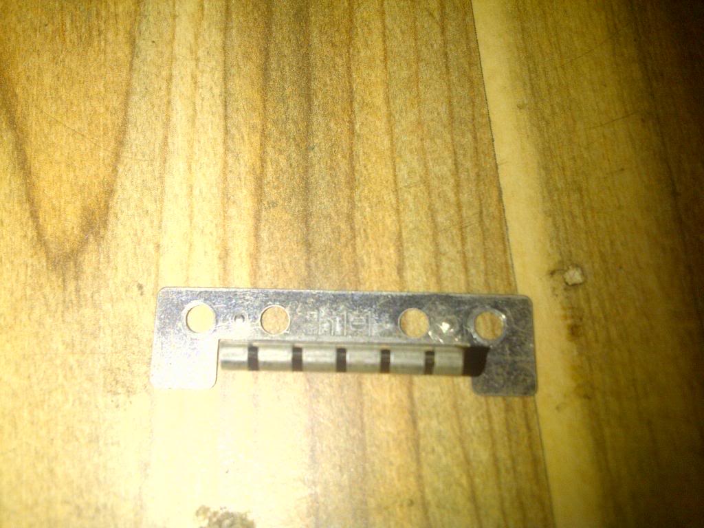

To make it, i decide to sacrifice this little original piece of GC to make the board sustain.
i cut this piece in three parts, First separate this.
Later cut the rest in the middle and solder every one over GNDs points on WODE board, then bend to coincide with these holes.

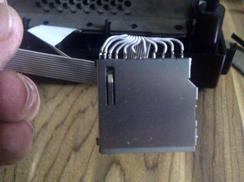

On the other hand, i use the 80 wire ide cable to connect again the SD port.
Bent the cable to fit properly on this site and reach the wode.
I will place the USB port next to the SD. Working on it.
Under construction.
Greetings.

Streetwalker
Posts: 1744
Location: Israel
Re: My WODE Gamecube Original
Post by Streetwalker » Sun May 04, 2014 1:17 pm
Yeah that piece you used connects the controller board's ground to the RF shield. Which is useless because ground is already connected to the motherboard through the FFC.

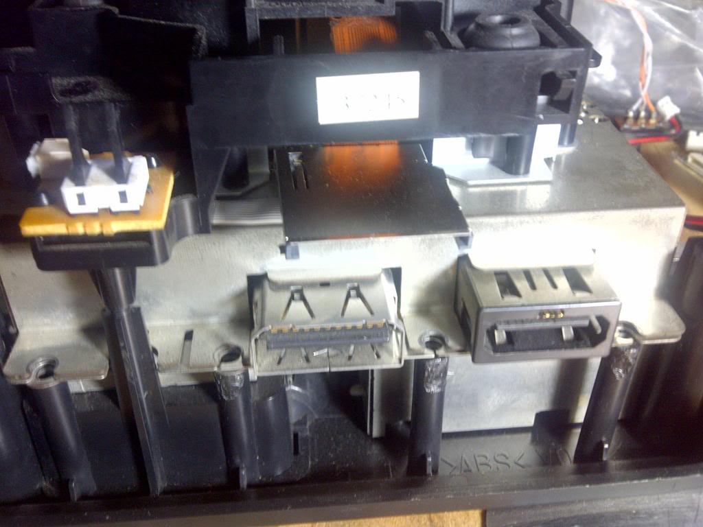

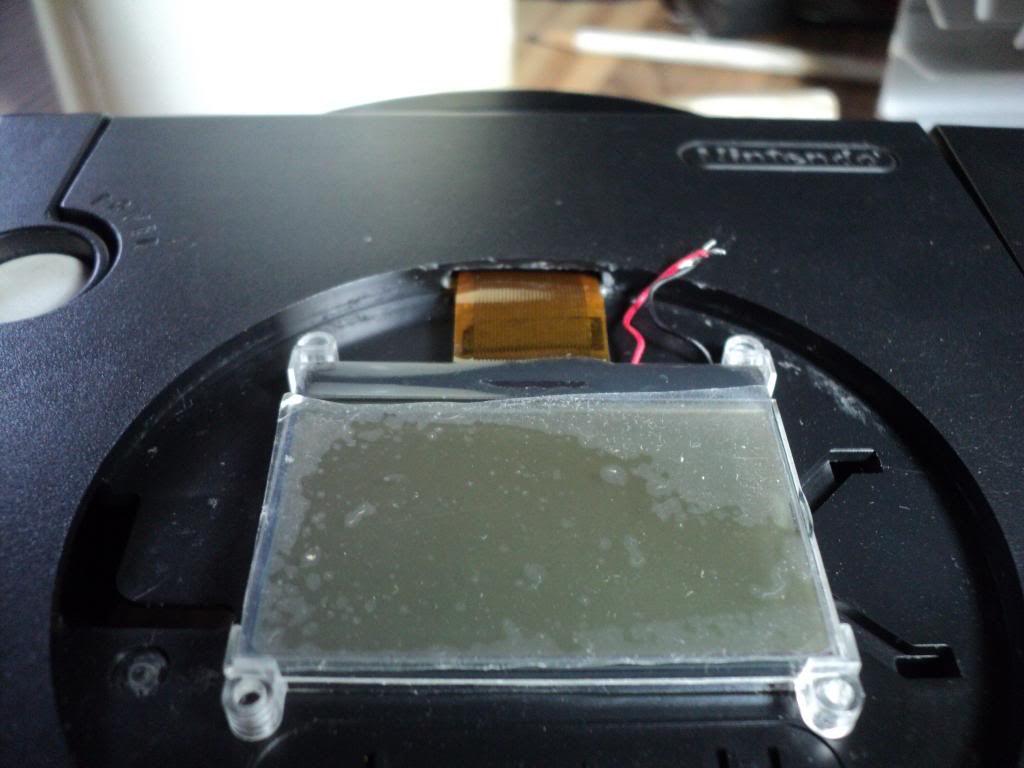

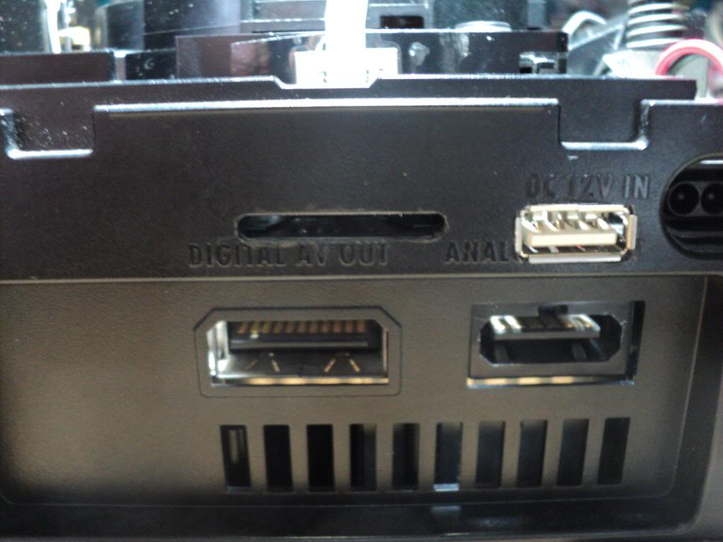

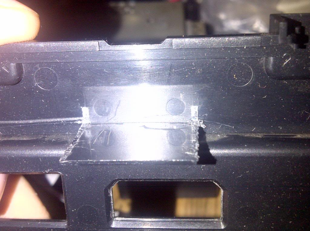

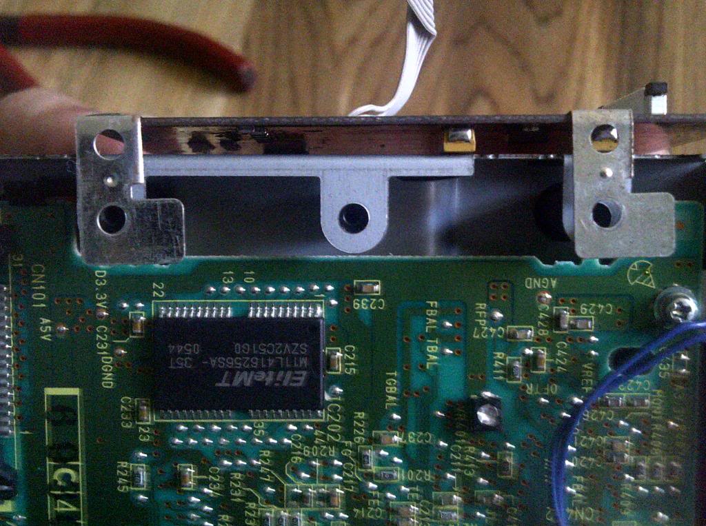

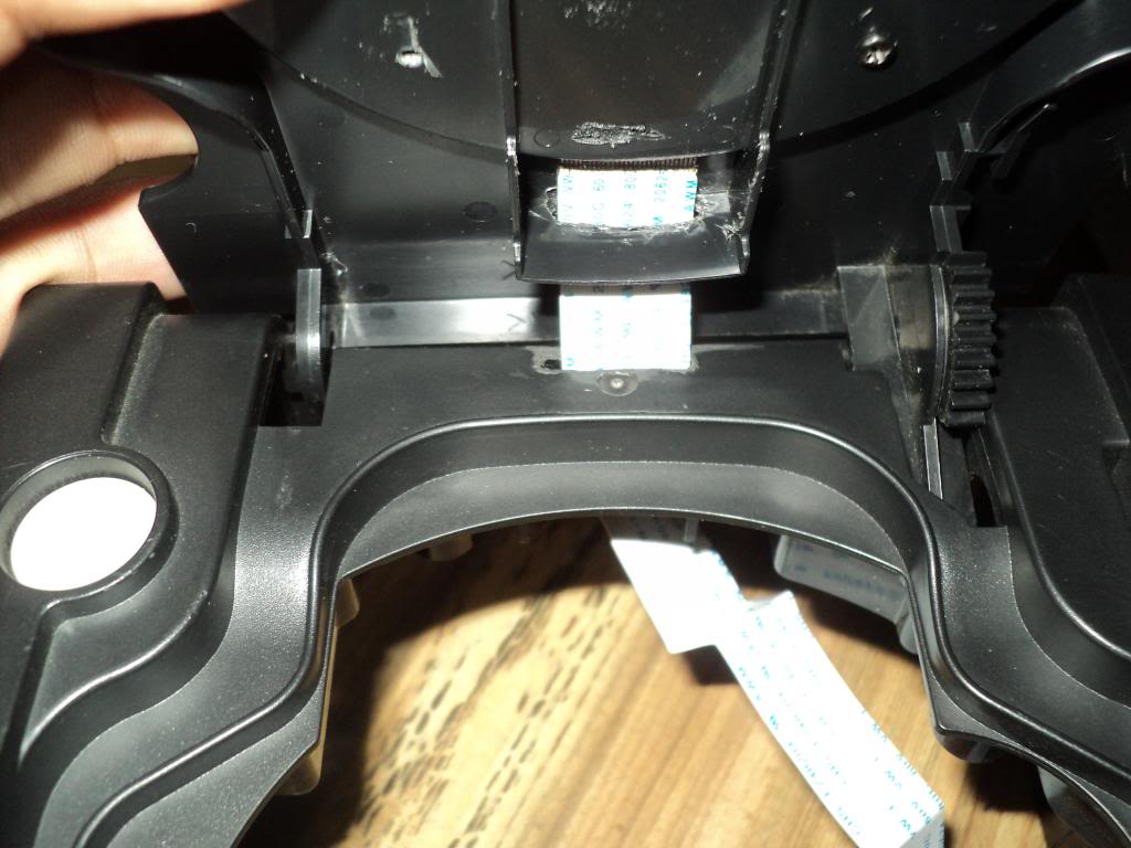

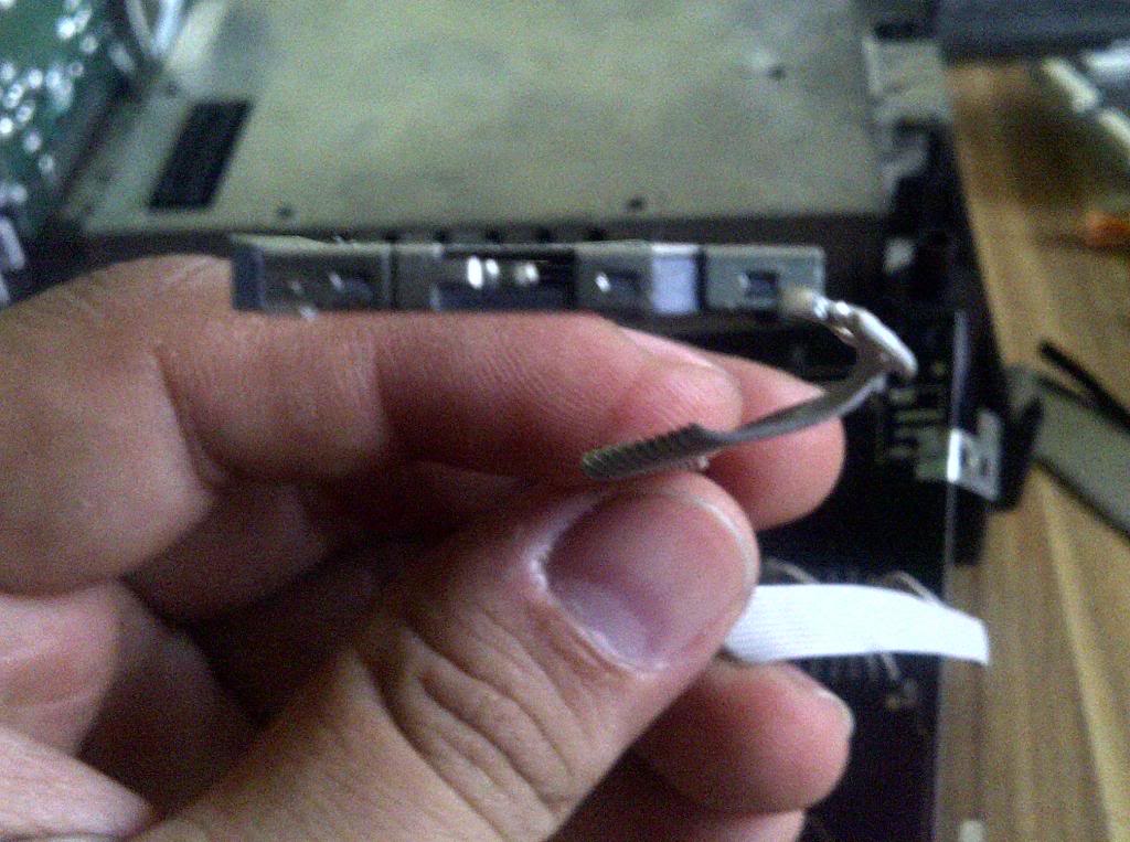

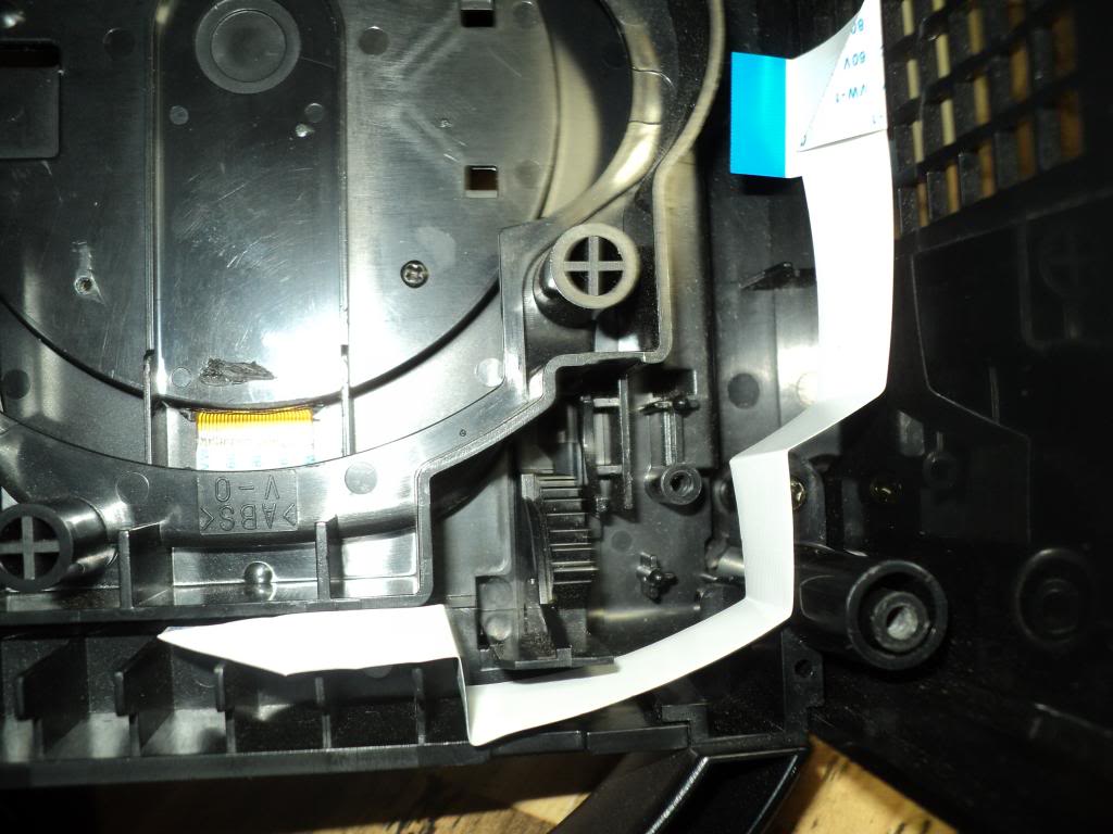

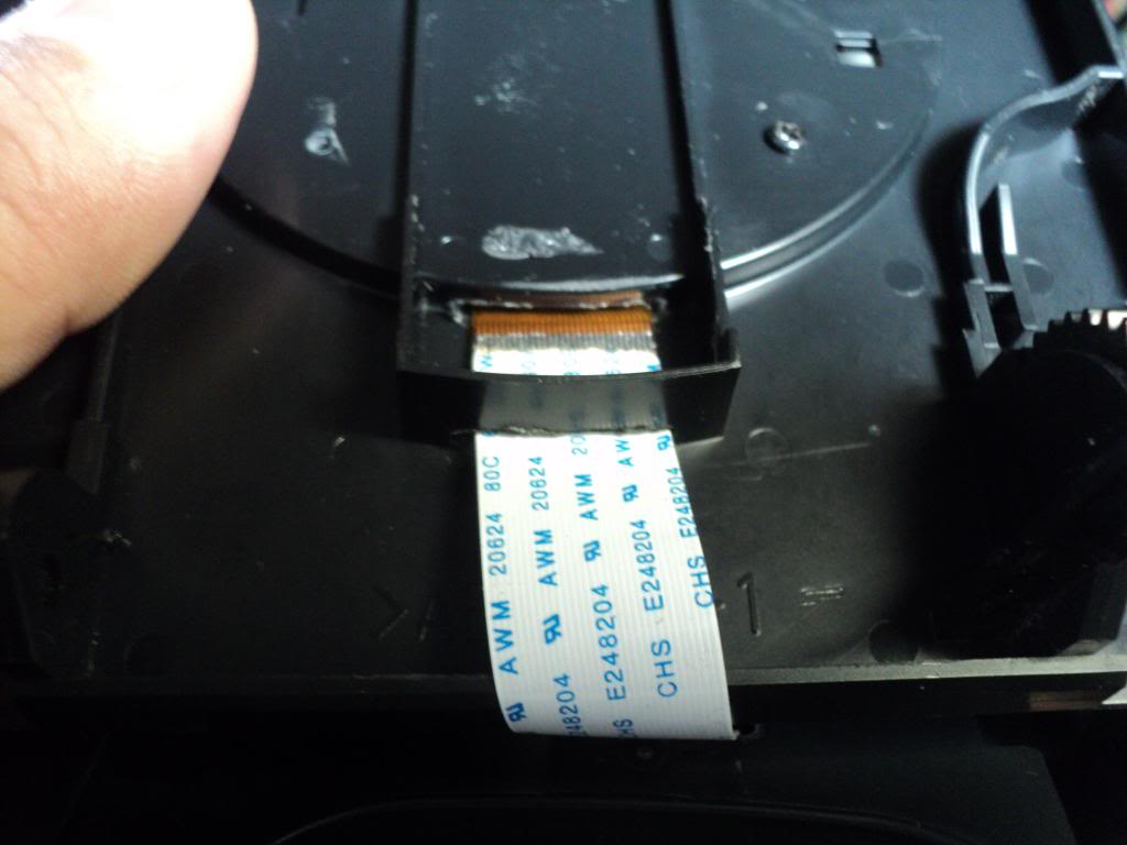

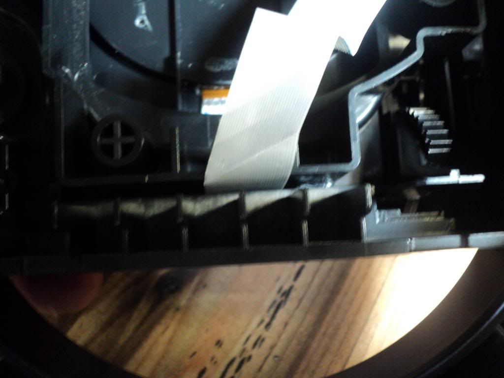

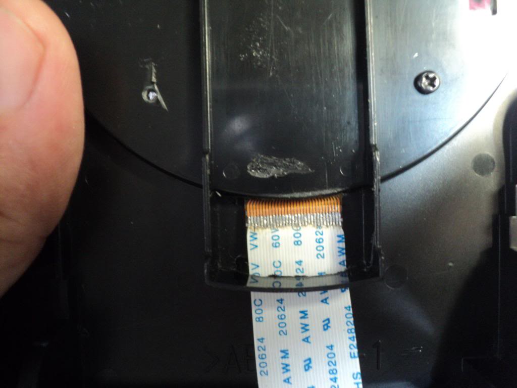

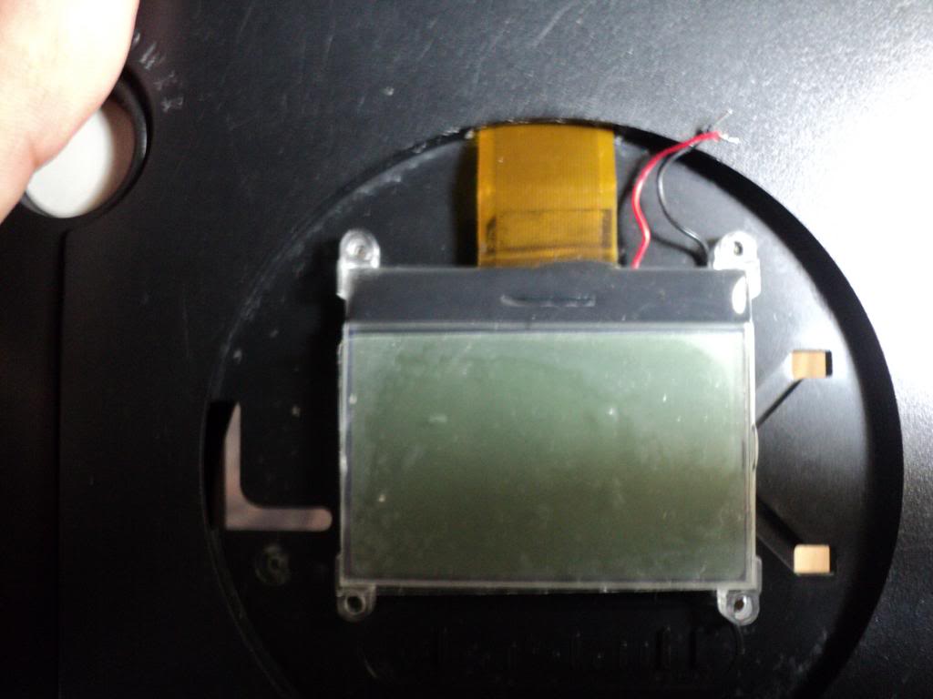

Hello guys, sorry the adsense, many life occupations. I Worked again yesterday in my mod and here show my progress.
The final site to play Wode screen is the GC disc Cover. I not yet decided the site for the stick selector. I not sure to place it in the GC cover, beside the Wode screen or in another place. While I solve the dilemma, show i did for now:
I solder directly the new 30 pin flex in the Wode screen flex to lengthen it. And to pass the flex, i made various groove hole in these places it shows in the photos.
Finally, i bent the flex, with the necessary measures to cover the distance to where i locate the Wode Screen Card.
And this is the cable with the Stick and backlight connections, these place is provisional in case to place the stick in the disc cover. It pass for the back side of the Screen flex, using the same holes.
And these is the Sd an usb location.
Greetings.
Under Construction.

ShockSlayer
Posts: 97
Post by ShockSlayer » Tue May 27, 2014 5:13 pm
I must say I love the ANAL port.
linkerm
Posts: 33
Joined: Mon Apr 05, 2010 4:56 am
Post by linkerm » Tue May 27, 2014 6:14 pm
I had not noticed that little detail ... :shock:
You are a pervert. :lol:
This GC likes the backdoor. :mrgreen:
Greetings.

kel01
Posts: 149
Post by kel01 » Thu May 29, 2014 1:12 pm
That's some quality soldering, where you connected the 2 FCC cables together 8-)
Most people including myself would probably end up melting both FCC's trying that.
