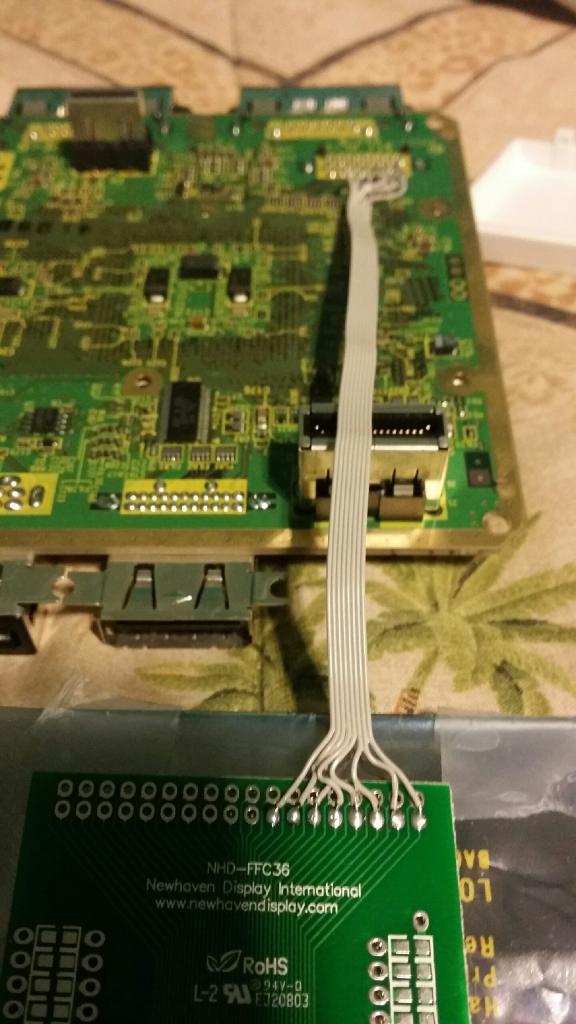

Hello all. I finally have some parts in and would like for the final out come of all this to result in a disc-less gamecube. I have a wasp fusion, a ffc36 and a gamecube with a purple start menu which to my understanding from reading through gc forever and other places should have the ipl I want. Here's a parts pic, I'll update later after I've done some work on it.
(74.63 KiB) Not downloaded yet

Good luck man! It took me three attempts to get it working ;) Take your time and keep the wires short!
Re: First attempt at a disc-less gamecube.
Post by megalomaniac » Fri Jun 06, 2014 1:37 am
anything shorter that about 180mm is good...
any problems will be soldering related, or lack of user experience of what to expect from how a WKF/WASP is suppose to work....not wire length...

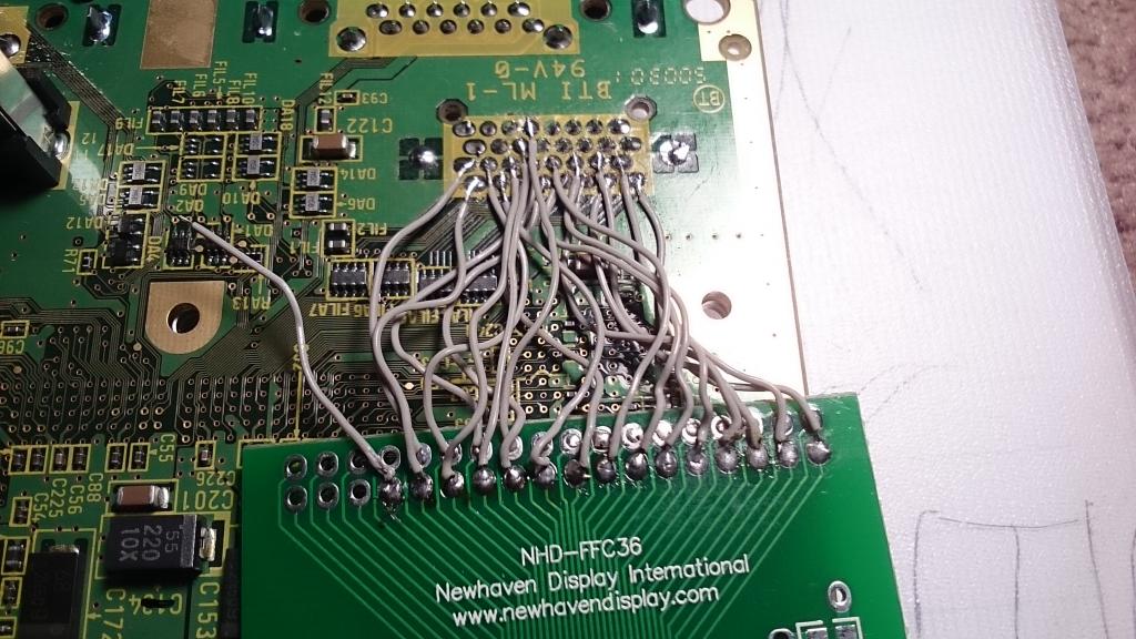

Thanks I made the wires 6 inches long so I can wrap the board around to the the other side. When I put these parts together I did not know of the megadrive :/ if this route proves to troublesome I'll be ordering a megadrive. Here's pics of the only progress I was able to make today.
(98.05 KiB) Not downloaded yet
(74.53 KiB) Not downloaded yet

Post by megalomaniac » Fri Jun 06, 2014 3:21 pm
That might not work...or might have intermittent issues
6in wires + 3in adapter + 4in FFC cable = over 30cm

Post by bizzyb » Fri Jun 06, 2014 8:47 pm
megalomaniac wrote: 6in wires + 3in adapter + 4in FFC cable = over 30cm
Sometimes it's the simplest of things that get us lol. Your absolutely right. Luckily I've only soldered what I've shown in the pics. When I get home from work I'll take care of that and hopefully get the ffc all wired in.

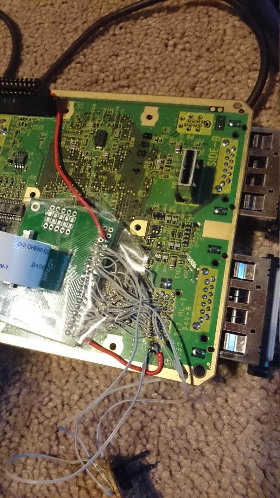

Quick update. I removed the disc drive connector and found it easier to solder the ffc in. I shortened the wires up quite a bit. Not the prettiest job but I believe it's done other than wiring up the two switches on pins 29 and 23, connecting power and ground. I need to read up on flashing swiss and using it as the initial startup(assuming that when I plug the wasp in everything works lol). More updates to come.
(120.35 KiB) Not downloaded yet

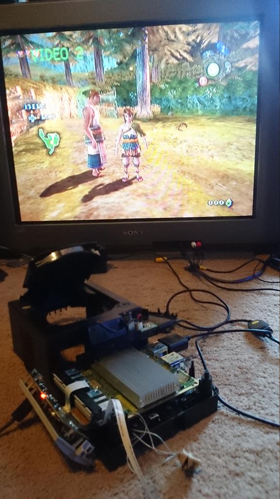

Hooked everything up and did a quick test. Appears to be working correctly :) time to clean things up and make it all tidy. Next step is to flash swiss. Guess I'll try my hand at a portable cube next time around.
(81.02 KiB) Not downloaded yet

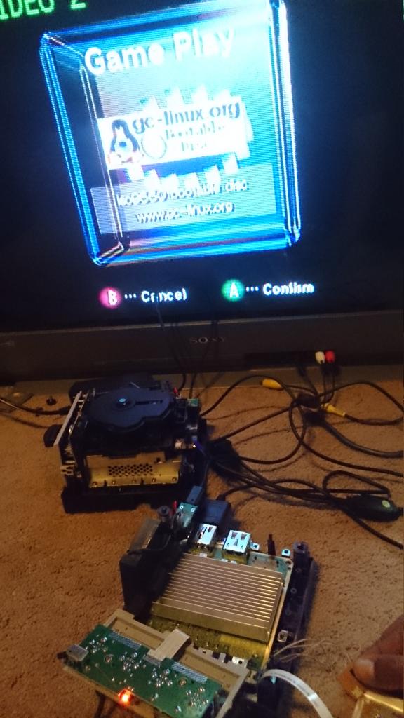

Post by bizzyb » Sun Jun 08, 2014 6:38 am
Update. I knew this seemed too easy. I know am having intermittent issues. Everything was working fine, I updated the wasp to 1.5 no problem, then when trying to flash the wasp with swiss it went back to the gc menu. Now the wasp flashes the blue light intermittently at times and appears on the menu screen at random. If left alone for a bit it will boot up just fine and load swiss. My other issue is I changed the swissflasher gcm to an iso and when the wasp does load it it say "init wii fusion". I'm going to move the ffc and wasp to the top of the board and shorten wires even more. I'm not sure if it's getting to hot under the board for it :/
Post by megalomaniac » Sun Jun 08, 2014 12:30 pm
intermittent issues can be related to just about anything...good luck troubleshooting...
"init wii fusion" is because you have a WBFS card in the fusion slot rather than FAT/FAT32.

Post by bizzyb » Sun Jun 08, 2014 5:49 pm
I ran a few more tests. Seems when the system is cold the wasp works just fine. When the system gets up to operating temperature the wasp acts funny and gives me intermittent issues. Not sure if anyone has had issues with heat before but I'm definitely moving the ffc and wasp to the top side of the motherboard instead of sandwiched underneath.

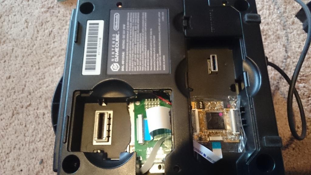

Post by bizzyb » Sun Jun 08, 2014 7:38 pm
I had the system all buttoned up last night but without the top inside plate and the issue began after some use. I haven't received any error messages just the wasp working intermittently and not loading anything do to that fact. I'm pretty sure my placement of everything was not ideal and heat is definitely an issue.
(82.08 KiB) Not downloaded yet
(86.43 KiB) Not downloaded yet

Post by bizzyb » Sun Jun 08, 2014 8:02 pm
Reading is my friend :) after reading through some more tutorials and such on here I'm going to use Ashens tutorial on wiring the ffc cable directly to the wasp and not using this breakout board. Secondly I'm using stranded ide cable and I should be using solid core wire :/ more updates to come.

Post by HomelandReloaded » Sun Jun 08, 2014 8:28 pm
Nothing wrong with your cable length or breakout board if you look at my clumsy first attempt at soldering on this thread: viewtopic.php?f=3&t=74&start=144
If you look further down that page you'll see a very neat example by harvey263.
From the image you just posted I'd say the wasp is almost certainly getting too hot. You need both the fan and an enclosed heatsink unless you are using a laptop fan right on top of the heatsink. If you re-use the same thermal conductive pads like I do, there is a possibility of an air gap between the pad and the chips due to the spacer feet on the heatsink.
