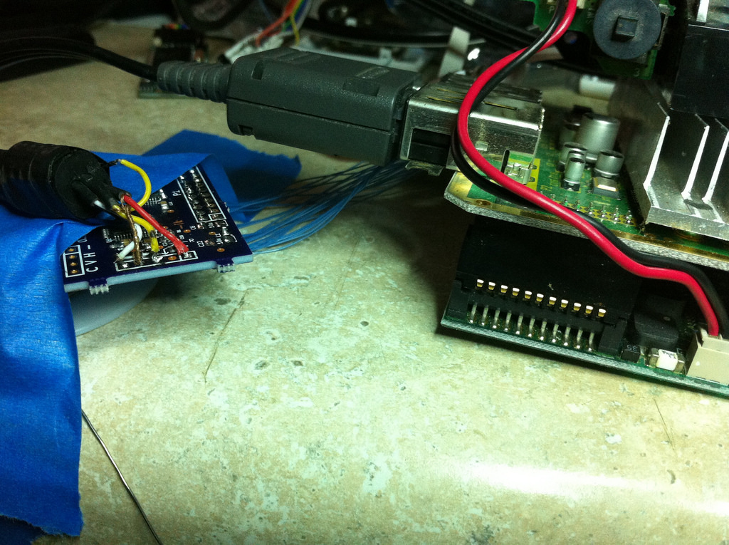

Post by megalomaniac » Tue Sep 23, 2014 3:37 am
quick pic of a fast and dirty install...
(333.06 KiB) Not downloaded yet
Post by Ashen » Tue Sep 23, 2014 4:19 am
I love that you use tape just like i do to secure things for testing. I also love all that wire porn you hate so much.
Post by megalomaniac » Tue Sep 23, 2014 4:49 am
Ashen wrote:I love that you use tape just like i do to secure things for testing. I also love all that wire porn you hate so much.
i love tape...i hate wire porn....
my unreleased MEGA X project will take care of all that wireporn crap...
