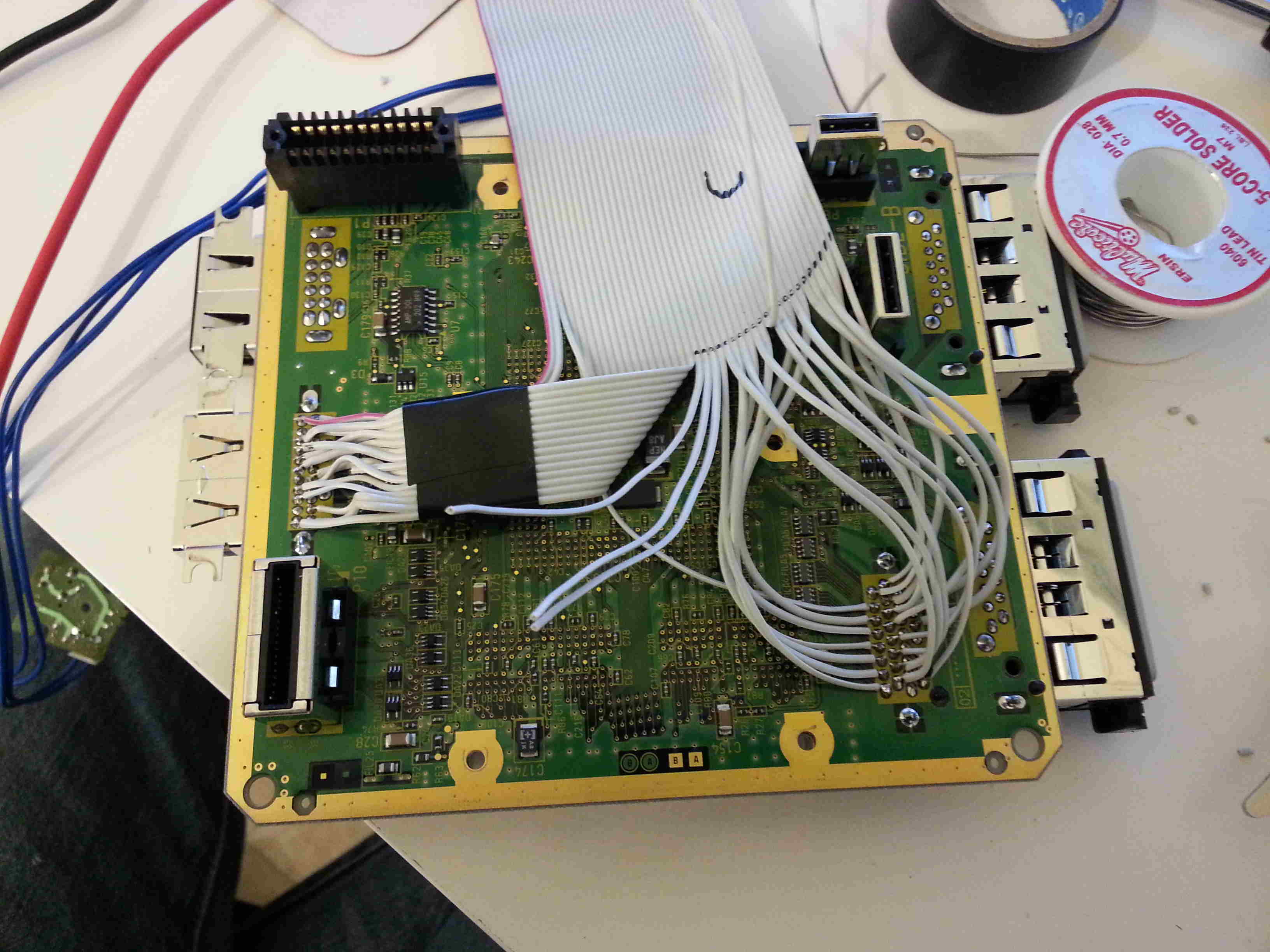

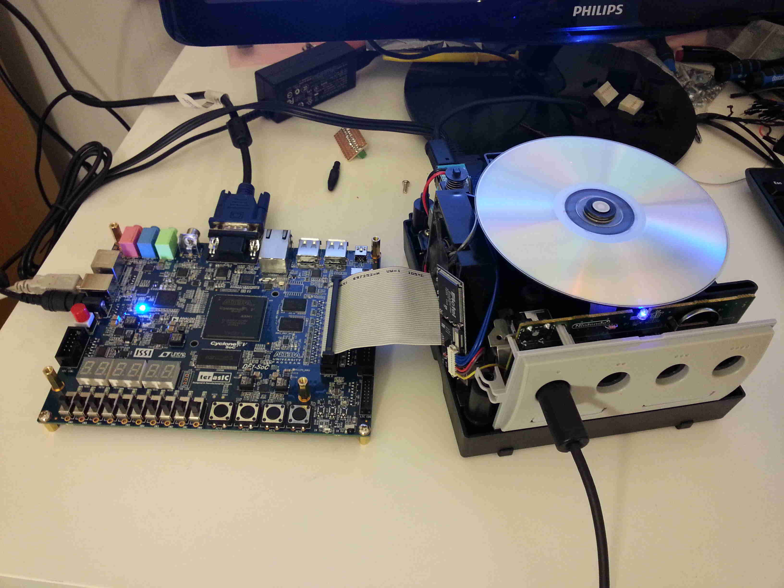

Post by pyroholic » Thu Nov 27, 2014 9:43 pm
Sure, I have started a bit already so I attached a couple of pictures that kind of gives you a hint on what I'm doing. Don't mind the messy desk ;)

DerGali
Posts: 19
Joined: Wed Aug 07, 2013 11:29 pm
Re: DVD Drive IO voltage
Post by DerGali » Thu Nov 27, 2014 10:07 pm
Looks like an ultimative fpga for the gamecube melting two fpgas into one wasp+gcvideo sandwich :o

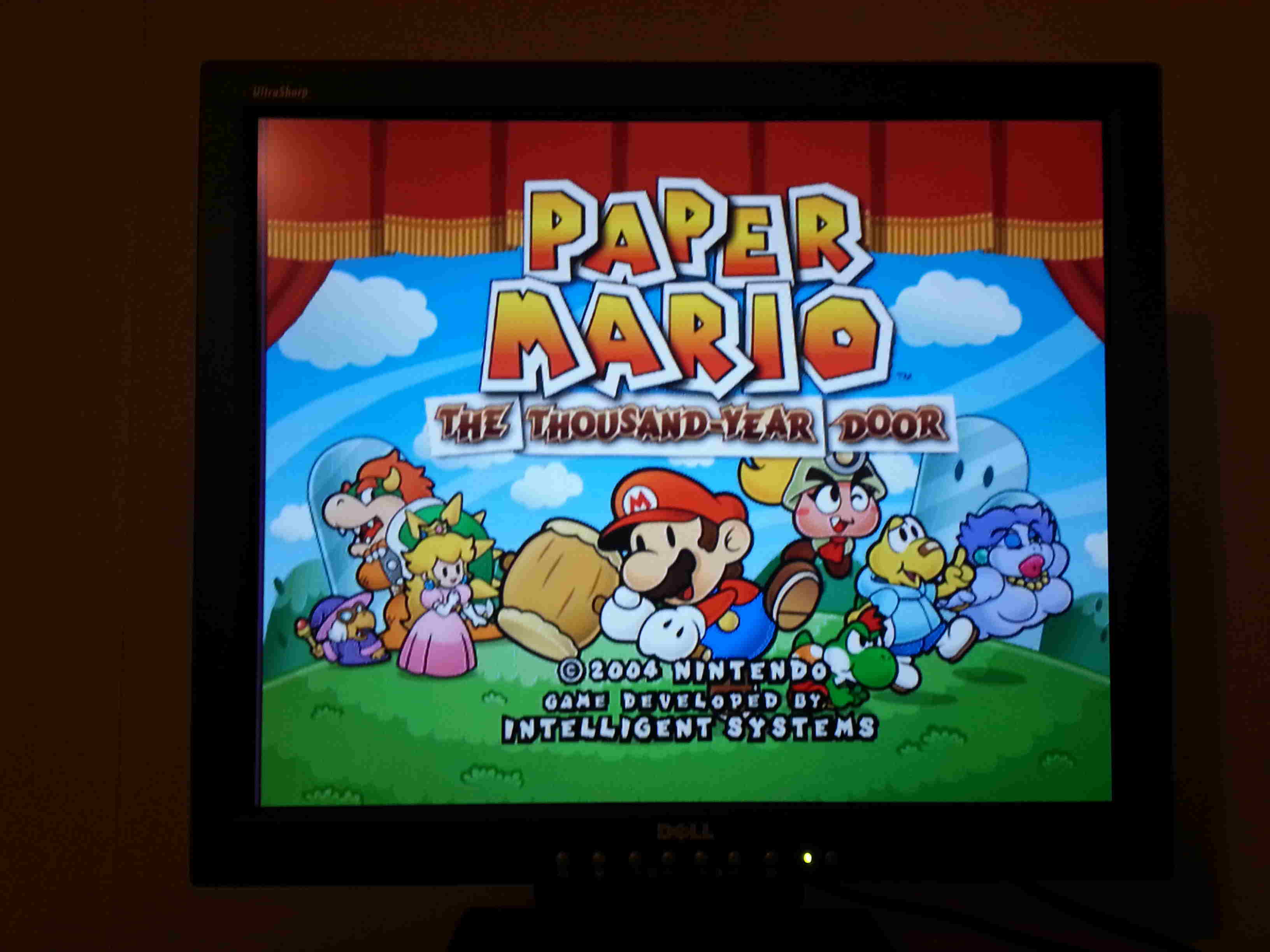

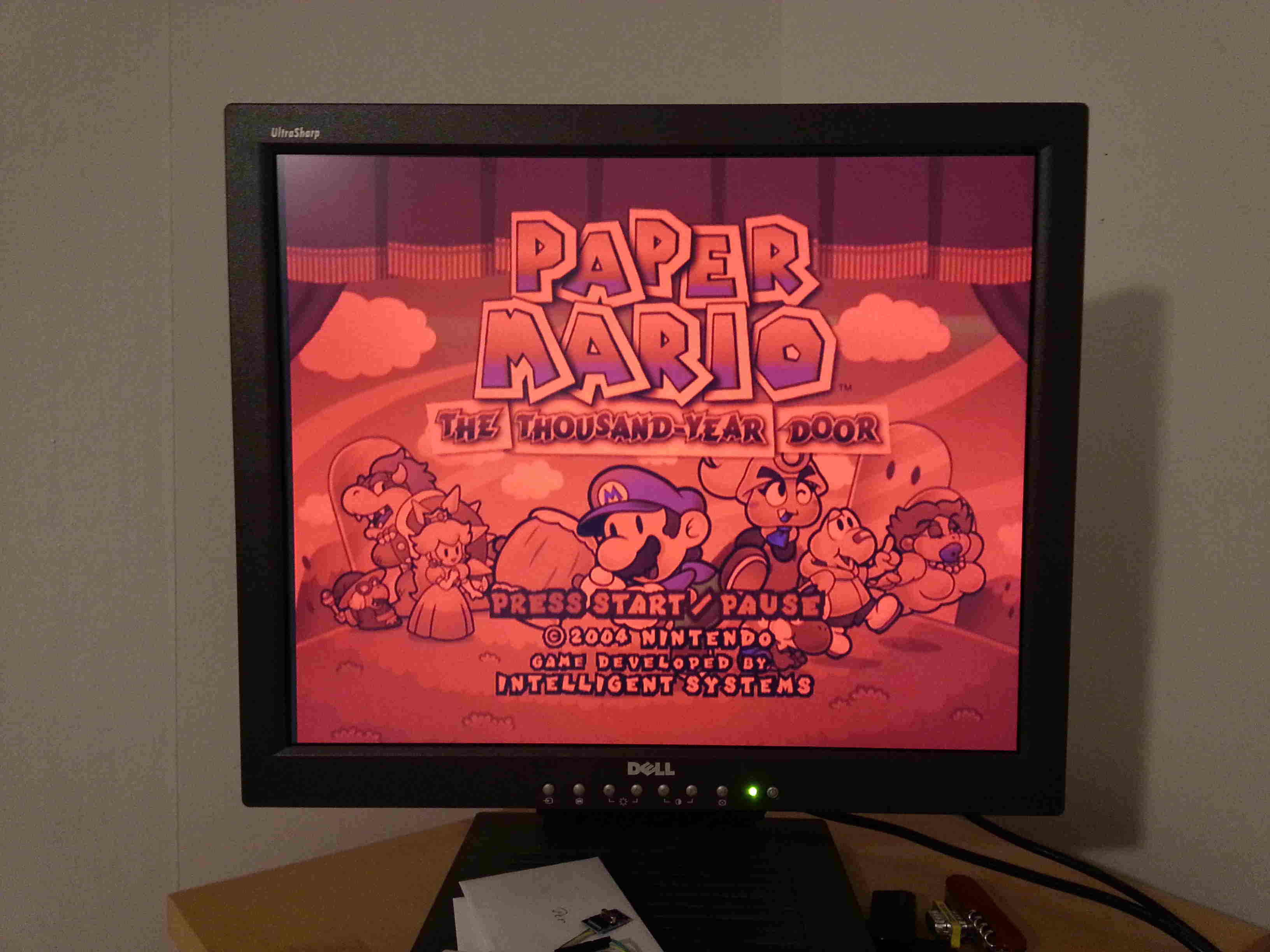

I actually got started with some coding today. I decided to start with the video interface since it is a lot simpler and it's fun to make some progress. It was pretty straight forward to read the data stream, extract sync flags and synchronize the Y Cb Y Cr stream. Shown on a vga monitor without conversion it looks like this:
And that's no fun so i hacked up color space converter to turn the video into RGB color space and ended up with this:
So far I have not done any compensation for the conversion delay, so that's why there is a strange 4-pixel wide border to the left.
I think have a strange issue though, it can be seen on the lower right part of Mario's pants, where there is a strange blue artifact near the outlining. I'm suspecting, well actually i'm pretty sure, that it is a timing issue since I have not gotten around to setting up timing constraints yet, but have not started to dig deeper into it yet.
Swiss support would be awesome, and I promise that no eject simulation will be present :mrgreen:

I have to agree with you, playing on the original gc is the best.
There is a lot of unused pins on the dev board, and I have actually thought about IPL replacement as well usb-gecko etc. The FPGA is also kind of overkill for this project, so it should be possible to stuff whatever is desired into it. It also has an embedded ARM core that could handle communication with usb-drive, ethernet etc :shock:
