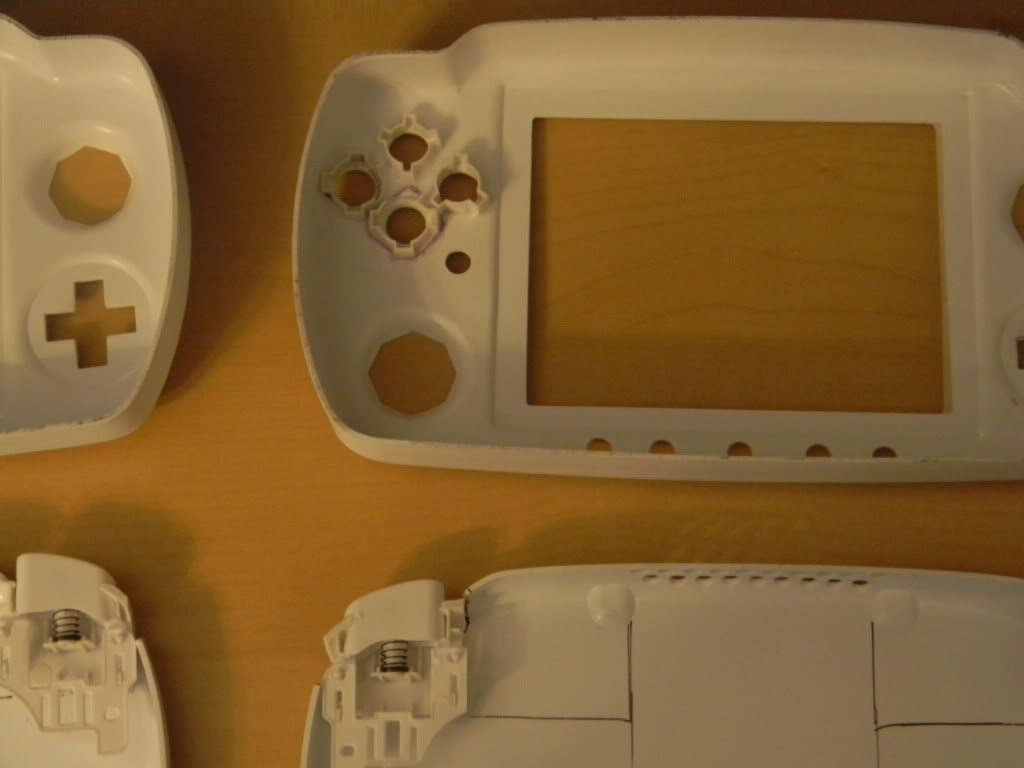

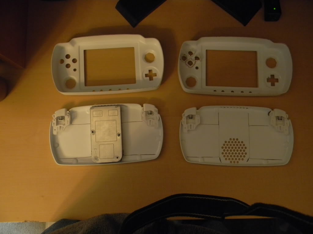

Little update on the status of my first 2 portables. Sadly it looks like I'm not going to have enough room in my cases to incorporate some of the features I wanted and were requested. Namely 4 player support and T.V. out support. There is just not enough space. I'll have to refine my design for the next batch if I want to incorporate these features.
Anyway. I'm still churning away on the cases. The good thing is I am starting to see the light at the end of the tunnel now. I have all of the front holes cut for the buttons and the L/R buttons epoxied in. I only have the double Z buttons, Speaker Holes, SD card slots and a few other little things to cut yet and I can start Painting. Yay!
I've also been forced to go with a 7.4v battery setup using Zenlocs custom reg because of space constraints. This isn't really a bad thing but will result in roughly 2hrs battery life. 1 hour less than I was shooting for.
On to some new pics!
Both cases mostly cut:
A little closer up view of button retainers and L button setup:
Sizing things up (stuffs just kind of laying in there for the pic):
