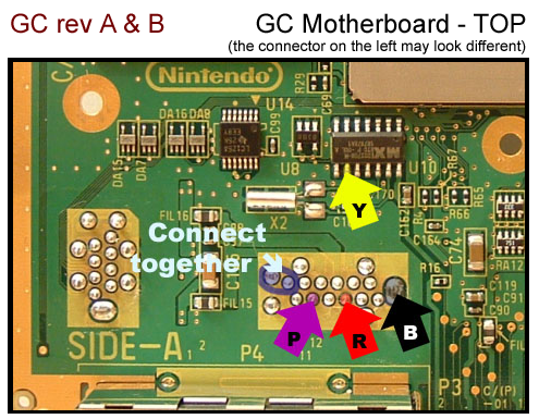

Thank you kel01. So, emu_kidid, Ashen, kel01, I saw that Viper GC instalation requires a solder bridge between two neighbouring contacts on the GC motherboard ("Connect Together" of the attached picture). To install Wiikey Fusion on my GC, after remove Viper GC should I break this bridge or there is no need???

pr0ton
Posts: 186
Location: NL
Post by pr0ton » Fri Apr 13, 2012 5:06 pm
Nope, just two ground connections. Somewhere else they are connected too, so :).
DOL-001&DOL-101 <- PAL
Posts: 4927
Post by emu_kidid » Fri Apr 13, 2012 10:58 pm
You can choose to unbridge it, it's up to you. Basically it's a "connected" state for the modchip to be always "inserted" in the EXI slot.

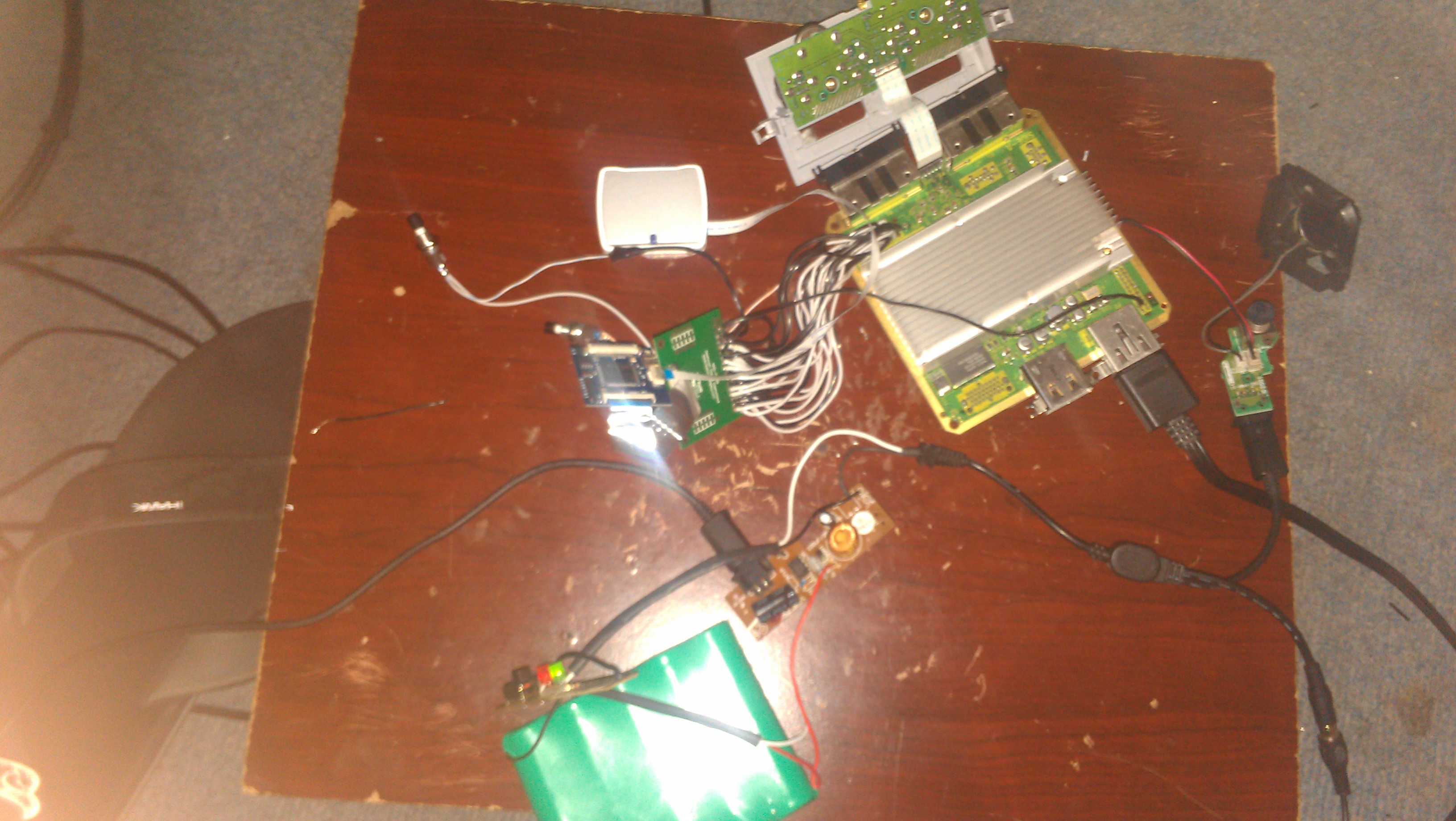

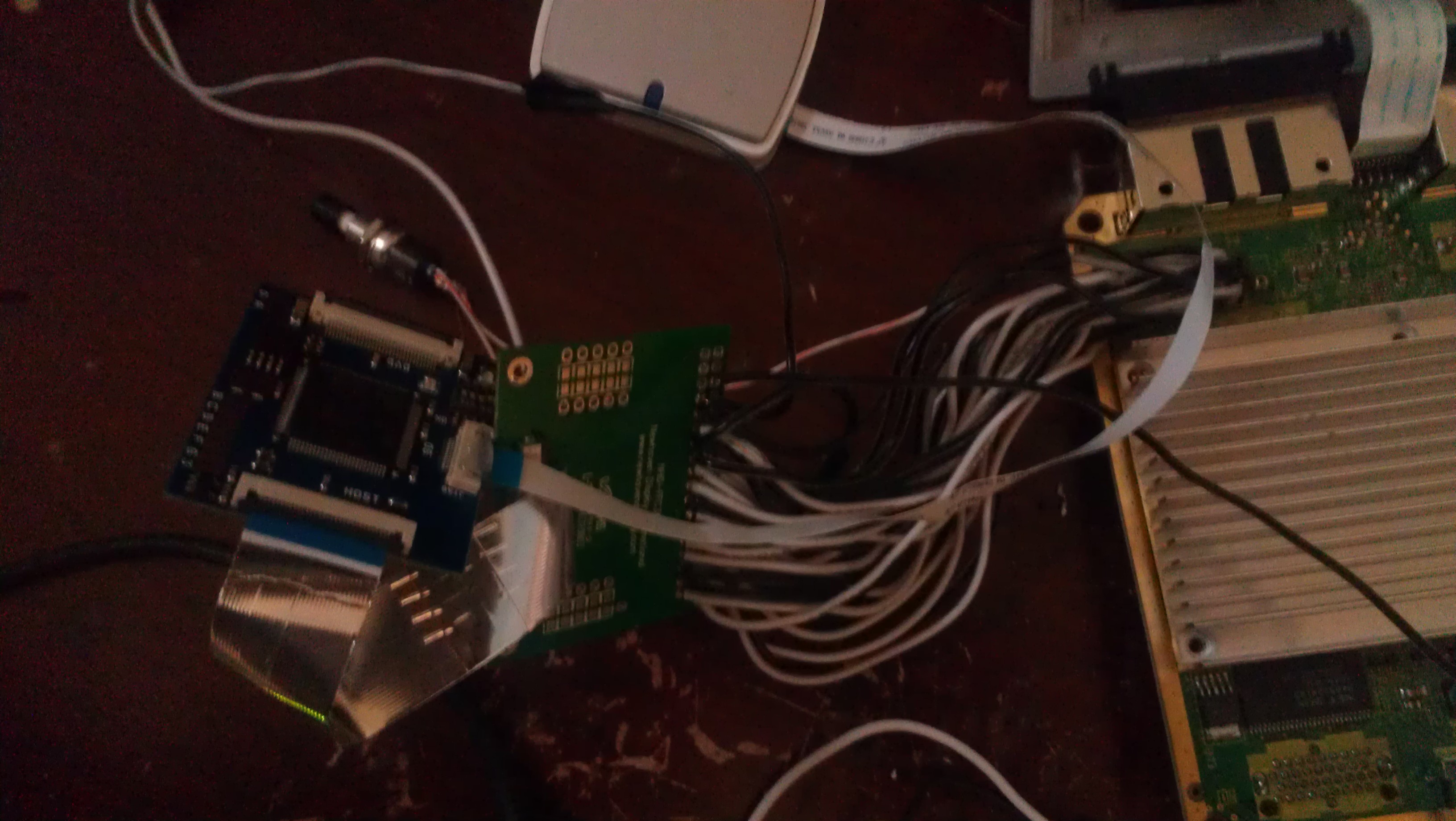

i am new to this so there for im a noob and cant get the wiikey fusion to work on my gamecube. it feels like im missing a really simple step to get it working but for the life of me i cant get it to work, with this build the gamecube gives me an error as soon as i turn it on. the system was working fine before i opened it up. the wiikey fusion is also working as i tested it and updated it on my wii. im using the 36 pin adapter board and made sure the ribbon is all the way to the right. the region switch is set correctly. ive re soldered the connections about three times just to make sure they are properly connected. ive checked the pins enough times that ive memorized the pins. the gamecube board is compatible its a dol 001 (11). ive soldered all the ground pins to there own pins and bridged them on the back of the adapter board. only other thing i could tell you is the wii key fusion does flash red when i turn it on. ill include a picture of my so called gamecube and i really hope u can help me.

Post by Ashen » Wed Jun 06, 2012 2:34 am
Can't tell much from your pics. Wires look a bit long to me. What happens when you press the "eject" button? Red light at boot either means you've got a misconnection or that no SD card is inserted.
