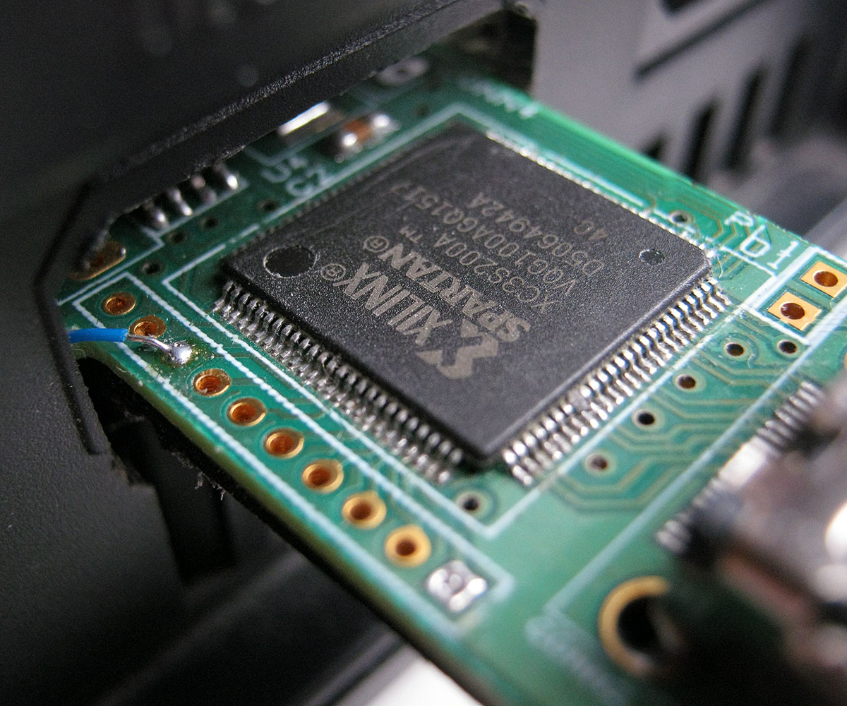

The site you are linking focuses on a smaller FPGA. Therefore, it does not have the OSD. I am pretty sure you cannot flash your FPGA with the bit file from there.
Take a look at this post to see where you need to connect the controller via on your Shuriken board: viewtopic.php?f=26&t=3092#p33126
Here is a picture of where you can find the via for the controller signal on your GC board: https://github.com/ikorb/gcvideo/blob/m ... roller.jpg
It is pretty small, so be careful. The way I soldered it, was by sticking a small piece of kynar wire into the via and then add solder to connect them.

Khar00f wrote:I got the shuriken bit file 2.1 from ikorb/gcvideo on github..
This is the correct one.
It works but there's no OSD or Sound.
Did you connect the additional wire from the via marked on this picture to the Shuriken video board? It should be connected to the smaller pin header besides the FPGA on the Shuriken board, third pin from the Gamecube end. Without this wire you won't be able to enter the OSD, because the FPGA can't read the controller inputs and thus the OSD won't work.
It's the pad with the blue wire in this picture:
You don't get any sound because by default GCVideo outputs a pure DVI signal to stay compatible with previous versions.
[img]http://www.gc-forever.com/forums/download/file.php?id=2075[/img]

Good day Unseen,
Thank you for lending a hand, I'm Def going to be trying that wire when I get a chance, I know for a fact we didn't connect it and from what meneerbeer and yourself are telling me, it seems that's the last piece if the puzzle.
Will keep you guys posted on the outcome.

I want to thank each and everyone of you for your assistance, it worked and it's freak'n awesome.
I love it.
THANK YOU

I'm quite new to this, bought 3 OSH Park v2 PCBs and looking for all the components required to get this built.
Bought a few componets off uk.farnell.com as follows;
1) Flash Memory, NOR, 4 Mbit, 512K x 8bit, 75 MHz, SPI, NSOIC, 8 Pins | Part No M25P40-VMN6PB
2) Fixed LDO Voltage Regulator, 2.3V to 6V, 250mV Dropout, 1.2Vout, 1Aout, SOT-223-3 | Part No MCP1826S-1202E/DB
3) Fixed LDO Voltage Regulator, 6.4V to 18V, 1.2V Dropout, 5Vout, 1Aout, SOT-223-3 | Part No AP1117E50G-13
4) HDMI Connector, 19 Contacts, Jack, Surface Mount, Gold Plated Contacts, Metal Body | Part No 47151-1001
5) FPGA, SPARTAN-3A, 200K, 100VQFP | Part No XC3S200A-4VQG100C
Apart from resistors what else am i missing? Had a look at the list from 2xWhiskey but just want to check before i start buying parts.
I'm a complete noob to this just looking for some guidance. Any pictures of your assembled boards would be appreciated.
Sorry if this has been covered else where but everyone here seem to know what they're talking about and to me its all going over my head.
Thanks.
