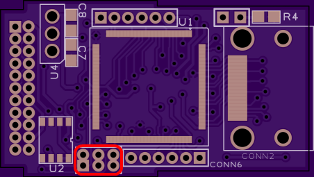

Is JP1 the through hole pair of pads next to R4? Do I literally just short them, or should a capacitor or something be used?
It appears that it was not successful on verify, without shorting. I did not realize that I should have closed JP1. I will continue with the recompile, and more appropriate flashing program before trying again. Looks like I need to rebuild the cable based on your parallel port design. (4x 100ohms on different pins.)

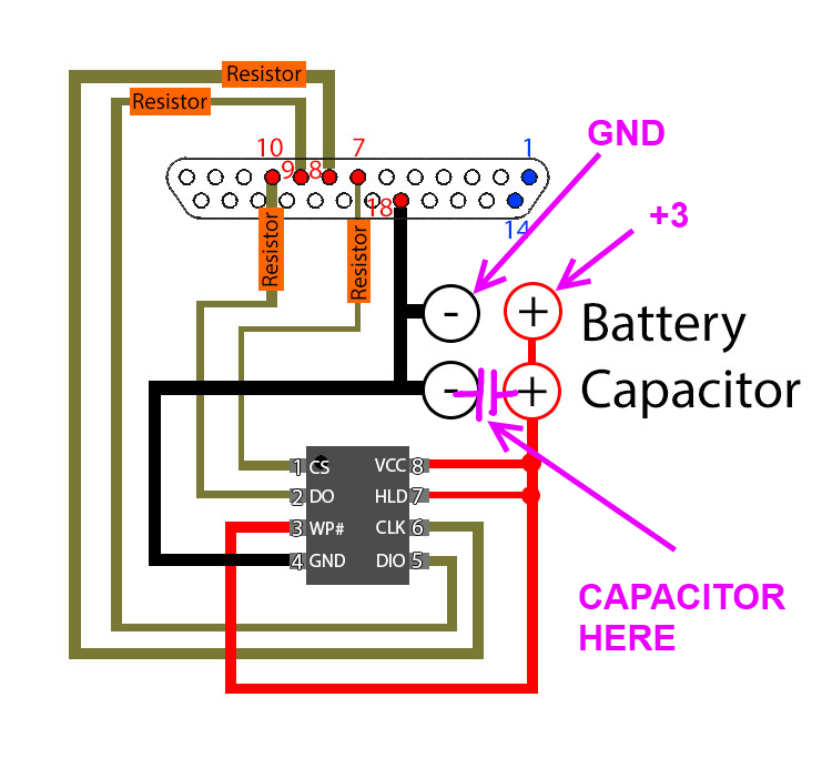

I switched to SPIPGM. My flash erases fine. However during programming I get mismatched size warnings. Verify is full of errors.
Where does a capacitor go in your diagram? I don't see one. Why is pin 1 and 14 blue?
Yes, it is. Just short.
I don't think you need a capacitor in your setup. My setup was with lithium battery (without GC, FPGA, everything).
It's connected to +3.3v (3.0v) and GND. Back then I thought that it helps for verifying but it failed again.
It's not mine I don't know. Don't wary you don't need them.

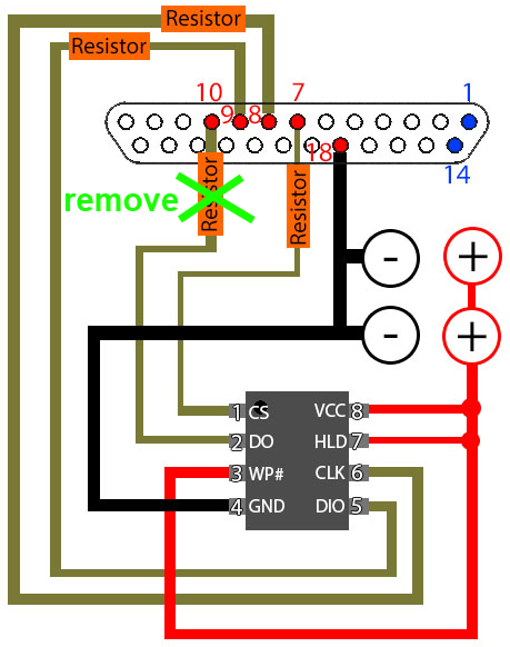

First short JP1, program the chip and verify. Isolate JP1 and try if it works.
If you still get errors You can try shorter (thicker) wires.
At last you can remove one resistor for better communication.
But let mi check which one. You will burn the flash memory + other stuff (even GC) if you send 5v without voltage drop resistor.

It may reduce errors while verifying:
(92.32 KiB) Not downloaded yet

bytesaber wrote:Where does a capacitor go in your diagram? I don't see one.
I see. This diagram is used in other google search results, asking about the same topic. Those places also contain comments from people suggesting "Besure to use the capacitor!" So I was never able to see where they were adding it. Okay, so being powered by a Gamecube makes it irrelevant then.

I did have JP1 closed for all programming attempts. I opened JP1 during tests. I should just order a programmer :D However, I admit this can be fun.

bytesaber wrote:Besure to use the capacitor!
I've tried with/without and lower value capacitor, the result was pretty much the same. But in the final product I have 1000uF capacitor.
bytesaber wrote:I will try shorter and larger gauge.
You can use those pads for the thicker wires.
About the resistor. I meant if you remove wrong resistor you will burn at least the flash memory. My programmer doesn't have resistor on MISO line.

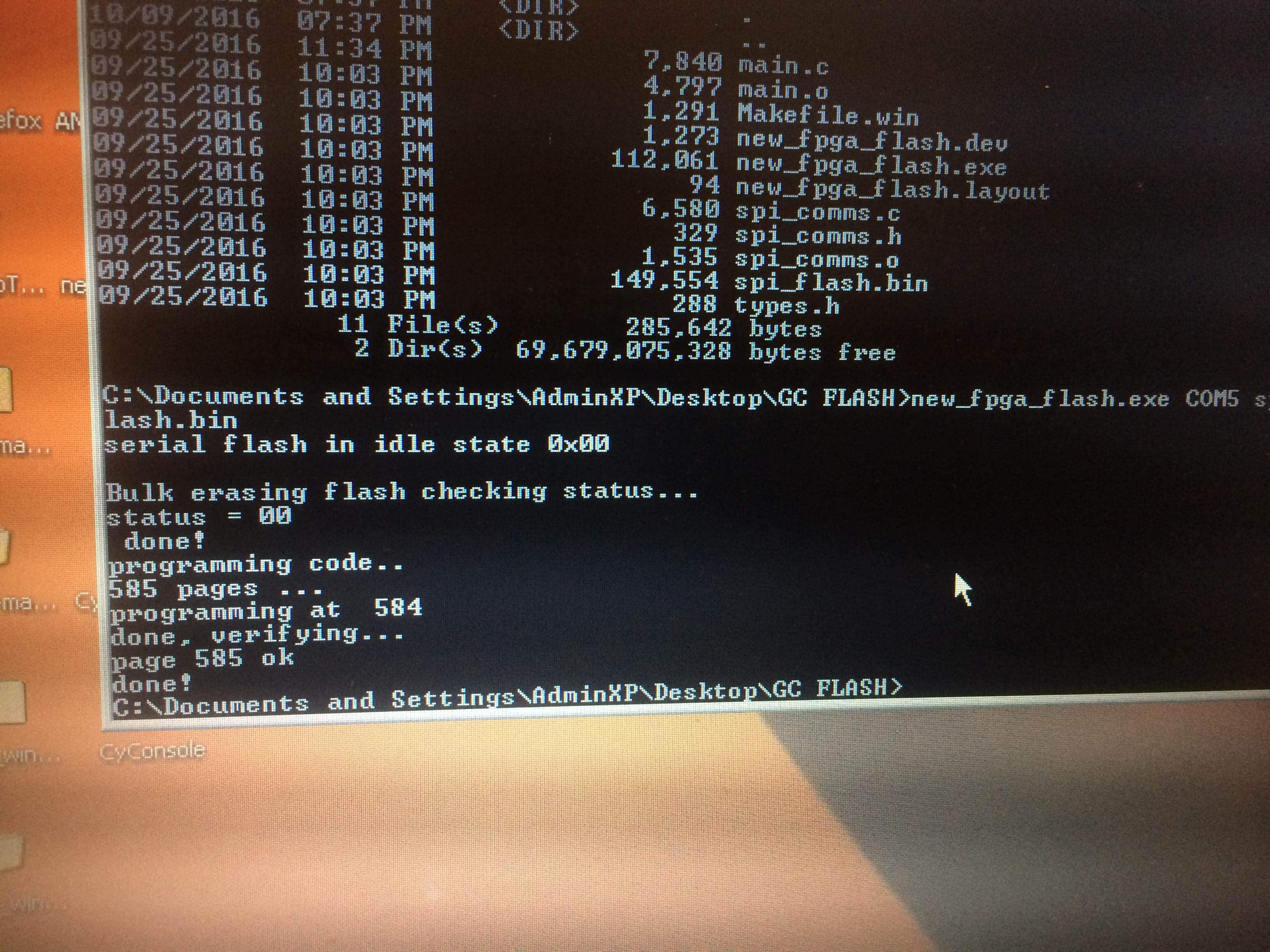

Still no verify success. Address results change too. Starting to wonder if my "old pc" is odd. The northbridge is an nforce 2 ultra, so the southbridge is one in that really old nvidia chipset series. I then tried another parallel port. A 1x pci-e card in my 1st gen i7 system. I bound a Windows XP VM to use it (since the host is Windows 10), and it had parity errors.

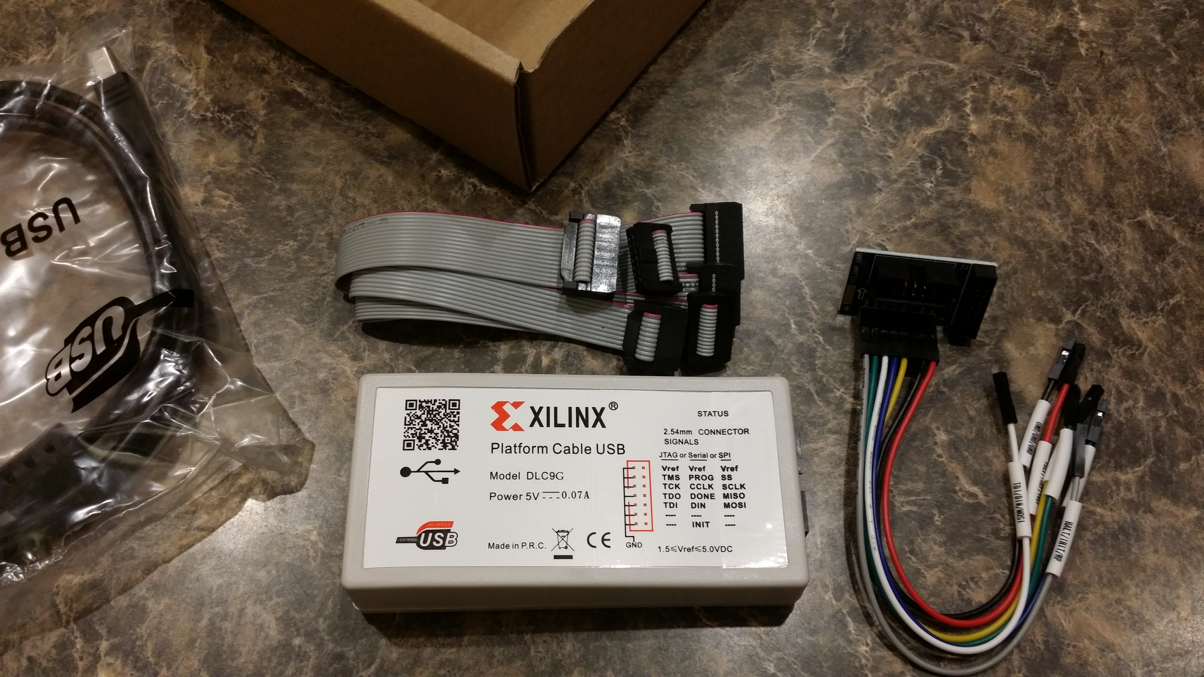

Anyhow, I ordered a xilinx programmer. Noticed it did not have any LED's on it. Is this one "less cool"?

Connected my programmer. Followed steps from Xilinx documentation, linked earlier in this thread. I was able to make the proper .mcs file, from the original .bit file. Using gcvideo-dvi-shuriken-v3-2.3.bit
Once loaded up, Flash fails to erase.

Your pictures showed you using a Xilinx programmer. So I bought one too. I asked about where you connected your programmer to, because it only dawned on me last night, that direct SPI programming might not be done through the JTAG connection. Your earlier posts showed using JTAG. I have been maybe misunderstanfing that direct SPI programming, was when you right click on the SPI after initializing the chain from a boundry scan. I never could sucessfully erase or program this way.
Yesterday I recalled someone mentioning connecting to the 6 pins by U2. I realized I could connect my Xilinx programmer to there instead. I could not do a boundry scan now, since it's not hooked up to JTAG this way. So I manually added an SPI under the menu option "Direct SPI Programming" and it was able to erase, verify, and program sucessfully. JP1 was closed with this method. Not when using JTAG though.
I did as you, and just traced the corresponding pins to the the flash, from the 2 rows of pins by U2. In my case I am using impact and a Xilinx programmer. So my software only liked .mcs files. Not sure how to make my programmer use a .bin file. Do you think I programmed it right?
