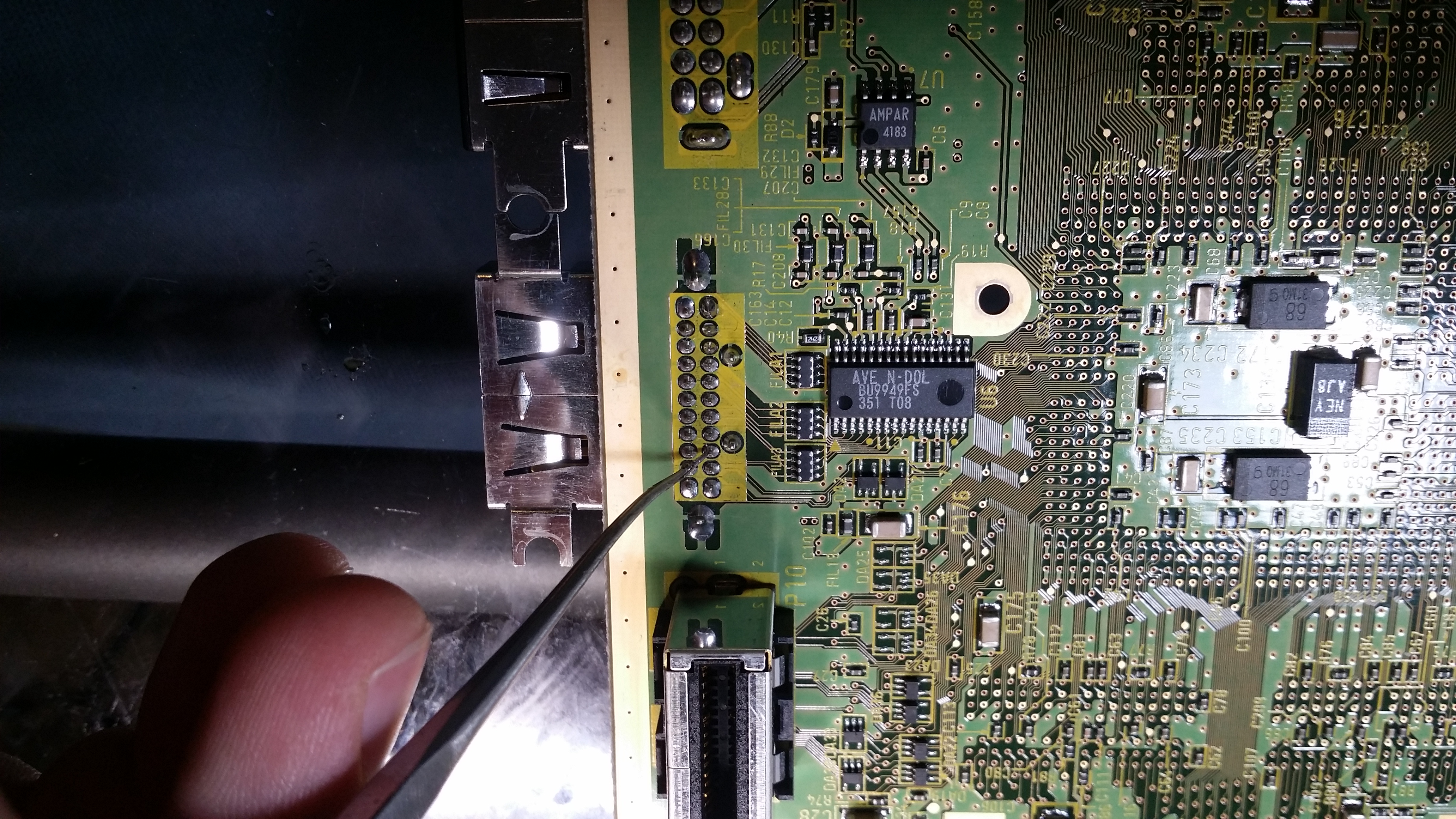

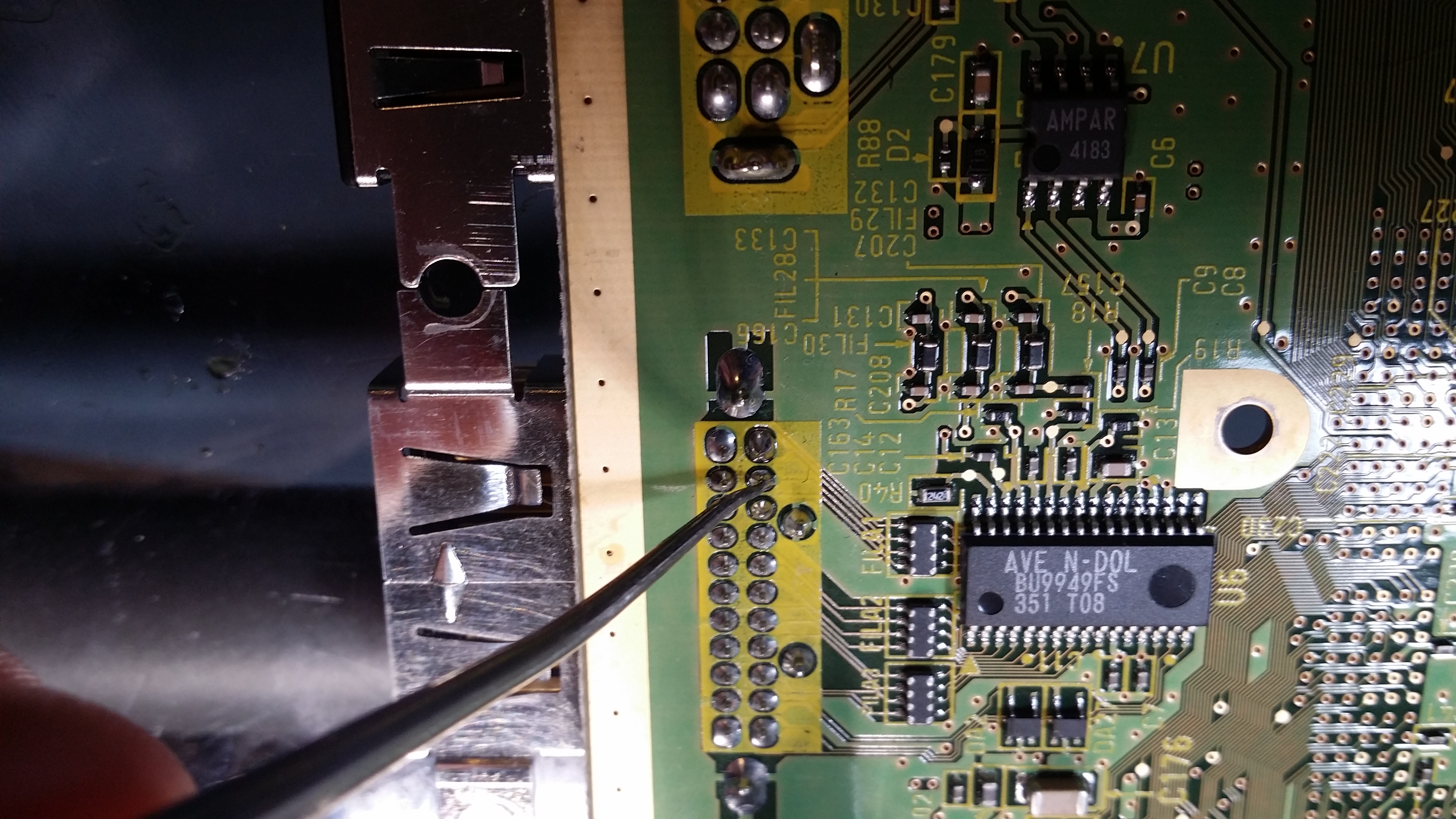

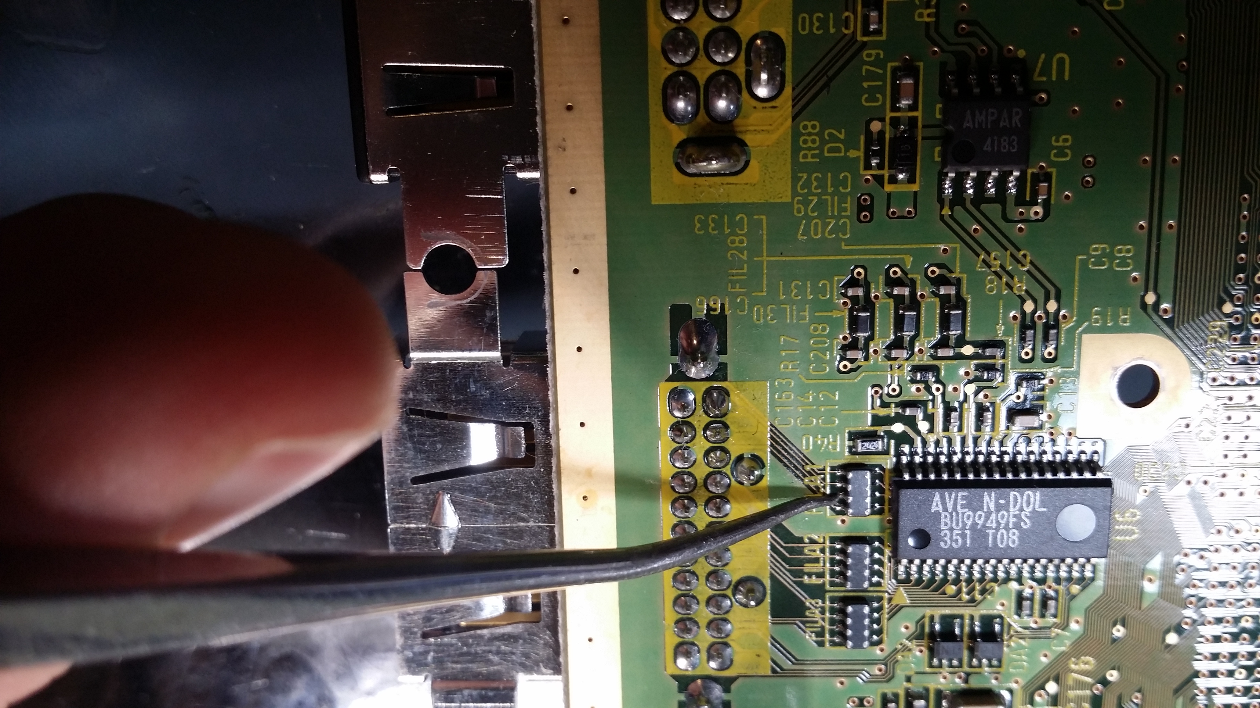

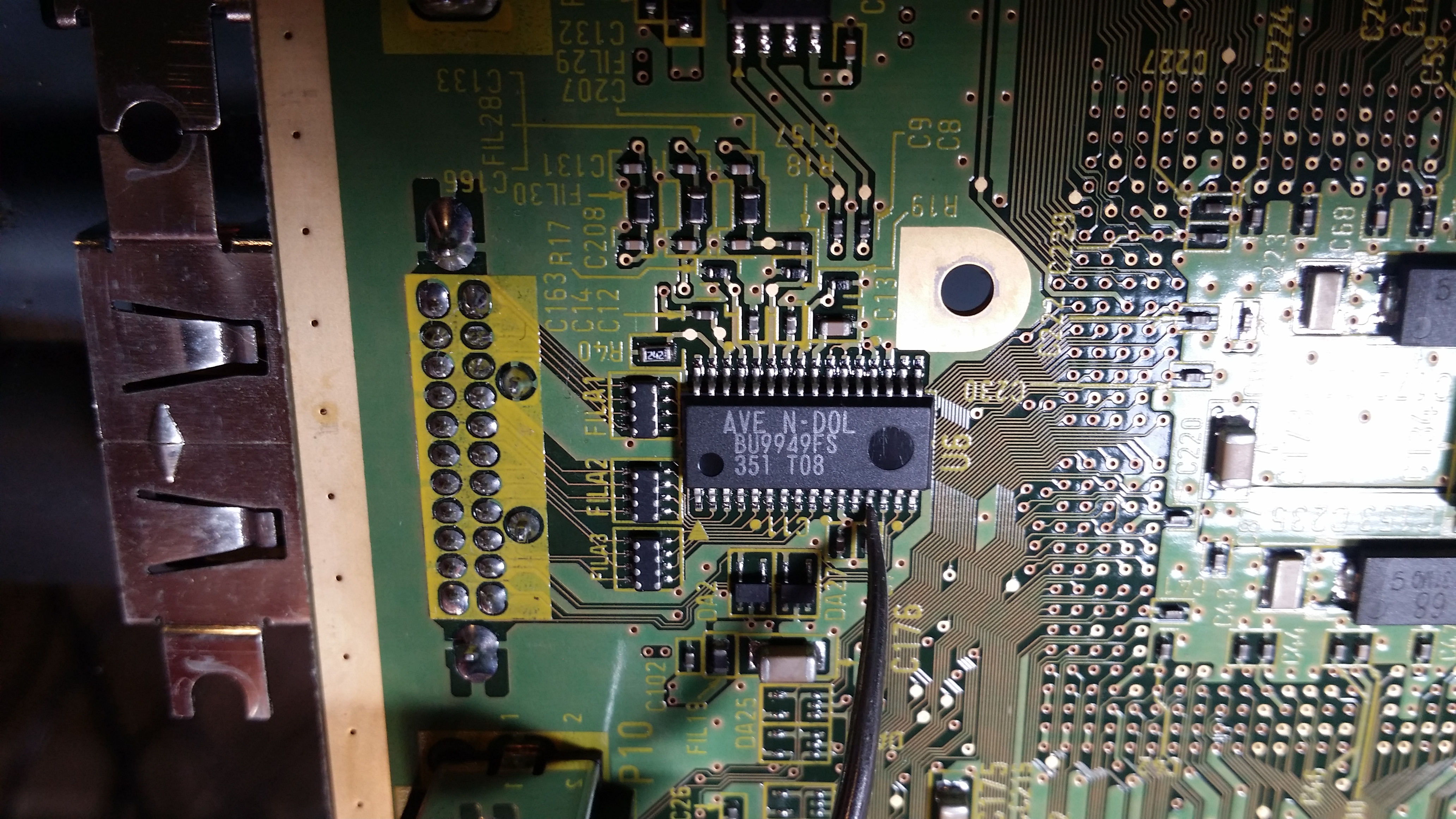

Possibly related, but I can not be sure. There are 2 pads on the underside of the Digital A/V port, that seem to be easily damaged when removing the original port, for the Shuriken. These two points were damaged on one of my Gamecubes, and they disabled the video. I ran jumpers from them to points on the Gamecube mainboard, and it repaired them. I do not know if they would fix the voltage issue, but these are at least 2 points that I can help you check.
Check if this...
1a
(3.59 MiB) Not downloaded yet
Reaches this.
1b
(3.23 MiB) Not downloaded yet
Check if this...
Reaches this.
Then check if this...
Reaches this.
Hello, thanks for the advice, but that wouldn't be the issue for me figuring I kept the digital av port intact and just had wires going from the connector itself (it's my test GCboard). So nothing like that could of happened.

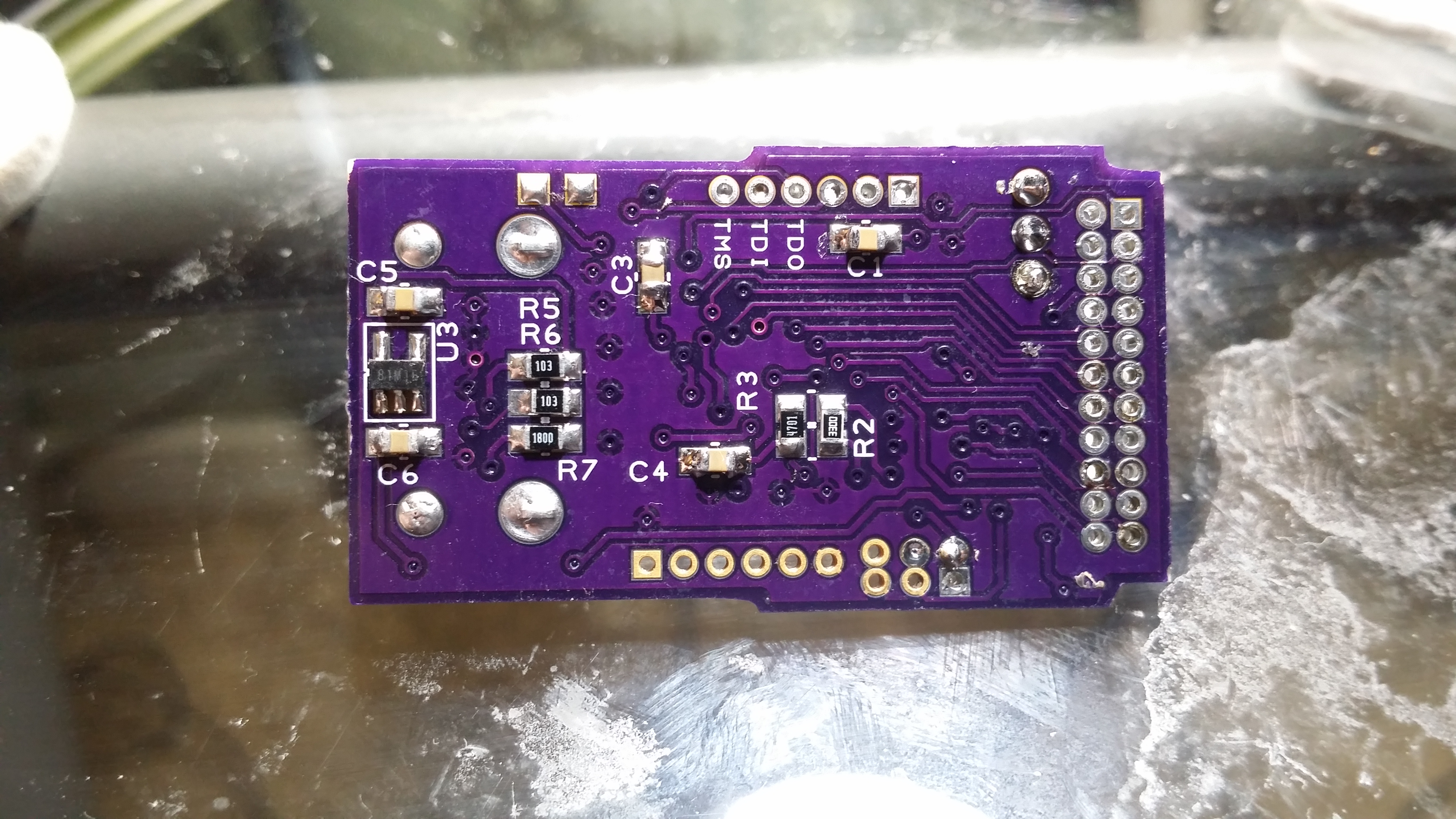

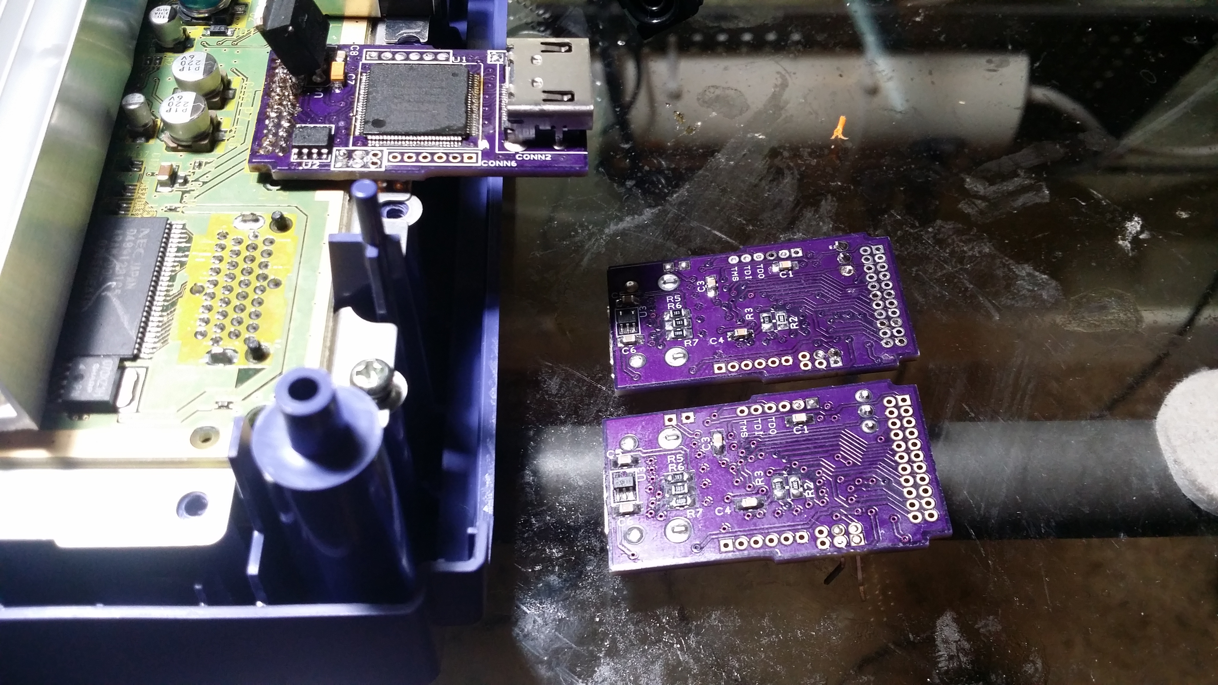

This is a dupe that I posted on assembler, but it does complete my comments in this thread as well.
@happy_bunny
I have a working Shuriken V3 tonight.
(2.53 MiB) Not downloaded yet
My problem from day 1, was physical orientation of the direction for R2 and R3. I fell for the same mistake on each board I built. Please review below.
My brain coasted over R2 and R3 for all 3 Shruiken V3's that I built.
(2.87 MiB) Not downloaded yet
(3.08 MiB) Not downloaded yet
I believe that I can see what caused my brain to be tricked. The orientation of the Text for every Resistor and every Capacitor, matches the direction of their corresponding component, except for R2 and R3. Their component is horizontal, while their text is vertical. A lame excuse I am sure, but as you can see I fell for this simple oversight 3 different times, each spaced weeks apart. I did not build each of these on the same night. Nor did I refer to my previous work. I just sat down on separate occasion and assembled them.
So it is of course up to you, but I would recommend rotating the orientation of the text for R2 and R3.
I believe this explains why I failed to program via JTAG, and why pin 54 never went high after Direct SPI programming. I was absolutely mistaken when I claimed it went high in an earlier post.
I am looking forward to finally moving forward and trying this out. Thank you for all of the help between this thread and other places.

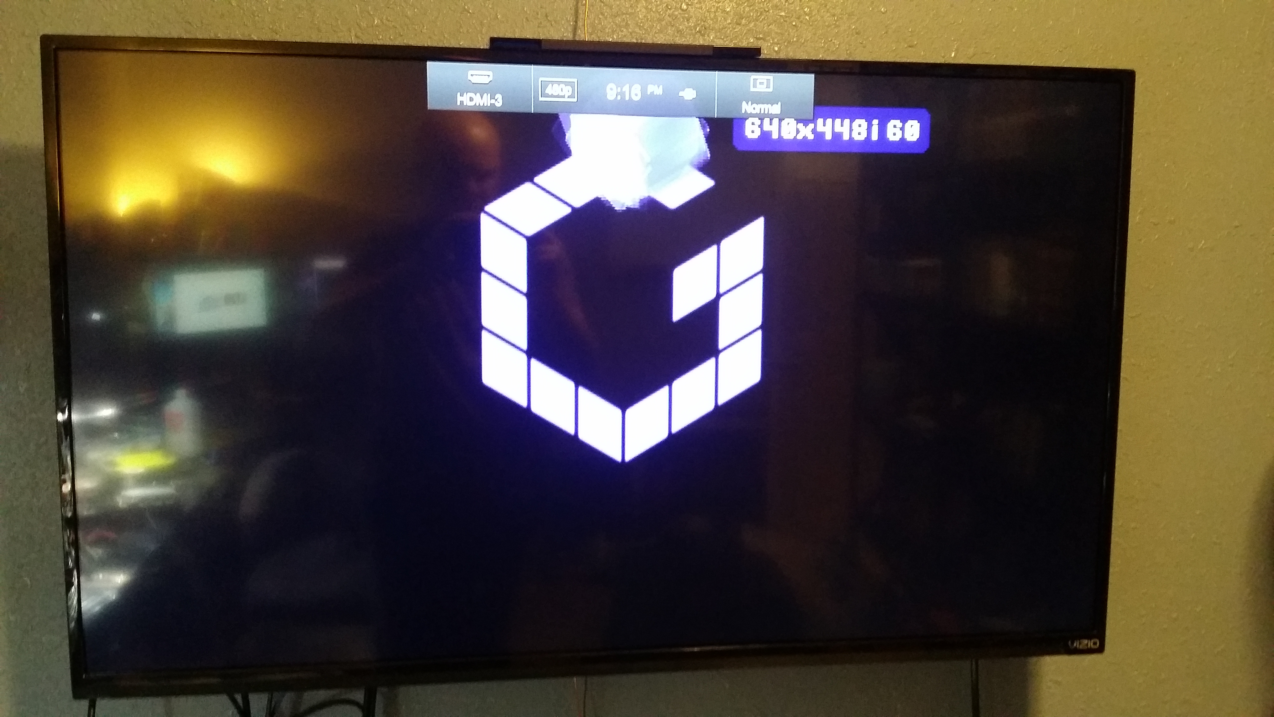

Hey guys I have been away for awhile in trying to make a successful, working Shuriken V3 board. I made another board and same result... 2.2v on PIN 1. What am I doing wrong I don't understand?
1. I double checked the components used, brand new from Digikey, stenciled the board with solder paste,
2. Reflowed the board with my reflow oven. Physically everything looks good.
3. Used my magnifier, did not see any bridging.
4. Programmed the board by powering it 3.3v and GND, LCSOFT method. Programmed and verified as stated in the command prompt window.
5. Connected the board to the gamecube. When I power on the GC and plug in HDMI, it shows its detected on my TV, but no signal.
6. Pin 1 reads 2.2v and I do not know why.
7. I tested for 5v from the 12v to 5v reg, as well as the 1.2v reg. Both are fine.
Could it be the actual PCB board itself is messed up? This is my 2nd board and same result...2.2v. Should I program the Shuriken video board with it connected to the gamecube? (and have Pin 1 disconnected I believe).
If anyone can help me out I would GREATLY appreciate it. Thanks!

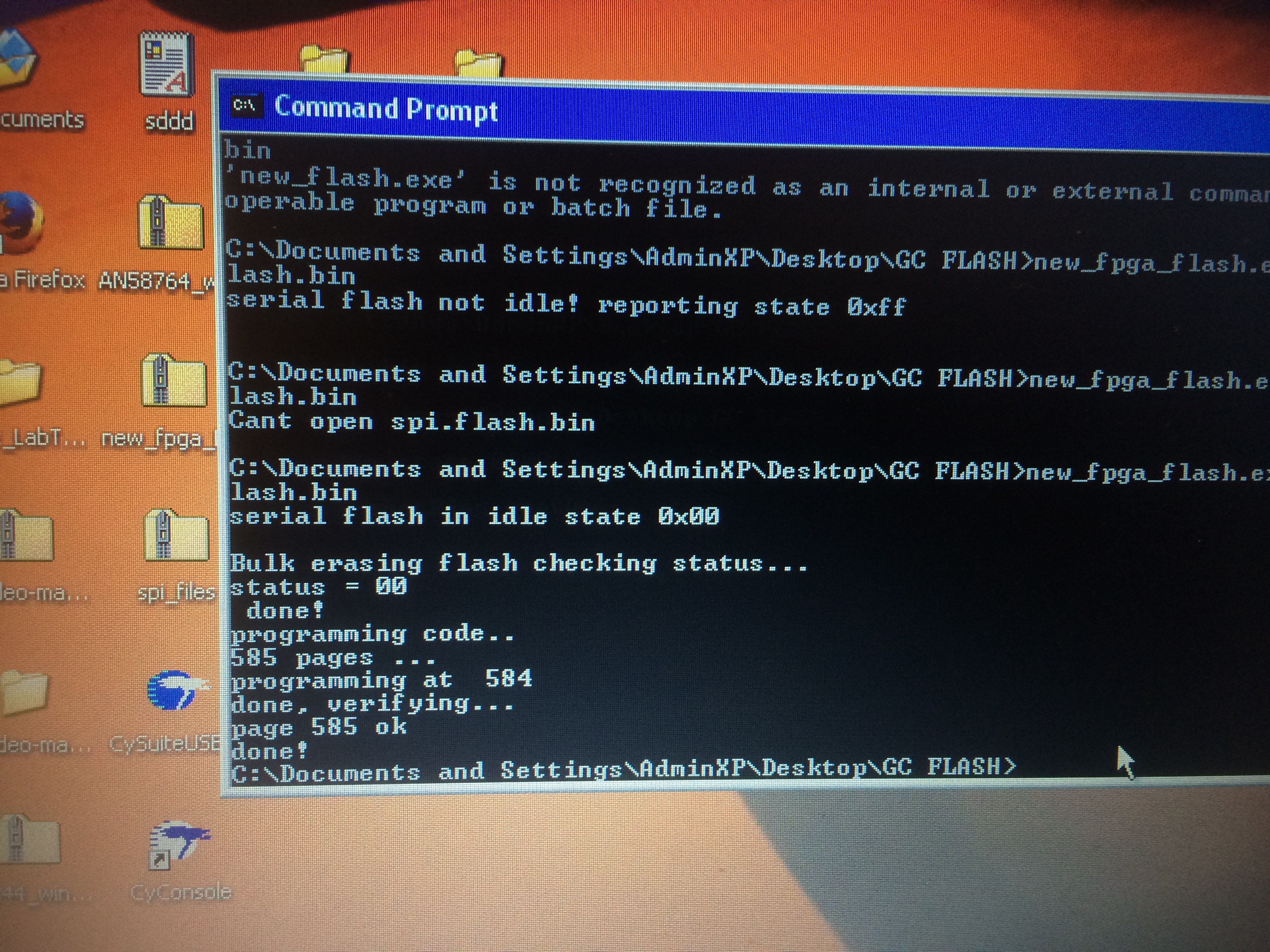

No I know what you mean. I followed the LCSOFT method direct SPI programming that happy_bunny mentioned. I have a pic. This is the s200a chip, not the 350a chip by the way. He emailed me the bin file, maybe I can try to make my own with the latest GCvideo. Pic of programming:
I will check PIN 54 to see if I get 3.3v. I will check both with powering it separately and then connected to the gamecube. Anything else you or anyone here can think of? Thanks!
