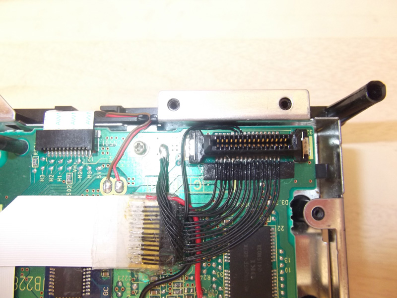

I've been trying to get a WODE and the original DVD drive to work in parallel on a switch for the last week with little success.
I tried putting a switch on the 5v and GND to switch between the WODE and DVD drive and left all the data pins from both connected in parallel thinking that without power and ground to one or the other that the data pins still being connected would not matter. Seems I was wrong though. Somehow even without power and ground to one or the other the data pins are still conflicting somehow.
I also tried disconnecting one data pin at a time on the WODE side to see if it might be just one or two data pins that were conflicting. I managed to get it working at first with 4 data pins disconnected, which would be do'able with a switch but then it crashed ingame on a few games that I tested.
So it seems at this point I either get rid of the DVD drive which I was hoping to keep if possible or find a double throw switch or relay that can handle all 18 data pins, if something like that is even available.
Just wondering if anyone else has tried this or if anyone has any advice on switching between the WODE and original DVD drive.

I Finally got around to trying the GC drive connected to my WODE via Flat-Wode and the first results are promising. I managed to boot an original disc and because I put disc 2 in first by accident it even swapped discs without any trouble.
I played the game for a few minutes and it played fine although the loading seemed a tiny bit slower but you would have to look really close to notice it. To be honest I haven't seen the game running on a stock GC for a long while so maybe it is like that normally. The second time I tried the game it got a disc read error just before a cut scene but that could be my laser or pot at fault, need to do some more testing to find out.
Unfortuanly it doesn't seem to work with backups, not sure why though, surely patching of CC backups would be no different on the Wii than on the GC, would it?
Maybe if I installed a XenoGC on the drive it would patch the drive itself and then the WODE would see the backups as originals?

I managed to get originals working fine without any disc read errors by installing a new laser and turning the pot down to about 160 ohms, any higher and it would not be long before getting a disc read error.M tha MaN wrote:Anything new ?
I'm very curios =)
I then installed the XenoGC and found that I had to turn the pot down even more than before just to get originals to work
The Xeno doesn't seem to have any problems patching the drive as indicated by the LEDs on the Xeno itself but as of yet I Cannot get any backups to even boot up.
I'm a bit worried about taking the pot down any further incase it burns out the new laser but in the name of progress I'm going to go ahead and try it anyway
To be honest I am just glad that originals work fine via Flat-Wode. With the WODE now installed I won't need to burn backups to disc again anyway.

I still can't get backups to boot via Flat-Wode or Flat-Wode + XenoGC. I turned the pot down as low as I could, about 40 ohms.

I'm still wondering if it could be that the pot is a little too high even at 40 ohms. My old GC with XenoGC would read originals with the pot upto about 350 ohms but I would have to take about 170 ohms away from that for it to read backups.
With Flat-mode + XenoGC the pot needs to be at about 160 ohms on this GC just to read originals and if I go by the same rule as before and take about 170 ohms away from that it would take the value way below the 40 ohms that I tried.
I could not get the pot to go below 40 ohms as it is quite sensitive and even the slightest turn would loop back to just below 1K ohms. Lucky for me though it seems that 40 or even zero ohms is not the limit due to the 150 ohms resistor in series with the pot. Looks like I'm going to be taking that pot even lower than before

Good news, I got backups working with Flat-mode + XenoGC
I took the pot down to what would be -20 ohms under normal cicumstances, obviously I had to take the 150 ohm series resistor away to achive this. So now if I'm making any sense the pot is actually at 130 ohms where as under normal circustances it would be 130 ohms + the 150 ohm series resistor.
Also the Wode seems to see the backup that I tested as an original and even though the backup is out of region for my console the Wode does not try to region patch it.

nice work, I wonder if it's specifically your drive/setup that needed the ohms changed so far back (to what would've been negative). That audio fix list looks complete to me, and if anything was missed I'm sure it probably wasn't even worth playing
Can we see some pictures of your setup/connections? or have you posted it somewhere else on the forum I've missed?
Re: Has anyone tried connecting a WODE and DVD drive in para
I also wondered if it was something to do with my setup because at one point I was taking the WODE's 3.3v and 5v from the drive board plus a XenoGC which I thought may have been draning power from the laser hence the low pot setting but I have since disconnected the 5v and relocated the 3.3v to the main power connections on the motherboard and it made no differance.emu_kidid wrote:nice work, I wonder if it's specifically your drive/setup that needed the ohms changed so far back (to what would've been negative). That audio fix list looks complete to me, and if anything was missed I'm sure it probably wasn't even worth playing
On another note, strangely enough I could not connect the 5v source to the motherboard without it draining all power from the DVD drive and the LED above the controller ports but all 3 work fine when it is connected to the drive board.
I'll take some pictures tomorrow of my setup/connections and post them so you can take a look.

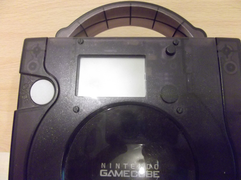

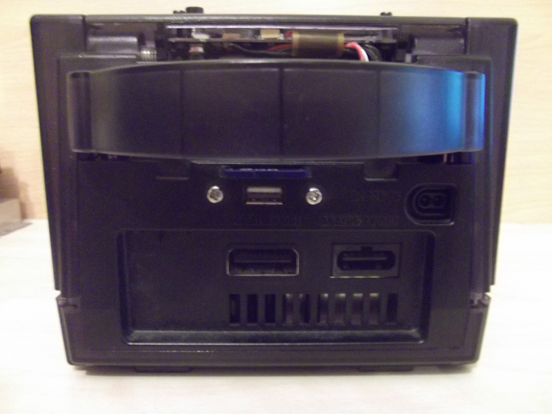

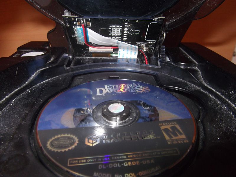

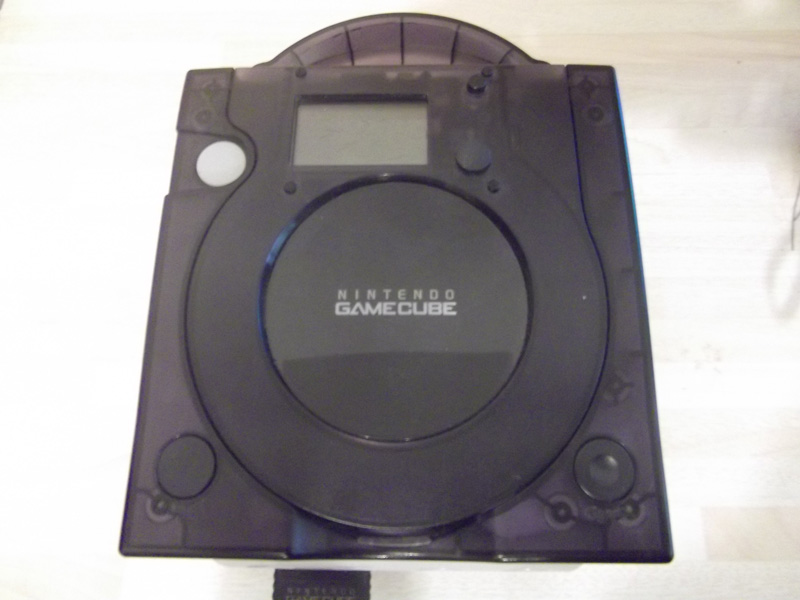

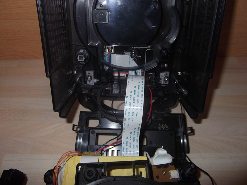

Here's a few pics of my setup at the moment. It's a bit of a mess at the moment as I didn't want to finalise too much before fully testing. I had to sqeeze it all together to get the full case picture
The Gamecube from the top
The back panel with USB and SD card slot and a extra switch that I didn't need in the end
Close up of the WODE screen with joystick and eject button above
Inside of the lid. Should have cleaned that dust before taking the picture
Indside the Gamecube. Metal shield needs to be replaced under the DVD drive

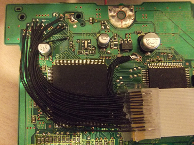

...Continued
Connections from WODE to GC via the GC DVD connector.
Conections from WODE to GC DVD drive on the back of the DVD board.
I've also done some pictures to show pin numbers for the front and back DVD board connections and which traces need cutting, just need to finnish them and I will post them for anyone that wants to give it a try.
