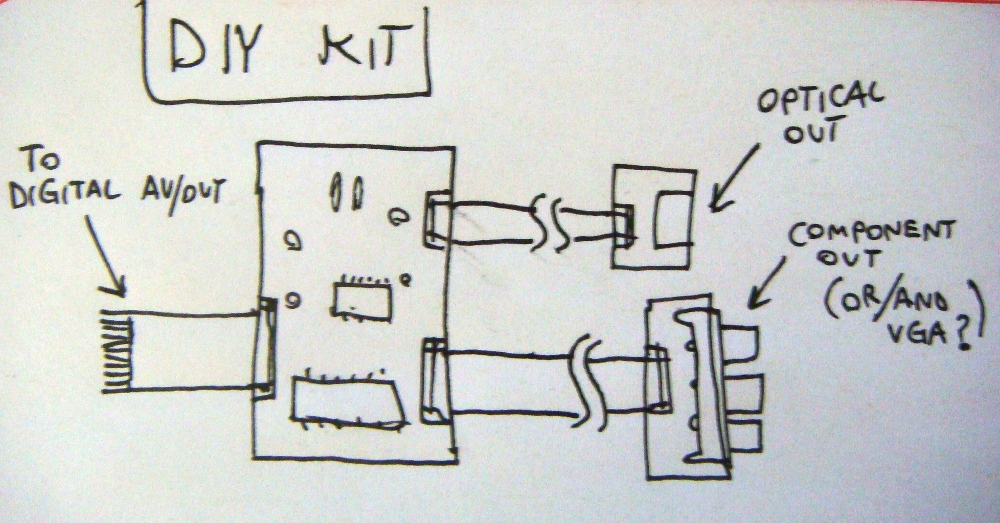

Due to the nature of this project, i'm sure it's hard to make a final product which suits the needs of most end users.
I propose two approaches: a diy kit and an internal finished mod.
The DIY kit
the main circuit could be the only fully assembled component, the kit would contain all the remaining components that would be assembled as the user seems fit.
that way it could be made as an internal mod, an external box, in a floating baloon... :mrgreen: almost anything.

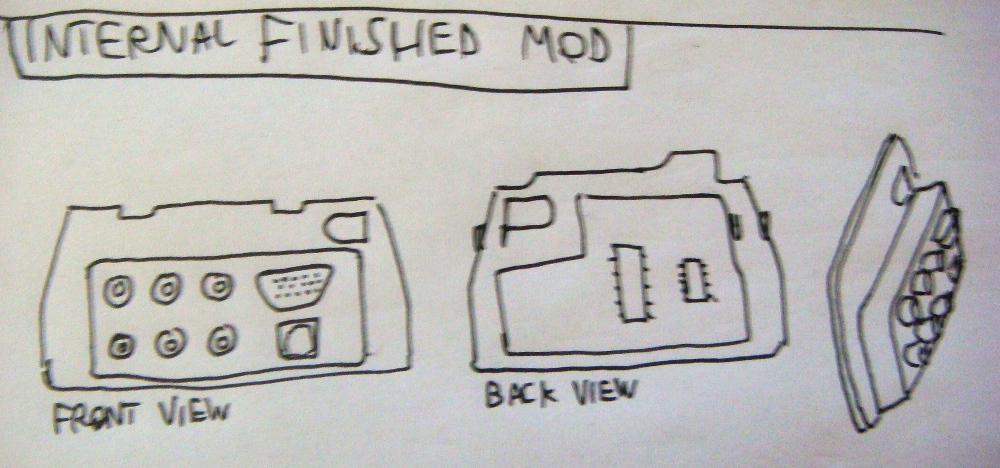

The internal finished mod
I just had this idea, get the back piece of the gamecube casing and modify it so everything fits there, it could be a very easy way to install the adapter, but of course, how it will be wired to the digital av port remains a very difficult task for the average modder.
I've attached two drawings explaining my ideas.
And of course, please sign me up for any final product you end up making :D

iggunr wrote:Due to the nature of this project, i'm sure it's hard to make a final product which suits the needs of most end users.
The DIY kit
as for a DIY kit, i plan to test every board before selling to ensure no quality issues, video issues, audio issues...
so all components will be assembled... no resistors, caps, etc in a little bag, i do not want to stay up at night and wonder if something i sell might not be working..
as for your pictures, they are not toooo far off from what i have been planning...

Post by megalomaniac » Fri Jan 06, 2012 3:44 am
Hucklebuck wrote:If the mod would fit inside comfortably that would be great! Optical audio is a great idea too.
If this was made internal would you be able to have a Wiikey Fusion or Wode installed still. Like will there be enough room?
Definately put me down for one of these! :geek:
comfortability is based on individual perspective...
but i would not design an internal board that wont fit...
you will more than enough room to perform a WKF/Wode mod...plus, once the disc drive is removed, you might be able to fit an internal usb hdd...
