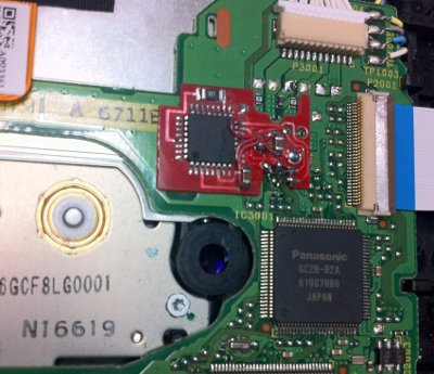

Now, the kick in the pants part of this is when WKF is OFF, it does not allow backup DVDs, so only original discs can played. The solution, add a wiikey v1 to the DVD drive to patch the drive allowing backup discs to be used...Now the wii/GC will see the backup DVD as an original...
WKF CONFIGURATION : OFF, ON, ON (ALL), ON, ON + wiikey v1
Audio Streaming from DVD:  MegaWire Mod works to bypass the WKF block
Originals: WORKS
Imports:   WORKS
Backups:   WORKS
Homebrew:  WORKS
all discs work and audio streaming works...
of course i did not have a wiikey v1 so i had to make my own
(36.99 KiB) Not downloaded yet

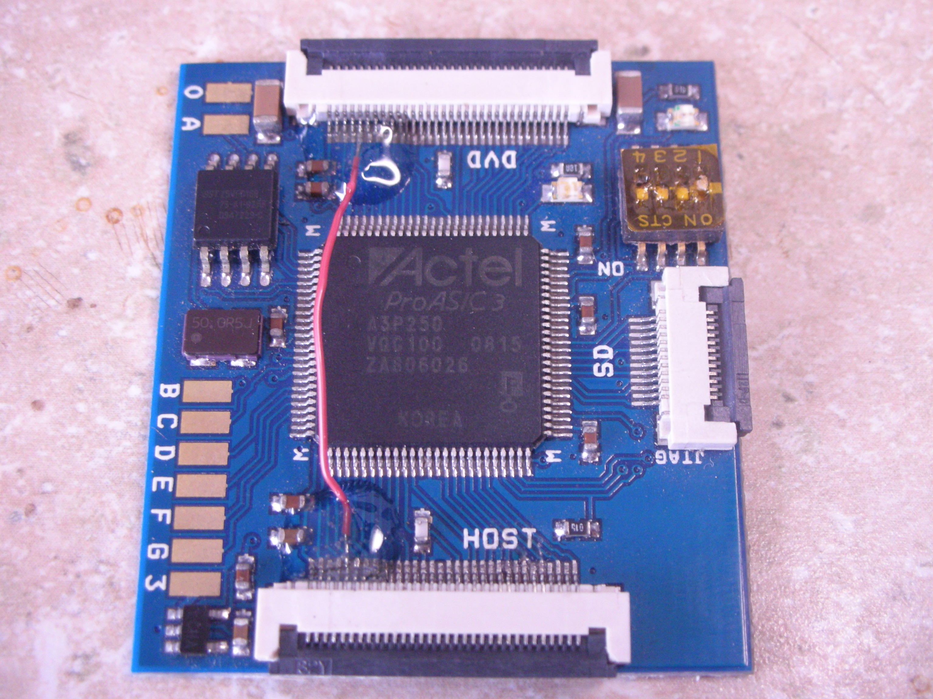

here is what my megawire mod looks like on the WKF...
instead of opening the wii and tearing it apart a lot more to access a solder point, i just soldered the wire directly onto the WKF...
(1.93 MiB) Not downloaded yet

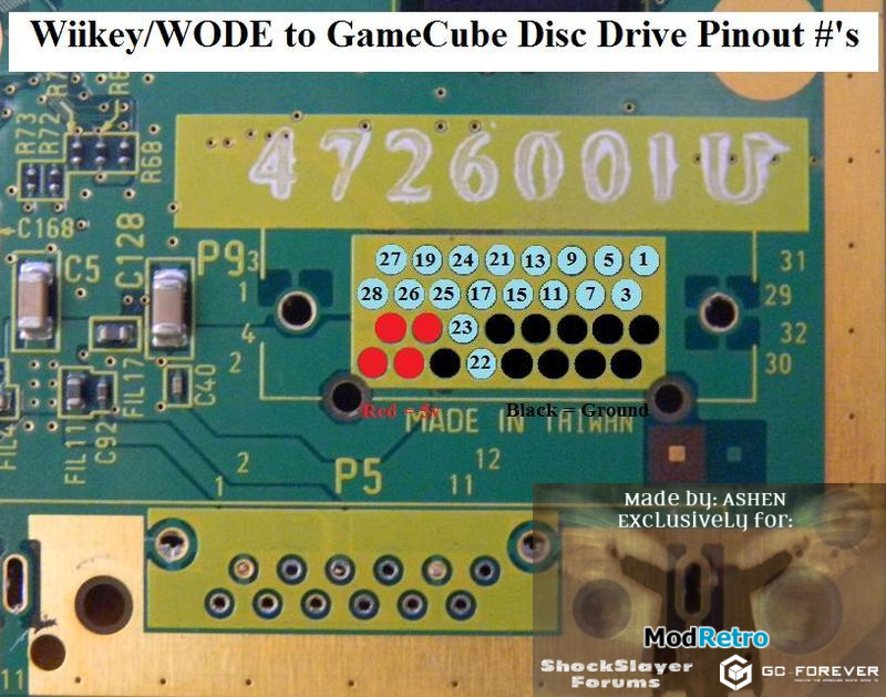

I'm wiring my MegaDrive with wires rather than sliding it on the DVD pins. Do I only have to wirethe numbered ones from this diagram from DVD pads to MegaDrive or all 32?
(1.1 MiB) Not downloaded yet
Formerly Mizumi
Post by megalomaniac » Mon Jun 03, 2013 6:36 pm
Numbers + 1 red + 1 black
