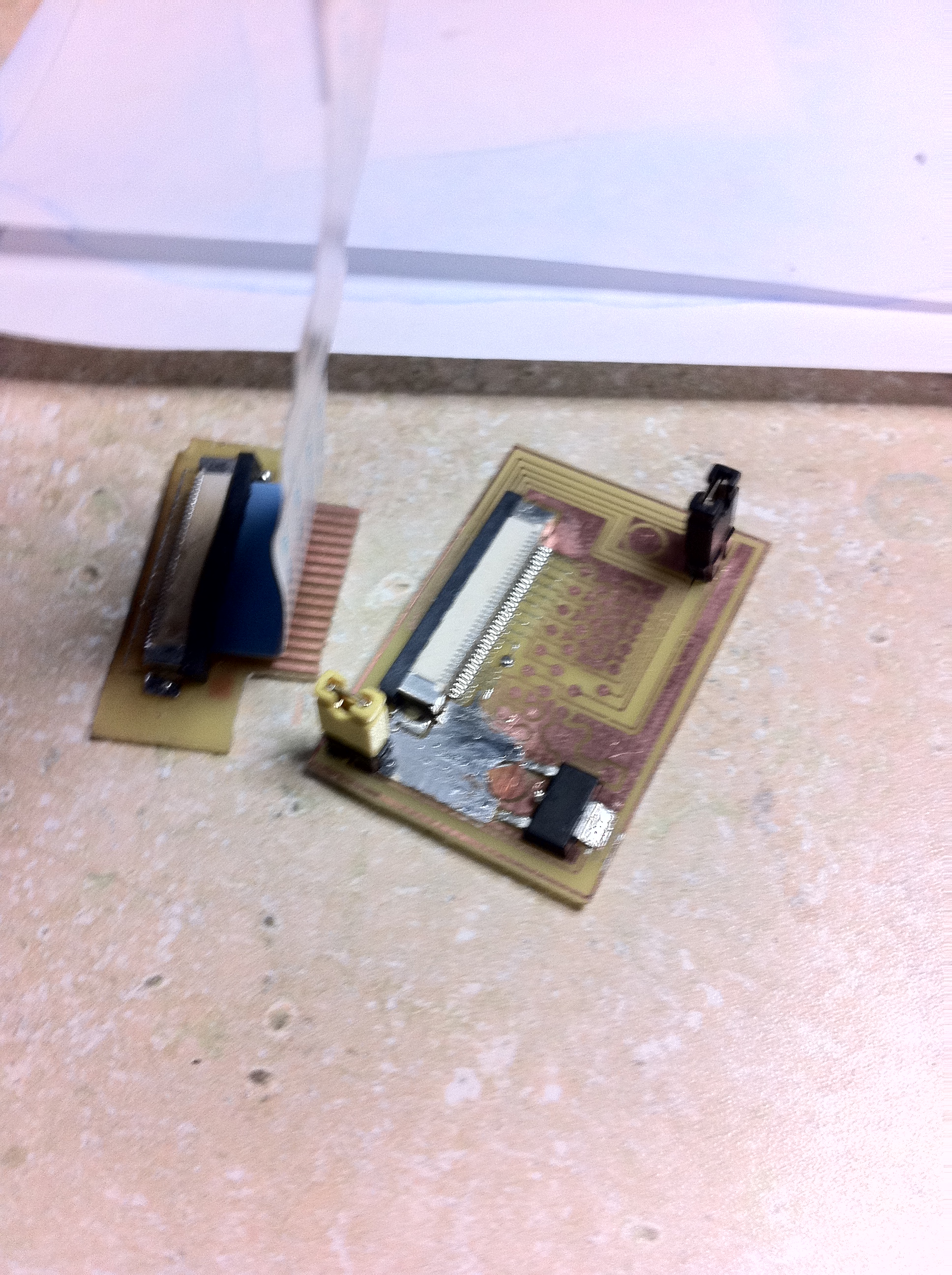

quick look at the prototype boards....
- (1.94 MiB) Not downloaded yet

i had great initial testing to confirm the following:
1. DVD Port Replacement pinout / design is accurate and works as expected with WKF....(wode is on order and will arrive next week)
2. DVD Drive Insert pinout / design is accurate and works as expected when plugged directly to the replacement port.
based on the success of these initial tests performed thus far, this project will is evolving as expected...
at the moment, i only have one ffc cable and not able to connect all three at the same time...once the wode arrives i will have another ffc cable available to continue further testing and confirm final results...
still playing around some more...
ive managed to update my WKF from 1.0 original firmware to 1.5 and flash a failed swiss, recovered WKF and reflashed swiss again....
so far this adapter is fully functional in all aspects...
my wode is expected to arrive Friday Nov 9 at which time i will have the extra ffc cable i need to continue testing....
i must say, this is working super great with no errors so far...
i cant wait to have the final production version on hand...

here is a quick pic of my testing conditions....
yea wires.....why? because i am not gonna drill 0.5mm holes x 32
so i made a larger version of the replacement port design that has the exact same layout and connections....but a lot easier to make at home and easier to work....
so ignore the wires as they will not be required for production version...
the blue wires are are from the mainboard to the DVD REPLACEMENT PORT ADAPTER
the orange wires are wode power...note: all required wode power available on the DVD REPLACEMENT PORT ADAPTER (12v not required)
FFC cable from DVD REPLACEMENT PORT ADAPTER to WODE MAINBOARD
FFC cable from WODE MAINBOARD to DVD INSERT under the GC drive
red cable 5v power to GC drive
disc is spinning, initialized, and ready to play...
STATUS:
WODE VERIFIED, READY FOR USE!!!
WKF still testing
