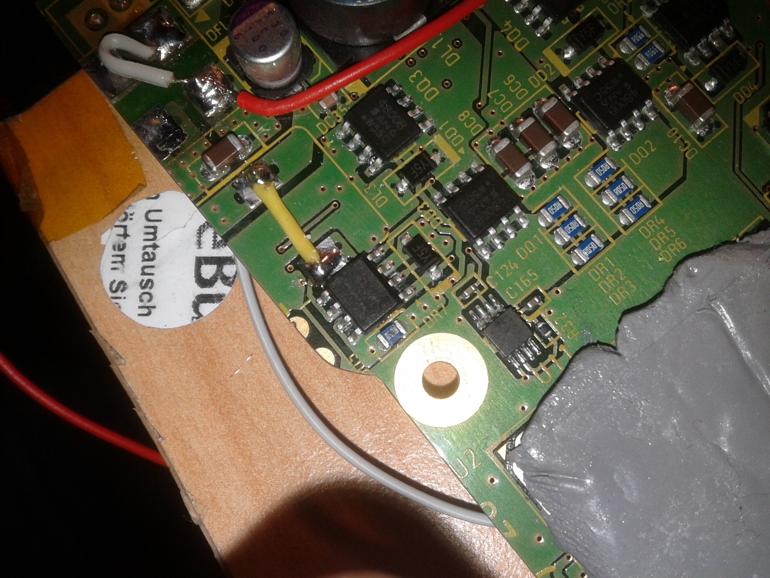

.. I guess my project died today... i wired everything up to test the wiikey... Power on - Nothing happend..
then i saw just a little bit of smoke comming out of one part... (see pic, it's this blue DR7 thing in the middle)
It's just glimmering for a half-second and that's it... no idea what this part is.. resistor?
It's connected to 12V on both sides... i removed everything except the FFC Cable from the wiikey..
I trimmed the psu just a little bit, like this: http://forums.modretro.com/viewtopic.ph ... &start=130
But i only removed the 2 coils that would normally be on that picture.
I guess i just killed it..

Bummer, I hope nothing bad happened to your Wiikey in the process. One thing I've learned is to test the motherboard after every step. Never test multiple modifications at once as its so much harder to pinpoint where you've gone wrong if something bad like this does happen.
New board and try again I hope? Don't give up!

EDIT: btw. this thingie should be a resistor, as you said.

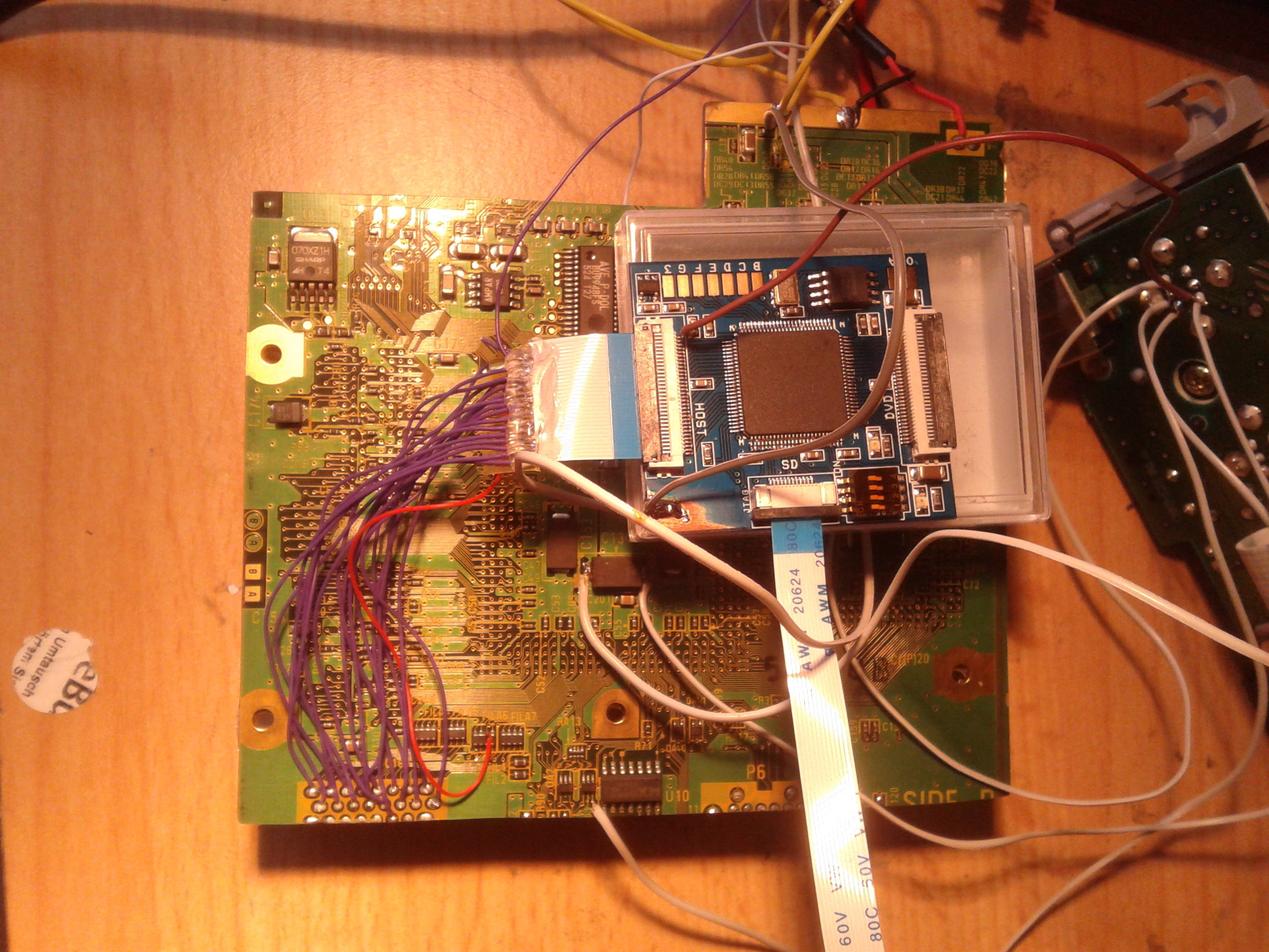

Sooo..
Trimmed down new DOL-101 board.. And it works :)
I didn't trim that much this time, because i now know how big the case is i'm using..
/EDit:
Just installed WKF.. it's getting recognised, blinks blue if i press the pin 29 button but nothing happens :/
Gamecube dosn't show any game... i formated the SD with WBFS and did only put on the Ver. 1.5 Update on it :/
Guess i need to check my wireing/adapter -.-' ..
"Disc could not be read" ... yea.. guess need to check wireing -.-''''

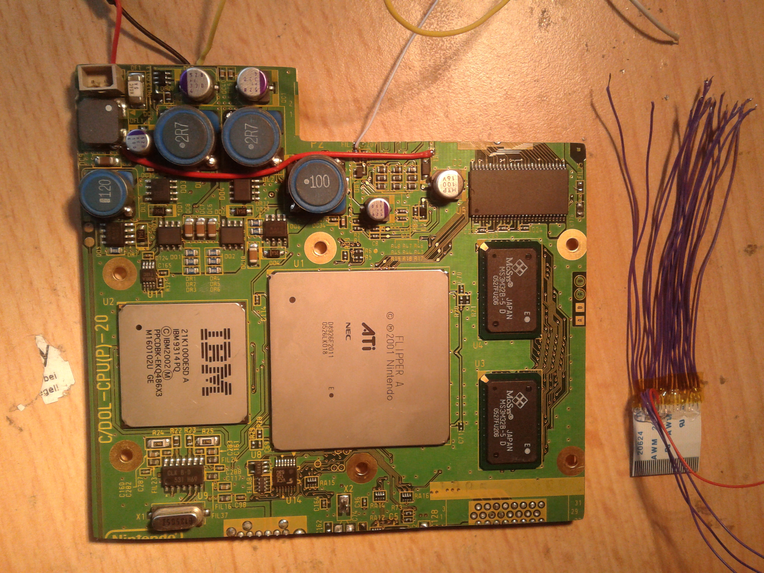

//Edit 2:
Problem found! One pin was connected to gnd -.-
Now it's directly booting into the wkf-menu, but then seems to freeze.. can't start the update or move the arrow :/
//Edit 3:
i booted the wkf-recovery and noticed that it dosn't freeze.. it just dosn't like my gamepad xD
Don't know why.. it works fine in the gc-bios :(
...... F*** it.. just read that this is an compatibility issue... (my?) DOL-CPU-20 is not working with WKF....
This is really starting to become a mess.. guess i need yet another mainboard.....
Source: http://forums.modretro.com/viewtopic.ph ... &start=120
WKF installed but faulty?!
(1.77 MiB) Not downloaded yet
New Trimmed board
(1.82 MiB) Not downloaded yet
