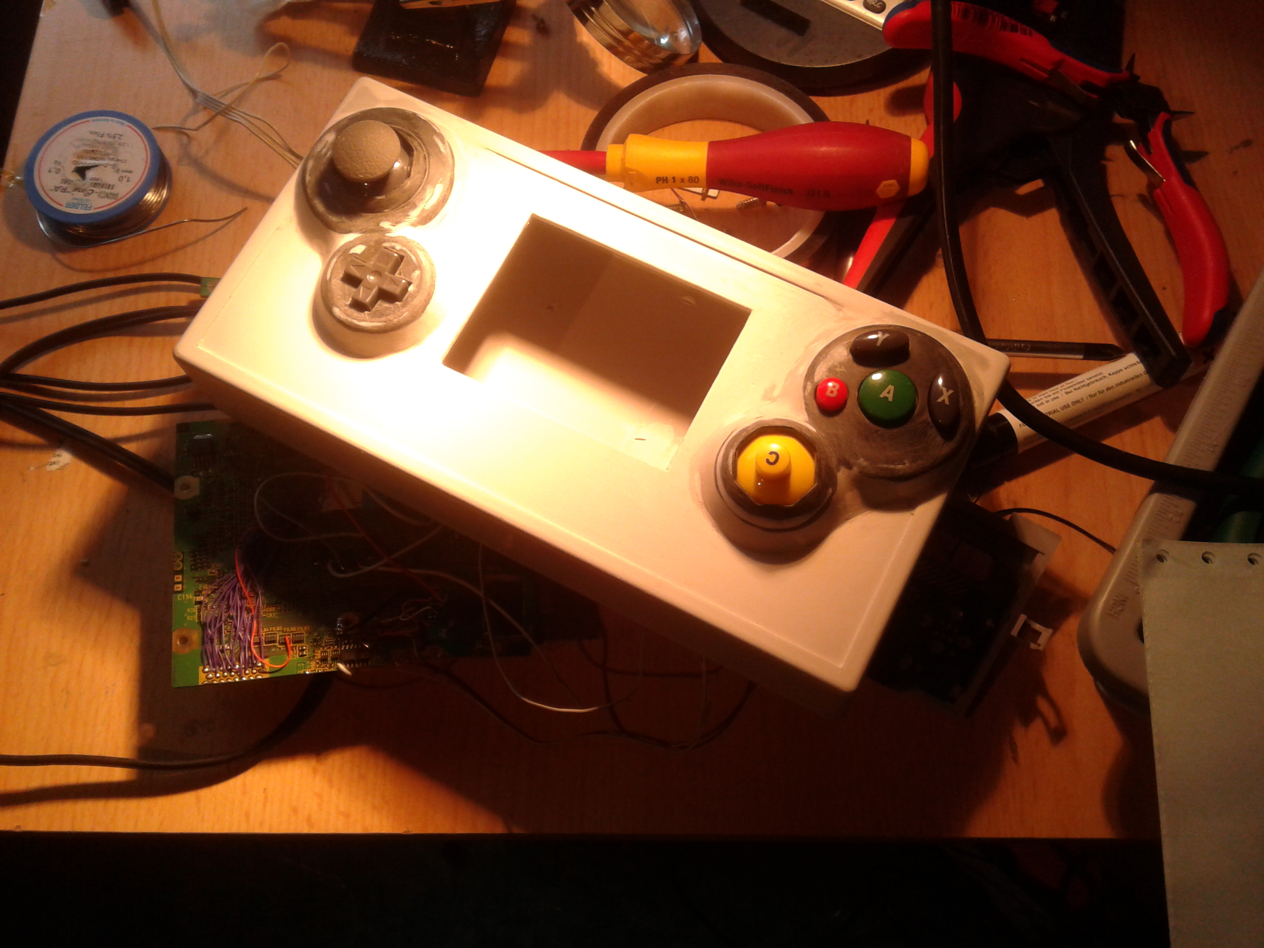

So to come back to topic i just bougth another Gamecube.. but this time it's DOL-001! ;-)
So i hope everything will work now.. and since i can make a smaller cut, it will fit much better into the case :)
Here is a pic of the case so far: download/file.php?mode=view&id=596
i like it pretty much ^^ but will have to do a lot more on it :/
next step would be the shoulder buttons... as i said i did a cut into the case for them.. but now i don't know if i should bend them to the inside or outside :/

Post by emu_kidid » Sun Apr 29, 2012 3:05 pm
that is looking very nice, I wish I could do just as good! Your C-Stick is upside down btw ;)

emu_kidid wrote:Your C-Stick is upside down btw ;)
yea, i know xD but i only did realize it after putting them in and i was too lazy to take them apart again ^^

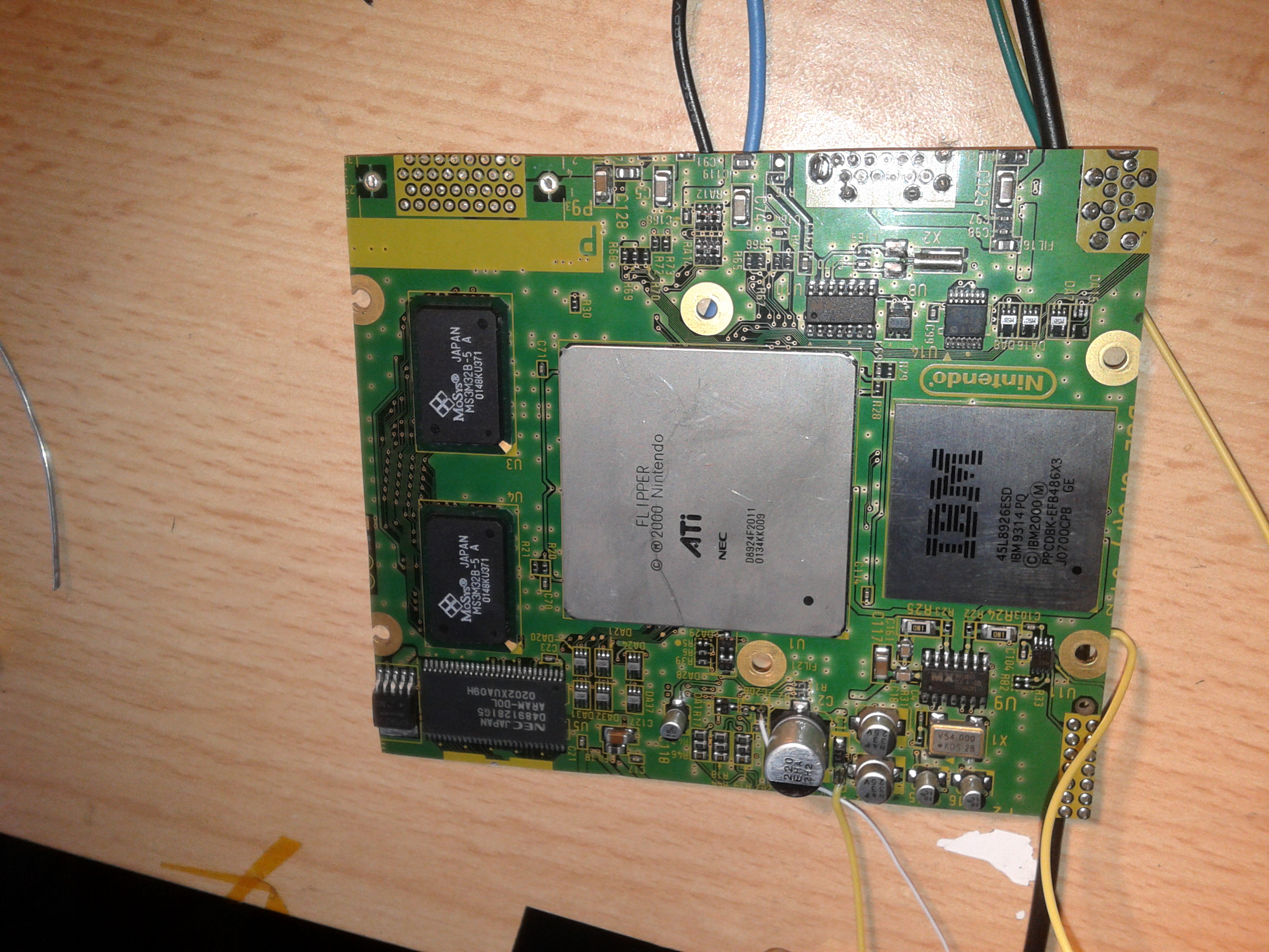

Post by _Nold_ » Sat May 05, 2012 7:15 pm
Sooo..
New Cube is trimmed down... but it dosn't work :/
CPU/GPU/RAM are getting warm but there is no composite signal.. don't know why.. pin 7 should be fine for PAL.. no short on the voltages, too...

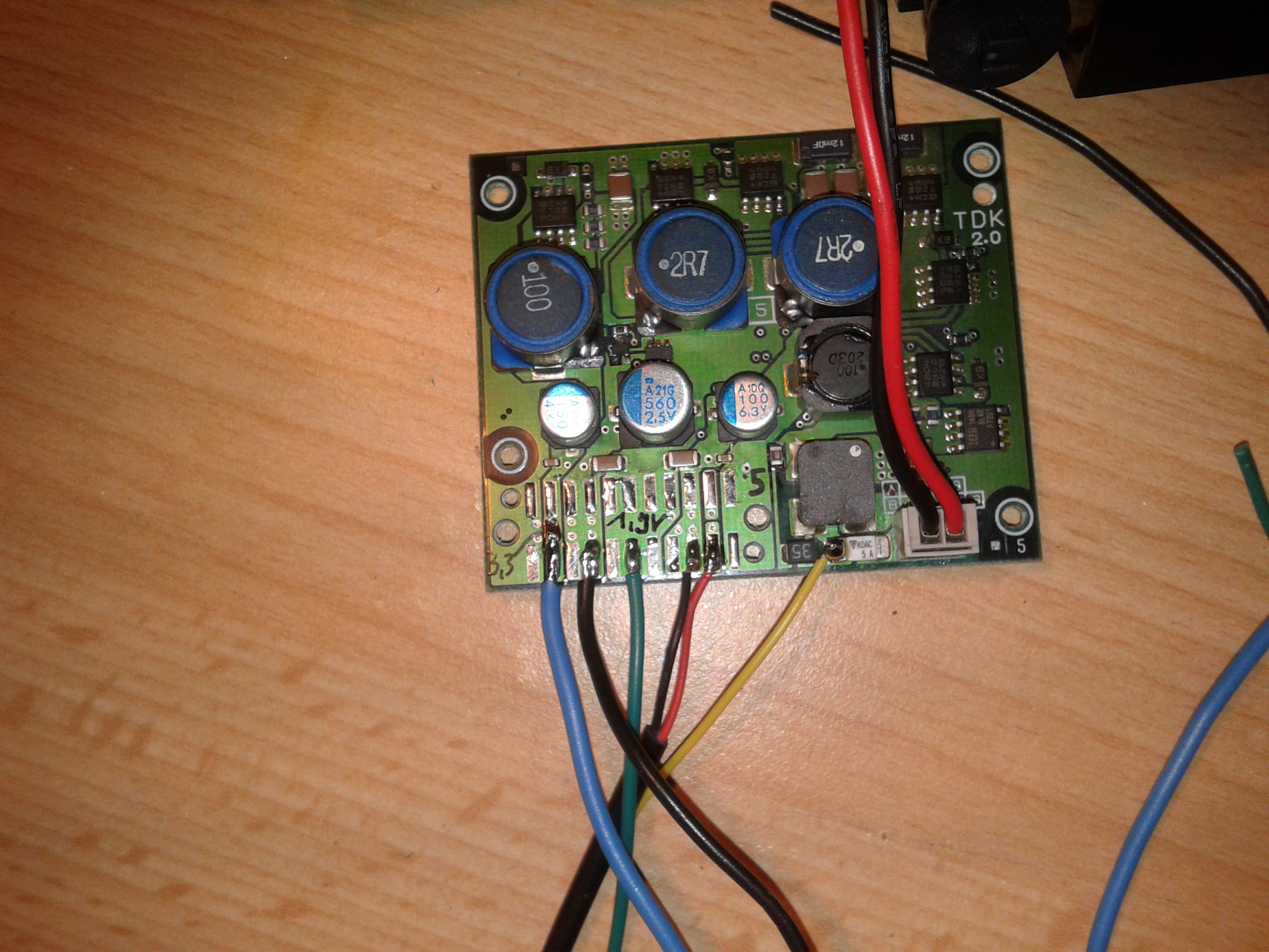

PSU..

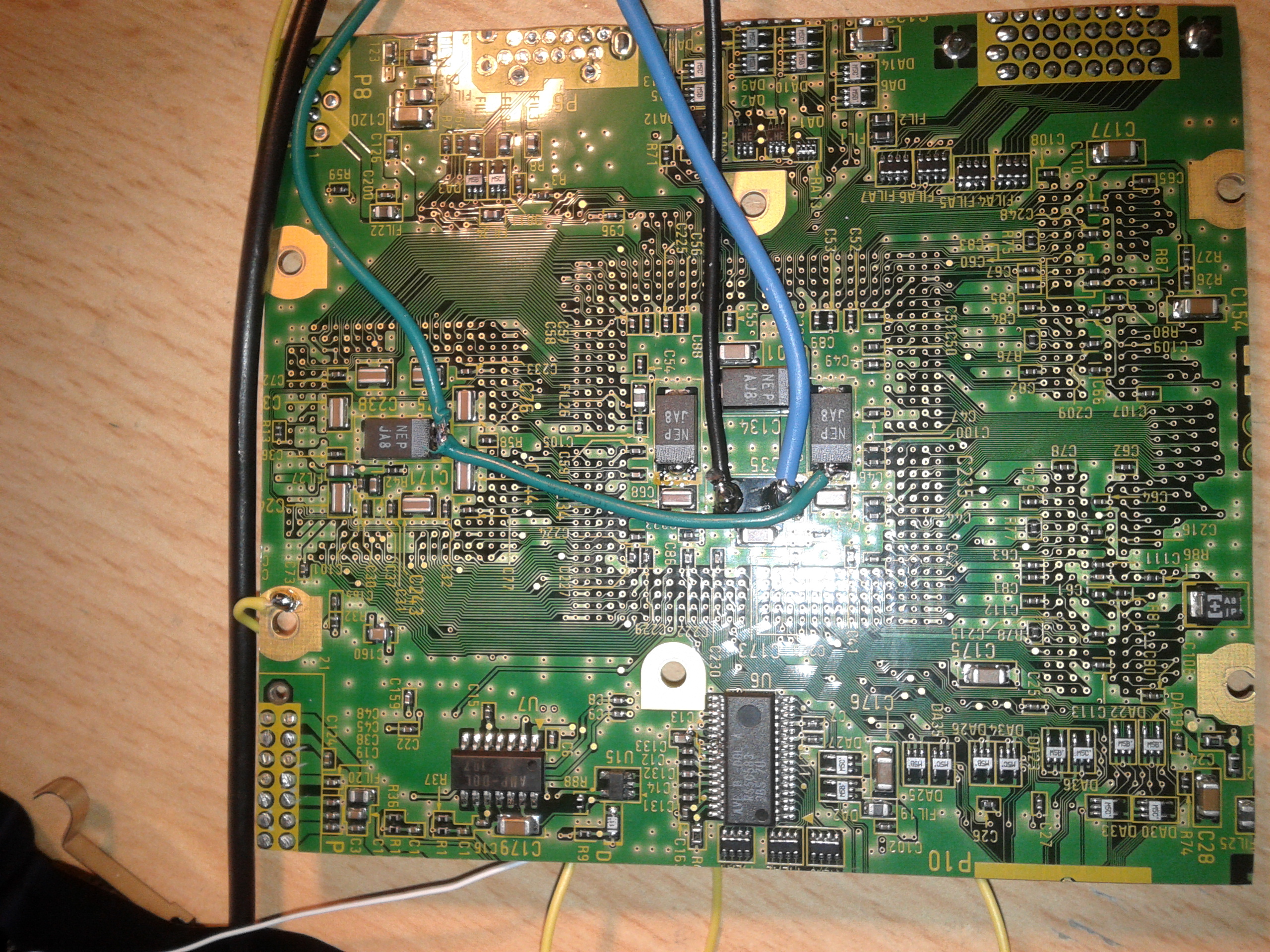

Backsite

Re: First Gamecube Portable - Worklog
Post by Ashen » Sun May 06, 2012 3:13 am
This may sound silly. But do you have video ground hooked up? Everything else looks fine to me, and if the chips are getting hot the board is working, so thats a good thing.

Post by _Nold_ » Sun May 06, 2012 6:15 am
Ashen wrote:This may sound silly. But do you have video ground hooked up? Everything else looks fine to me, and if the chips are getting hot the board is working, so thats a good thing.
Yea, it is hooked up :(

Post by kel01 » Sun May 06, 2012 10:41 am
The composite line on PAL GCs needs a 220uf electrolytic capacitor in series ( positive side of the cap towards the console ) and a 75 ohm resistor connected to ground.
If you have a spare GC composite cable that you don't need then you could take apart the plug that goes into the console and rob the little ready made PCB from it.
