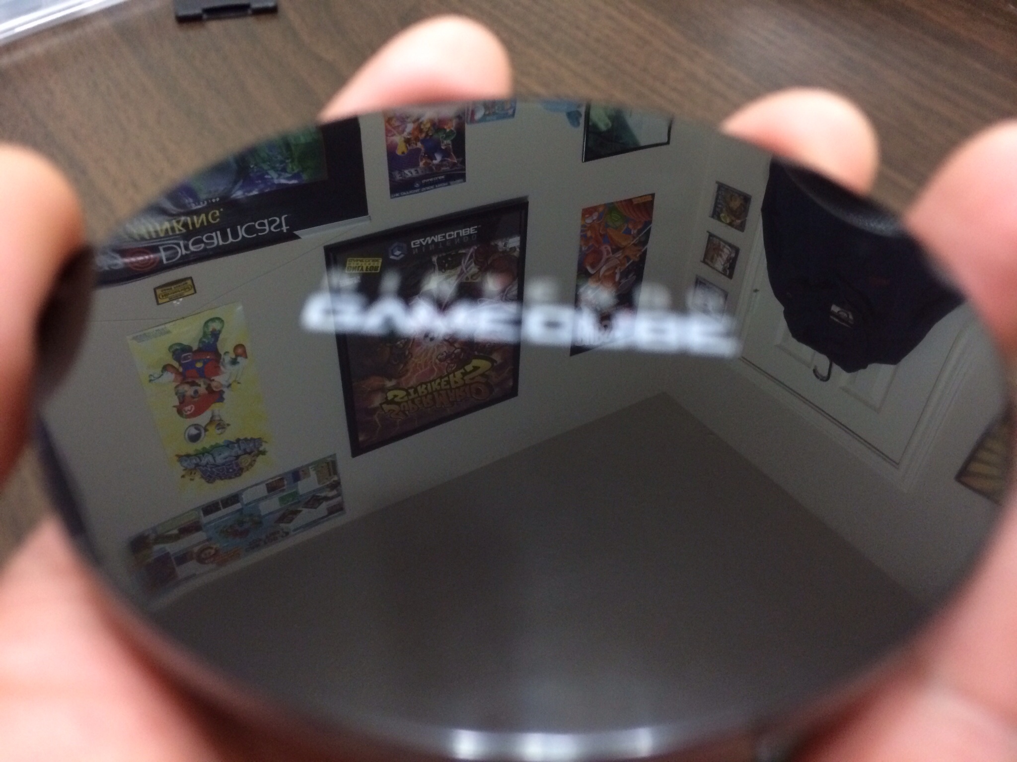

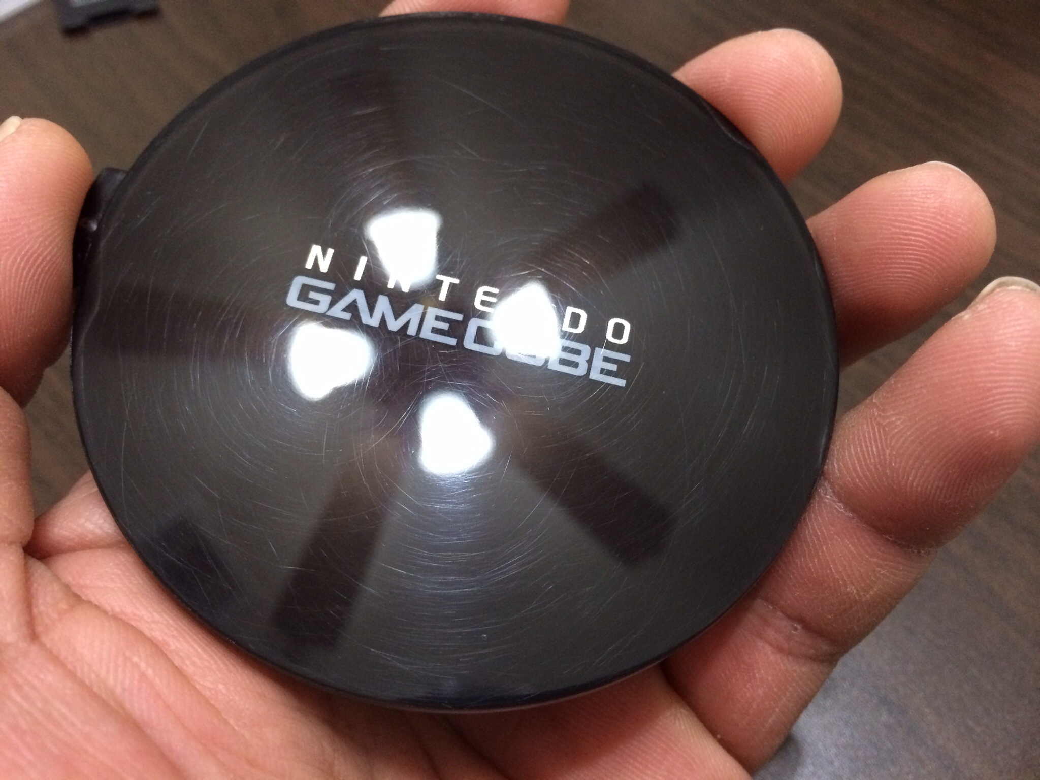

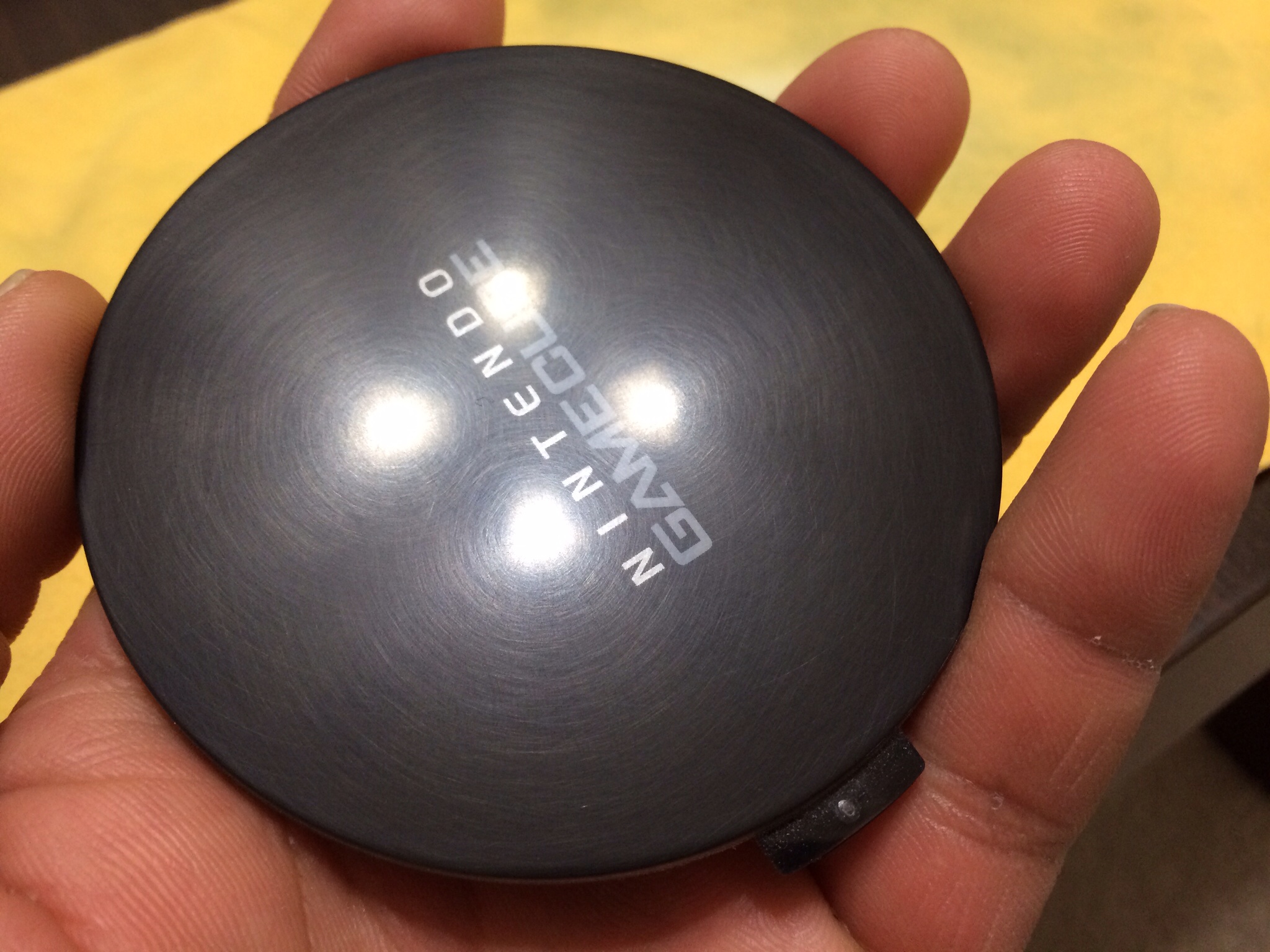

First of all, this thread needs to be bumped. Lately I've been infatuated with polishing up my GC Jewels. (Note... If I didn't add "GC", you could take that differently) lol. So I followed the instructions here with Brasso. First of all, I used 1500 grit sandpaper and then finished off with 2000 to remove and smooth out all the scratches (wet sanding btw). Now I have a very smooth but dull jewel. I proceeded with the Brasso instructions and it got a bit smoother but duller at the same time. No big deal... I then took some MAAS (metal, plastic polish etc) and it got a bit of shine back after a few run throughs. I finished that off with an automotive liquid wax for the renewed shine. I can still see swirling scratches when viewed in the light properly, but angle it just right and it looks like a mirror. Pics below.
Also, I did try using a Dremel like tool with a polishing bit. Didn't work very well for me. Go past speed 2 and you can damage the jewel very easily if your not careful.
Overall I am very satisfied with my results. I do wish I could rid of the micro swirling marks but maybe I need a wax or buffing compound for that. Maybe even a finer grit sandpaper. I'm at a 9/10.
Any other suggestions are welcome. Every time you buy a used cube, your looking at a heavily scratched jewel so we all need an easy way to polish them.
After using Brasso. You can see dullness but scratches smoothed out very well.
(633.29 KiB) Not downloaded yet
After using MAAS polishing cream a few times. Angled to show swirling.
(642.22 KiB) Not downloaded yet
Finished. Angled to show shine, not swirling marks that are still visible. Used a liquid wax to shine it up.
(585.85 KiB) Not downloaded yet
