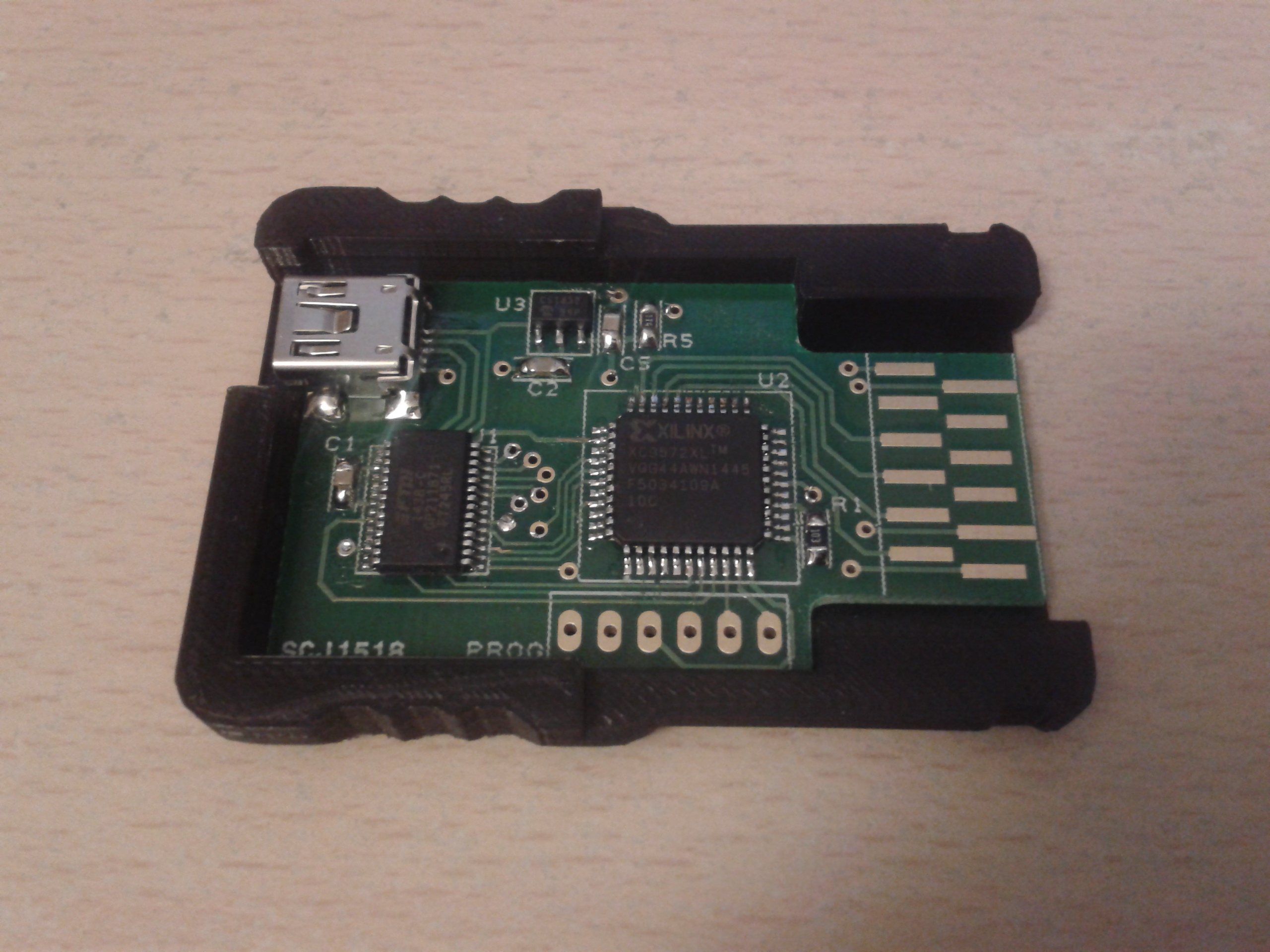

hi all first post created this
(1.04 MiB) Not downloaded yet
ebay kicked me off :-( something about enabling copying of games, although I guess you can use it like that its really a hacking / dev tool I am selling these units for £14 + postage
tracked p&p is expensive from the UK £10 world and £8 europe, so I am going to offer proof of postage as an option basically I go to the post office send you the device for £4 and get a receipt which I will scan and email to you so you know I have sent the device. Its not quite the same as tracked post but its a lot cheaper.
its basically a USB Gecko SE, but done using a CPLD instead of a FPGA, have tested it using the emu_kids swissserver to download dol's to my gamecube seems to work ok.
PM if you want one

Nice, is it a clone of the SE (with the 16-bit commands available too)? How is the speed in comparison if you've tested it?
I like the 3D printed cases ;)

I like how you actually mounted the legs of the mini usb connecter instead of just connecting the pins like the USB gecko does.

@emu_kidid
that was fast I see you are still on the ball, it uses the SE's VHDL code has the same ID however is missing the two 16bit commands (read / write) they didn't fit inside the CPLD I used. At first I thought removing them was a bad idea, but if you look at devkitpro's usb gecko read / write functions they only use 8bit commands, hence the swissserver works without any code mod's. As for speed I am using the same FT245BL chip that the SE does for SPI to USB comms so if you did a back to back test between the SE and it clone using swiss / swissserver the speed should be the same.

The original USB gecko didn't have the 16-bit commands (iirc they were originally the commands to read/write the flash memory) so I doubt any code in libogc uses them.

Yeah, the stub is 8-bit commands too.
