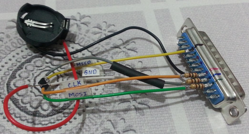

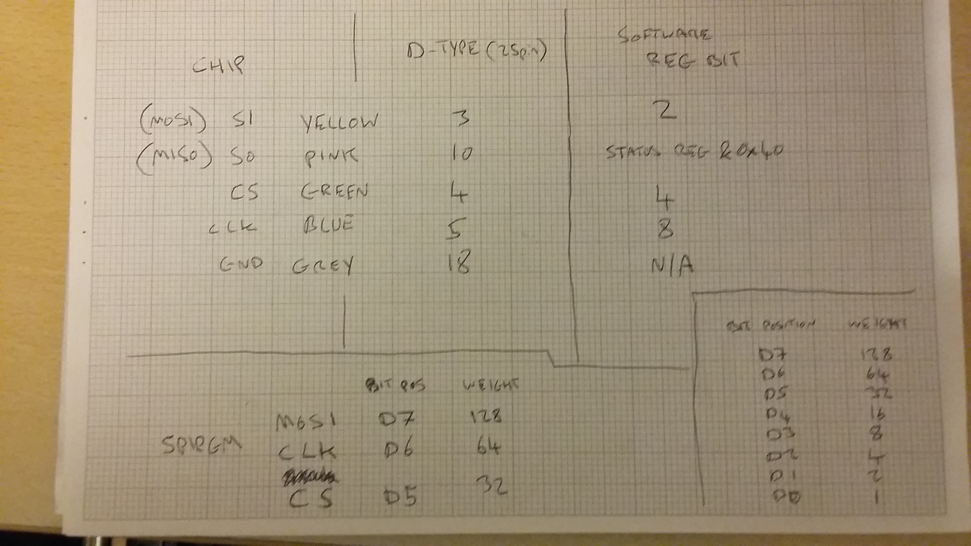

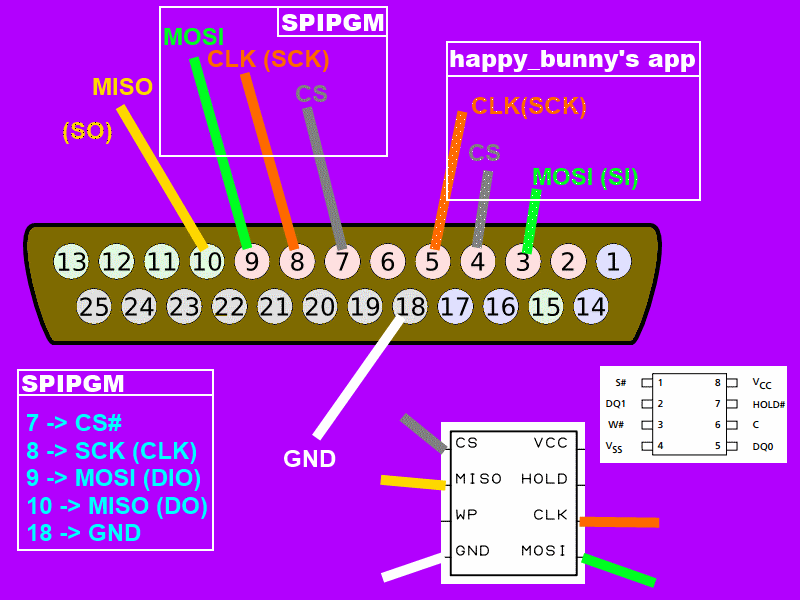

After that I've checked the sircuit I've found. There were three different soldering spots. I've moved those wires and tried with different parallel flasher (
SPIPGM*) which supports the same flash memory (I've found it where the picture was):
If you want to use this method put 4x 100 ohm resistors and 1000uF cap. Erase the chip before program!
But I didn't put a capacitor and the fourth resistor, I just wanted to test it. And it worked from the first try. Some info from the app:

After few minutes it sometimes started to get errors when verify. After about 20-30 minutes every verify was wrong with different number of errors at different addresses. I think that this may be from the missing parts, battery or bad chip.
*use "SPIPGMW.EXE" for >=Win9x, run it as administrator on Win7 or similar

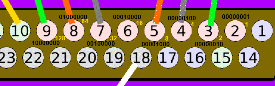

May be helpful picture for someone, and what I've built:
I've put the missing cap and 4th resistor. SPIPGM never faild again, I've tested it for more than 45 minutes.
