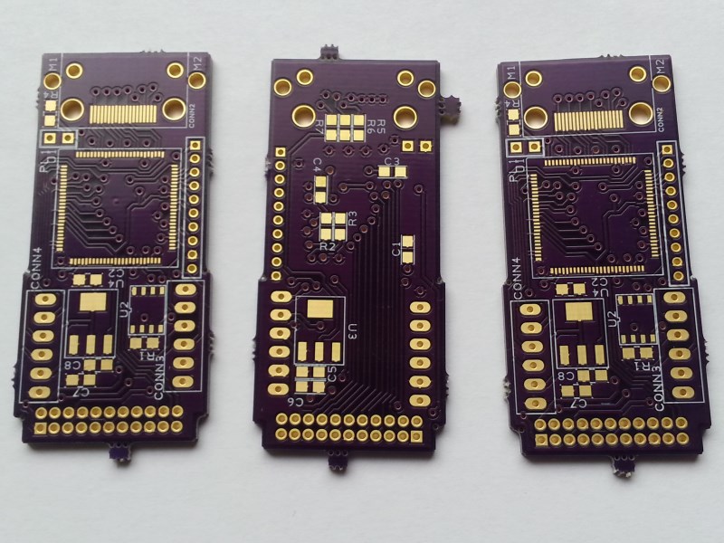

The next step has passed. I've received the boards:
Spoiler
Show
Bad luck, I am ordering the parts and the flash memory is sold out (more than a month to restock). I know, that I have few from aliexpress but I don't want to use them.

One more question - how does the Shuriken Video display the interlaced picture?

meneerbeer
Posts: 212
Re: Shuriken Video
Post by meneerbeer » Thu Jan 14, 2016 8:30 am
TALANTO wrote:The next step has passed. I've received the boards:
Spoiler
Show
Are you going to use the small XC3S50 FPGA or the XC3S200?
With the XC3S200A you can enable the linedoubler to make 480i and 576i, 480p and 576p. Otherwise, 480i and 576i is what your TV will receive. For some TVs this is a problem, from what I heard.
Just give the flash from Aliexpress a try, I have good experience with flash from Aliexpress. What is the name of the flash you got?
TALANTO
Posts: 43
Joined: Sun Jun 01, 2014 10:41 am
Re: Shuriken Video
Post by TALANTO » Thu Jan 14, 2016 11:00 am
It's MICRON M25P40-VMN6PB. I'll use XC3S50. Shuriken Video doesn't have linedoubler, right?
Streetwalker
Posts: 1744
Location: Israel
Re: Shuriken Video
Post by Streetwalker » Thu Jan 14, 2016 11:56 am
If you use the XC3S50 it doesn't, if you use the S200 it does.
happy_bunny
Posts: 106
Re: Shuriken Video
Post by happy_bunny » Thu Jan 14, 2016 9:10 pm
Can you I use different memory? Please give me a url or Farnell id.
if you look at xilinx app951 page 19 table 7 they have a list of flash devices that they recommend (no farnell part numbers though !).
If you have your TV manual around have a look at the HDMI spec its normally at the back of the manual. Older TV's dont like anything under 480p as the shuriken video dont have line doubling the image looks rubbish. If you have a newer TV that supports 480i / 576i then the image looks fine, basically the shuriken video just passes the image from the gc up to the TV and its up to the TV display it correctly (because of the lack of line doubling).
I would recommend trying to get hold of a TV that supports 480i / 756i as it will deinterlace the image correctly if you cant get hold of one, a XC3S200 with line doubling enabled is the next best option.
