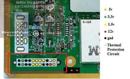

ok i tested the power board and all fuses are good, the voltage i'm getting on the board is 11.77 VDC and 1.88VDC on the board is that normal?
Re: need help with repairs urgently
Post by megalomaniac » Tue Jul 12, 2016 7:17 am
(241.68 KiB) Not downloaded yet

ok heres an update , i bought a fresh console. the last one i'm guessing a cap is gone on the mainboard which causes the no video problem. i used the xeno chip on the new console, adjusted the pot and burned iso's using ridata blanks. was getting alot of errors burning at 1x speeds so started burning at 2x and that solved the issues. 4x some games work clean but some errors with mario so far. so its happy gaming from now. the xeno chip reads well with us,ntsc japan but for some reason pal games give problems showing think its my hdtv. it shows out of alignment and grey.
