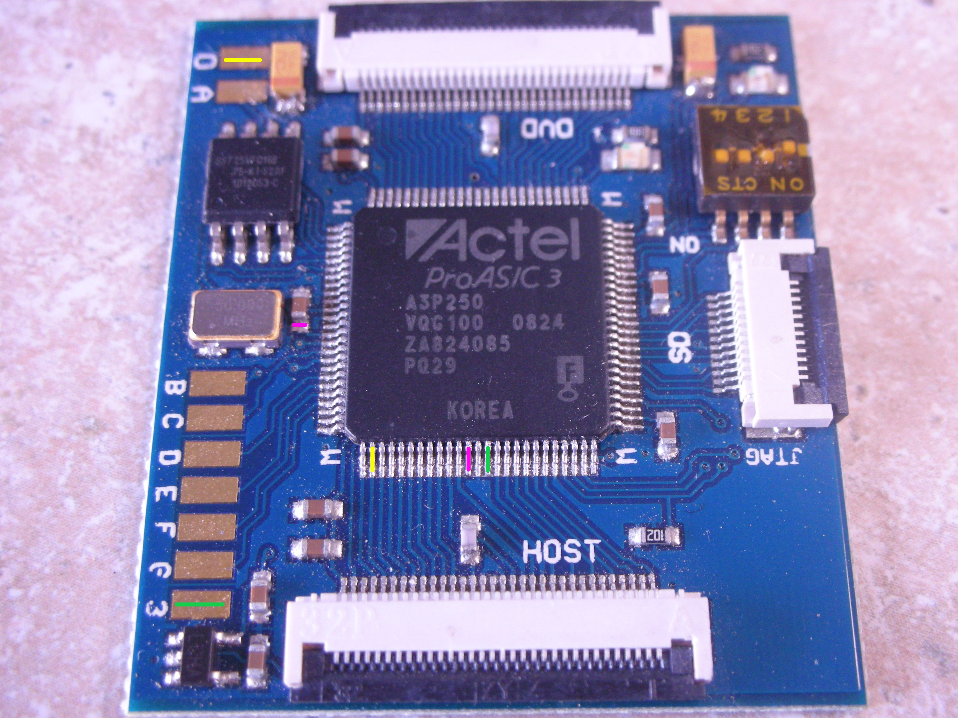

Re: XenoFUSION
its not the cardslot...
pin 29 is controlled from a different IO port than the SD card so should have no effect on making it autoboot...
test the WKF as shown in the pic:
ignore the dust on the board...
check if "green" appears as GND when powered OFF...then turn on and check if its no longer GND but now 3v....
check if "yellow" ever shows continuity with "O" in the top left corner...on and/or off
check if "pink" behaves similar to "green"
btw, im ordering more WKFs monday

Re: XenoFUSION
LOCtronics wrote:I have a wiikey fusion 1.5 firmware swiss v0.3 with autoboot.
LOCtronics wrote:Also note that when I have no sd card insterted the wiikey will load up but no swiis iso is loaded (get the ?) Only when a sd card is inserted will it autoboot the iso. Note that when I but a pin29 switch in it does nothing.
i have a WKF wired up to an IPL 1.1 right now and ready to begin testing...before i connect it to an IPL 1.0...
but before i do anything, i have a question about your "autoboot WKF"
you say swiss.iso will not load...you mean swiss as initial iso (swiss firmware) right?
i have an idea i want to try, but i need to know exactly what you mean before i begin testing....
my idea might might not work anyways considering your pin29 does nothing and should be an indication something is fried...

video is almost done uploading and all will be revealed... (youtube upload takes forever)
- Posts: 221
- Location: Amsterdam
Re: XenoFUSION
It is done! Your method works. Release it to the world!! tested on 3 brand new wiikey's
Now we need a method to downgrade the original wiikeys with firmwar 1.5 back to 1.0 if that's even possible. Or maybe even 1.2... Did that have the autoboot feature?
Re: XenoFUSION
You just have to run the update for it. Then it will go back to 1.0 or 1.5 or what have you.
Re: XenoFUSION
only 1.0 has autoboot
and there is no 1.0 iso to downgrade.....YET !!
