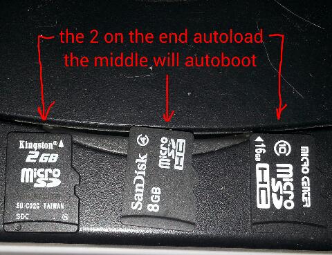

My sd cards I use on my gc and they are effected by wkf with wkf turned off.
(45.94 KiB) Not downloaded yet
