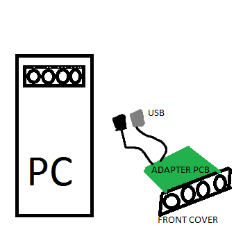

Current (can do right now) plan:
- Open gamecube adapter
- Drill holes in front cover of expansion bay to fit gamecube adapter
- Extend USB cord and take it out the back of my desktop and into the mobo USB ports
- Make sweet sweet love to my newfound love for a bigger better computer with "native" gamecube support

Edit 1: Added some really hot ms paint work which took ages to draw, should be a quick indicator of what I am planning to make. I'll add that I may or may give it a fancy design with leds on controller ports, but it depends how pretty I can get it (I've seen some pretty ones here before, but I don't remember where nor do I remember ever seeing where the leds are placed for best results. No IRL pictures yet as I don't work where I live, I'm not home for a few days.

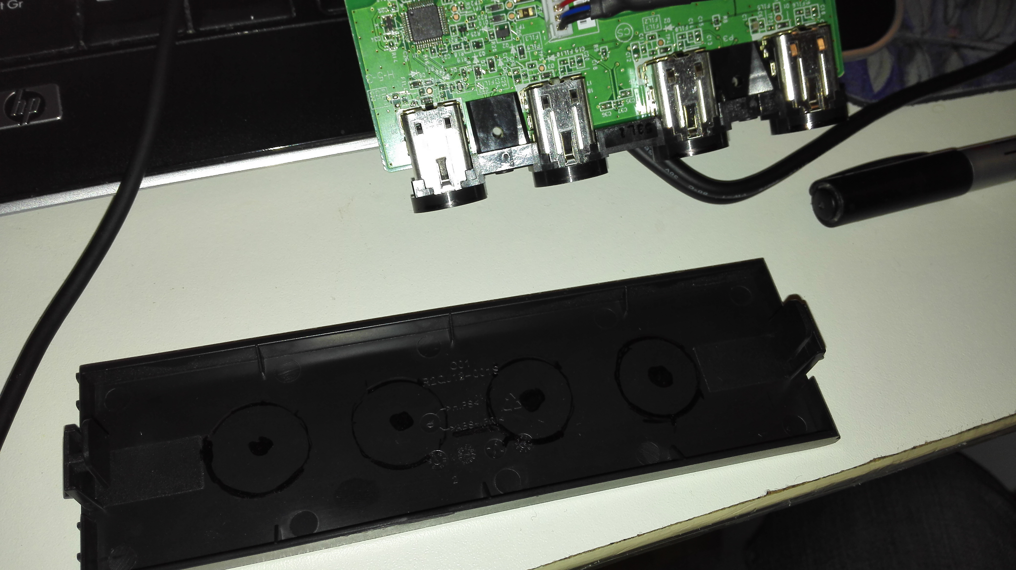

Cuts have been marked. Zero measurements and took 10 seconds flat.
Spoiler

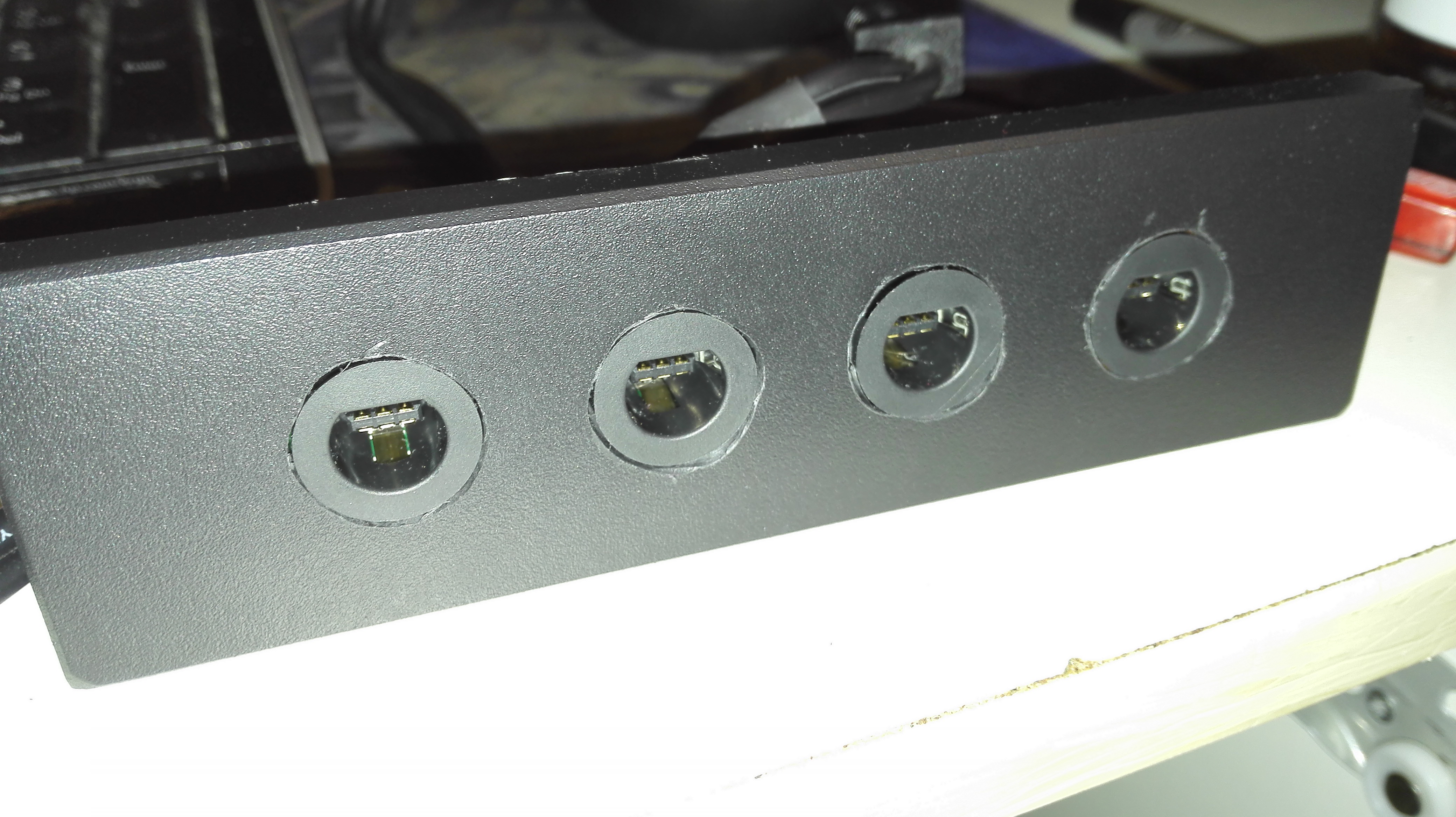

Cuts performed. This is before I cleaned them up a bit so don't throw up yet. You can probably tell this is my first time using a dremel.
Spoiler

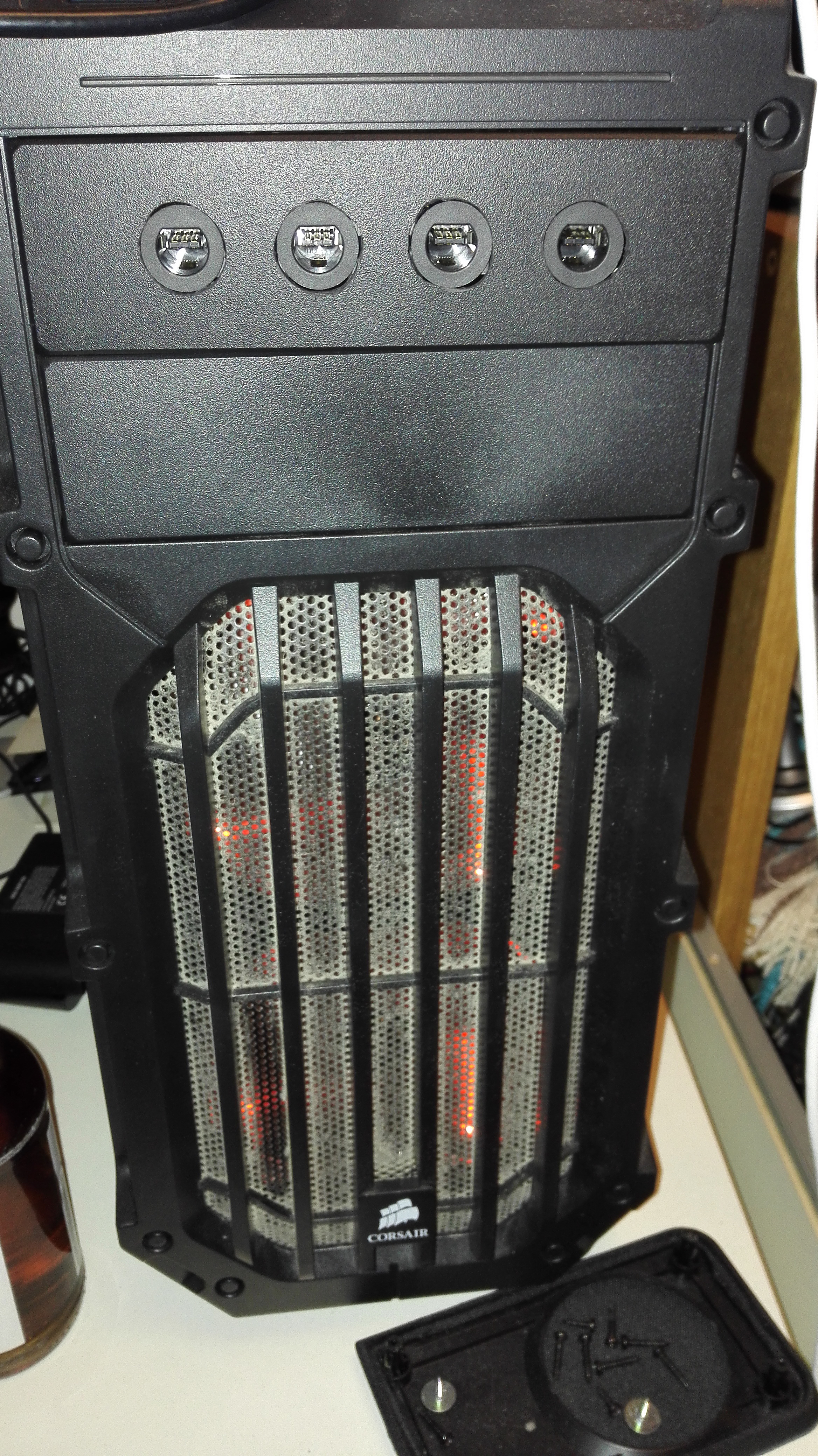

Super dusty computer and IGCA mounted.
Spoiler

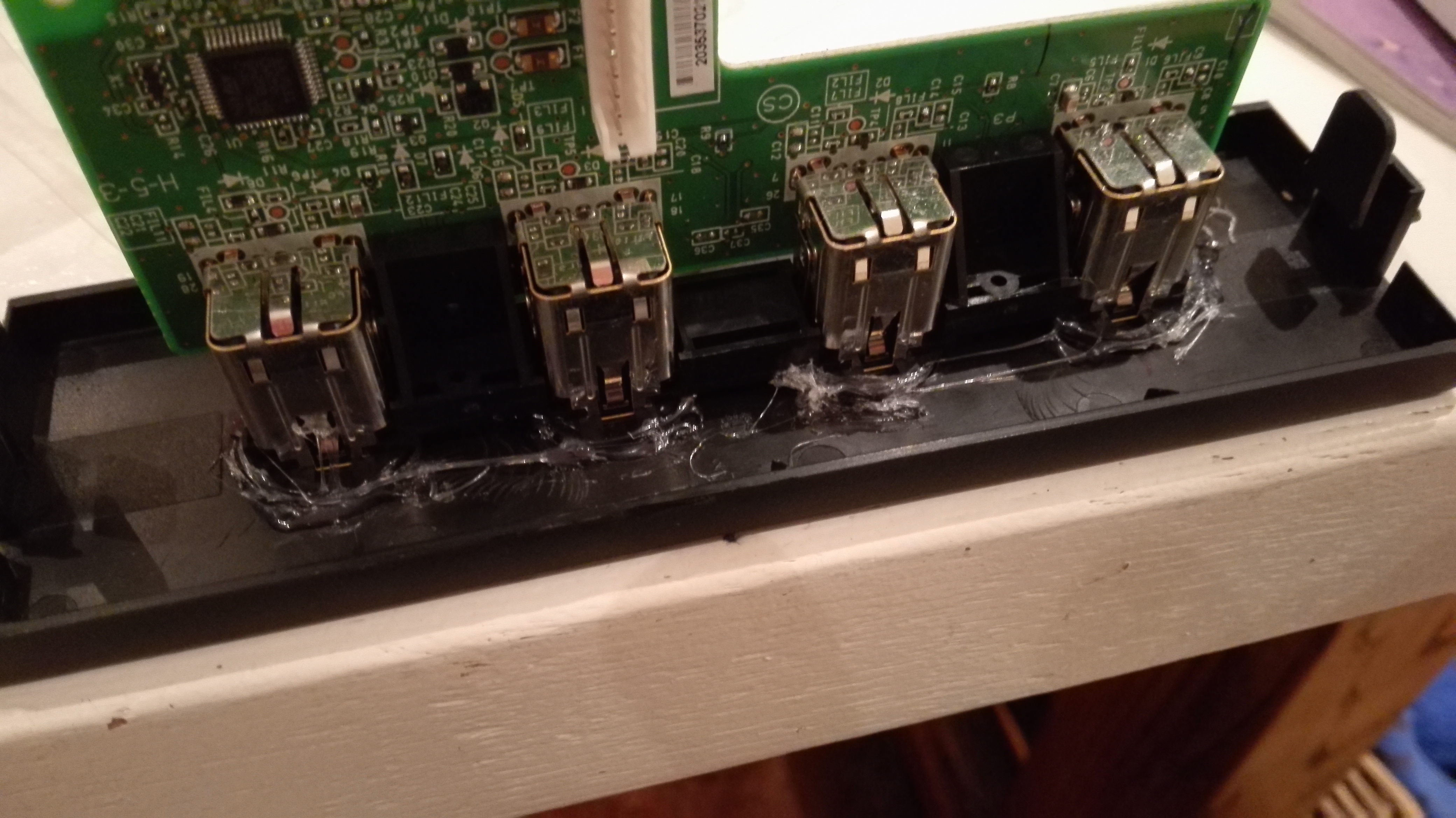

Hotglue gore, it fits and sits so dont worry :)
Spoiler

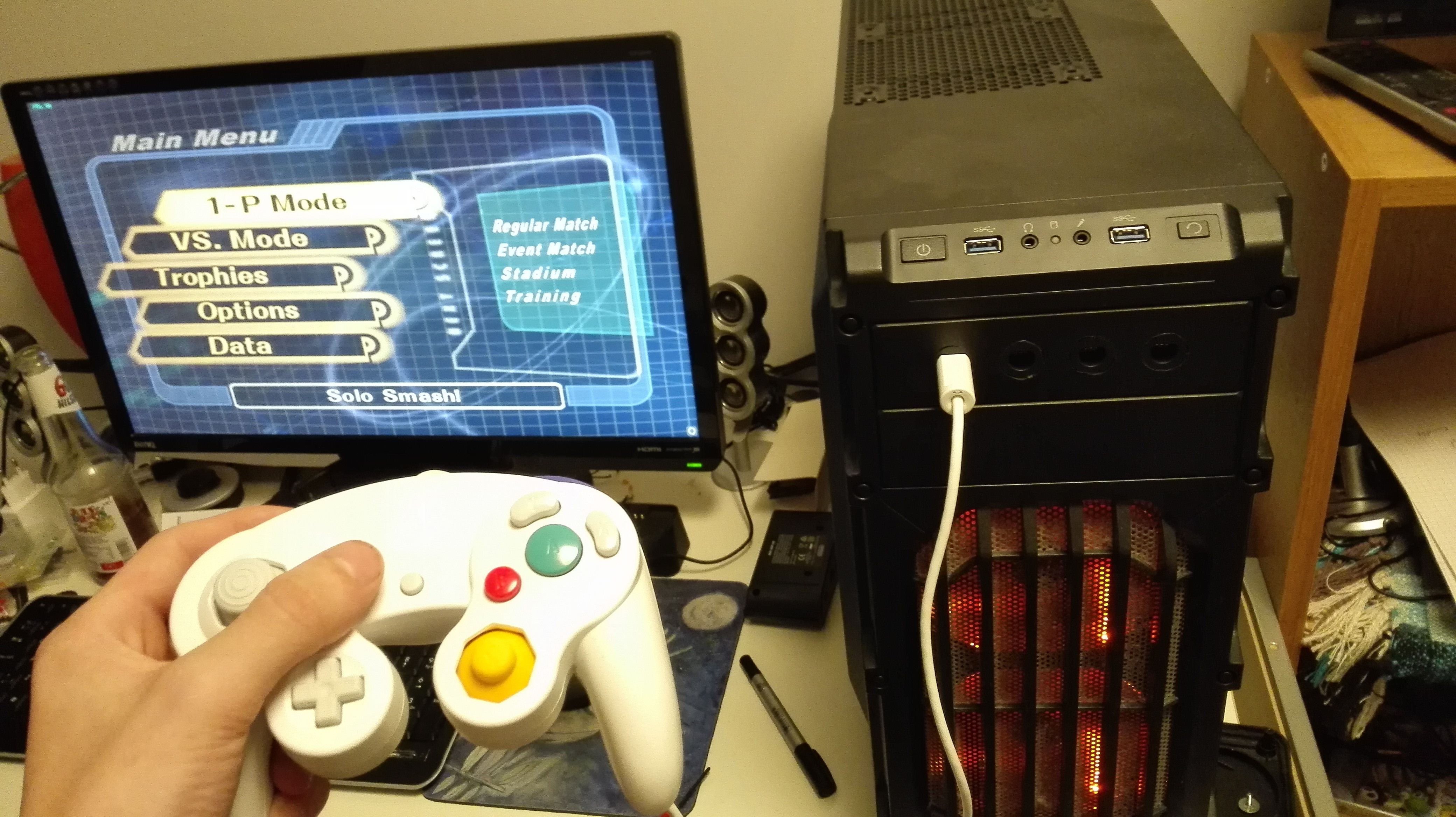

CHILLING! Also have 3 matching smash controllers.
Spoiler
Spoiler
Spoiler
Spoiler
Spoiler
Spoiler
