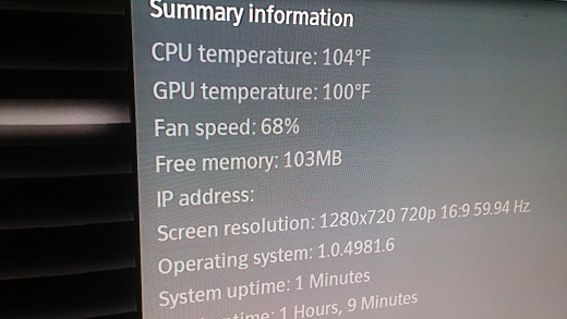

Post by andre104623 » Tue Jul 07, 2015 3:30 pm
:D :D :D FINALLY IT WORKS!!!! My 1.2 TSOP flashed Xbox is now 128mb! I took emus advice and took the ram out of the 1.0 Xbox that was a failure. N64 are running much better and I can also play perfect dark that previously run too slow for me to play. Thanks to my new hakko 888d I'm doing much better now soldering like everything just needed to right tool for the job.

Nice, it's always exciting to see more than 64MB in XBMC ;)
