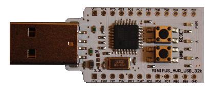

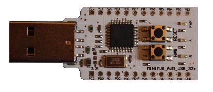

Howdy! I have a spare ATMEGA32u2 based Minimus AVR 32k and I was wondering if anyone could help me figure out how to port the XenoGC to it, as I've just used ATMEL FLIP to burn the XenoGC hex to the device, wired it up accordingly, but still nothing happens?
a better proposition would be to figure out how to use the Minimus to burn the XenoGC hex file to one of my spare ATMEGA8-16pu chips
I'm fairly certain that the ATMEGA8/16/32 series chipsets are nearly all code compatible...I'm just missing a wiring step most likely...

So, as the XenoGC Clone comes with all the Source code, poking around in it leads me to something like the LED code:gabeNcubeN wrote:Howdy! I have a spare ATMEGA32u2 based Minimus AVR 32k and I was wondering if anyone could help me figure out how to port the XenoGC to it, as I've just used ATMEL FLIP to burn the XenoGC hex to the device, wired it up accordingly, but still nothing happens?
// green
#define LED1_ON PORTB &=~0x80
#define LED1_OFF PORTB |= 0x80
// red
#define LED2_ON PORTC &=~0x01
#define LED2_OFF PORTC |= 0x01
#define LED_INIT DDRB = 0x80; DDRC = 1;
So, in theory, moving around the pin assignments is going to be a piece of cake, I can assign the LED's to the built in LEDs on the minimus and make it USB updateable...
Hopefully after an Energy Drink and a few hours in WinAVR, I should have a working "MinimusGC" Hex for those of you who couldnt/wouldn't be arsed to build an ATMEGA8 programmer
Edit: I could use some help with reading this source code, I'm scouring the forums for hints and tips right now, but yeah it's rearranging the pins at this point!

the default hex file does in fact function, I moved around the LED's and they worked, unfortunately, I can't seem to find the SCK or OSC Lines and I burned out my current Minimus AVR's solder points, so I'm going to call it a night, as they're 8 euros to buy and I've already used up my xmas present money on a Pic Programmer (LOL).
I'll keep on working on this project, but these chips are effing expensive compared to the Good Ol' ATMega8 which you can get for peanuts.

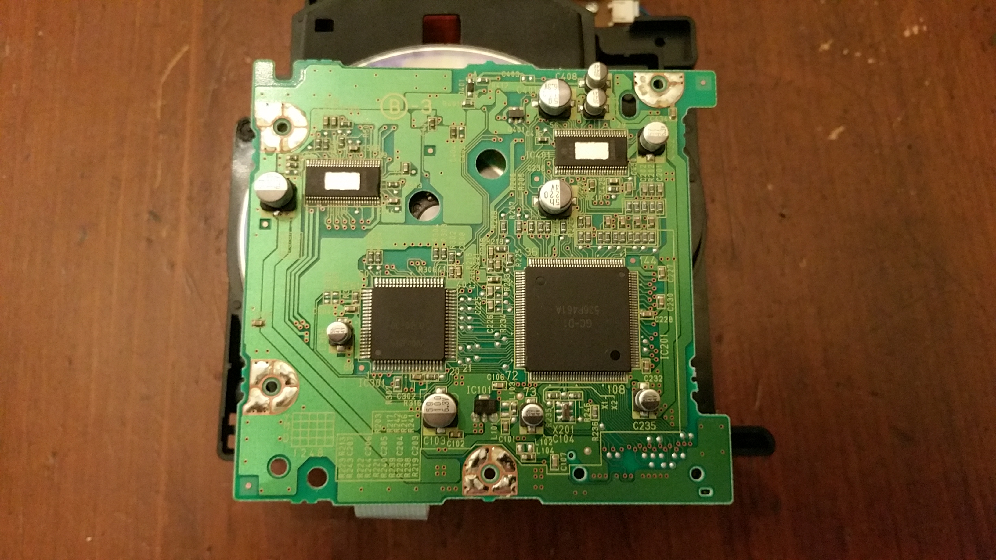

Hello, I have a XenoGC v2.0 chip that i've been trying to install into my gamecube for some time now. I have messed up the contact points on the normal side where they are no longer usable. I have also discovered my GC is a little different to some peoples too.
Mine in the RJB2281B, the alternative guides that are very helpful can't be used by me because my board is different than the ones I've seen online. Anyone have idea/pictures of ones they have done/can take my image and make a guide for me?
Thanks, Logan.
Thanks, Logan.

I have a DOL-001 Gamecube with HDMI done on it. The disc drive is not working with backups consistently and I've tried POT tweaking it all over the place. I want to replace the drive, so I purchased a GC off of Gamestop's website. Obviously, they don't specify which DOL-001 or DOL-101 you'll get. So in the event that I get a DOL-101, can its drive be used in DOL-001 with XenoGC?
Re: XenoGC
Listen the pot tweak is like a nanometer to the left counter clockwise too much disc wont spin now if your install is good you should see a red light then flash to the other red light right beside it. You have to look when powered on at it to see if it switches. I use cheap dvd- r n get to boot everytime
