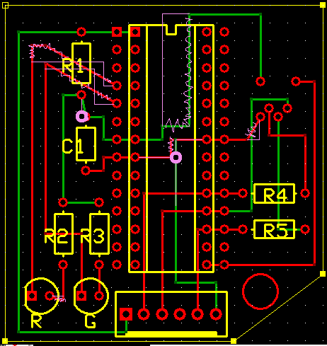

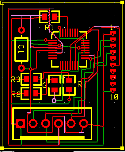

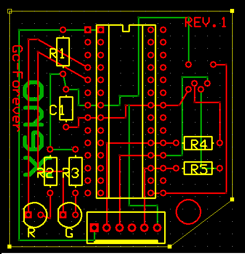

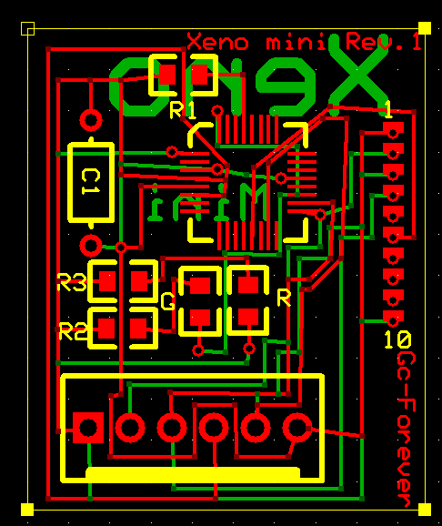

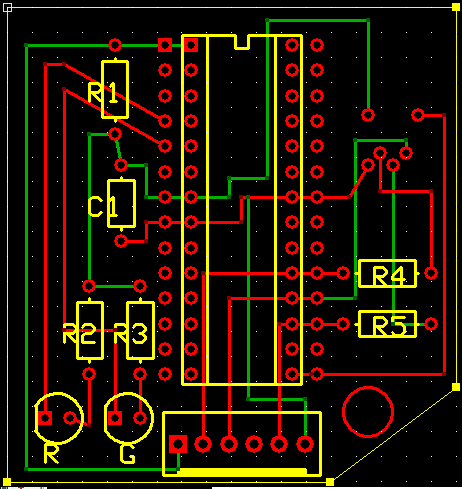

I am very new with PCB manufacturing but, I wanted to learn and creating a mod chip seems to be a good place to start....
remember i am very new to this so and incite would be appreciated. I fallowed the guide from http://www.gc-forever.com/wiki/index.ph ... _the_Board
The mini version of the xenogc
(30.11 KiB) Not downloaded yet
the full sized xenogc prototype
(26.89 KiB) Not downloaded yet

Post by megalomaniac » Thu Sep 05, 2013 4:24 am
looks good...
there are a couple of places i would like you to reconsider to make this better but first, can you repost additional photos of the board without the "xeno" "rev" "gc-forever" "blah blah" flashy naming...it makes it easier to see possible errors without all this unnecessary fluff

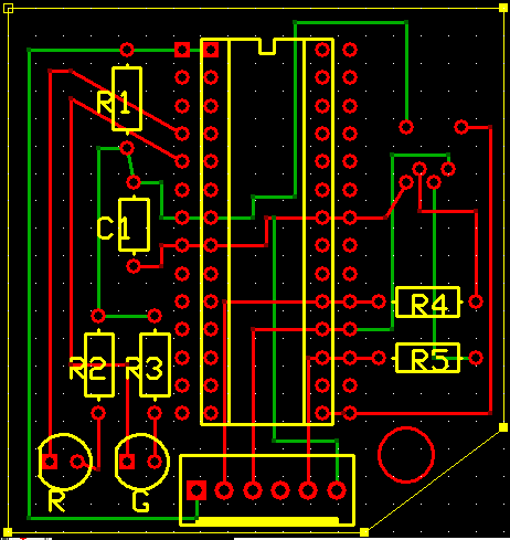

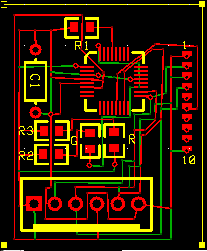

ok my apologies here the fixed pics...
the full size without writing
(12.77 KiB) Not downloaded yet
the mini without writing
(20.86 KiB) Not downloaded yet

Post by megalomaniac » Thu Sep 05, 2013 5:17 am
all ive really done if show how to improve a bit by making the traces straight and easy to see for first attempt...you this will also make things easier until you are better at etching since angle lines have less width which means less trace...
sometimes it works sometimes it doesnt...
just takes pracetice...
also i did not verify circuit integrity, but something seems a bit off on the mini but im not sure exactly what since i did not verify circuit pinout...just does not seem right..
maybe do the base xeno circuit first without ISP...then after you 100% verify add the ISP??
(11.71 KiB) Not downloaded yet
(8.71 KiB) Not downloaded yet

why did you move the pin from the isp to the R1 pin? And i thought i needed the isp to program it with the xeno firmware? and the mini is my assumption of the pin outs using the date sheet for the two of them by matching signals... the mini require parts a tad difficult to obtain so it may not be made. does the the xeno complete look like its going to work?

28 pin Dip = 32 pin Dip
1 = 29
2 = 30
3 = 31
4 = 32
5 = 1
6 = 2
7 = 4
8 = 3
9 = 7
10 = 8
11 = 9
12 = 10
13 = 11
14 = 12
15 = 13
16 = 14
17 = 15
18 = 16
19 = 17
20 = 18
21 = 20
22 = 21
23 = 23
24 = 24
25 = 25
26 = 26
27 = 27
28 = 28
Not conected pins
-------- 5 = GND
-------- 6 = VCC
my data sheet you dont have to verify, i thought i would share....

Post by megalomaniac » Thu Sep 05, 2013 5:54 am
Like I said I didn't really look over the circuit...I just showed ways to improve the trace layout..
If that R1 matches schematic, then ignore that scratch out ...
The complete version looks mostly correct but I can't confirm without further examination of your routes..

Post by shadowtuy » Thu Sep 05, 2013 6:08 am
ok ill scrap the mini thank you :)
