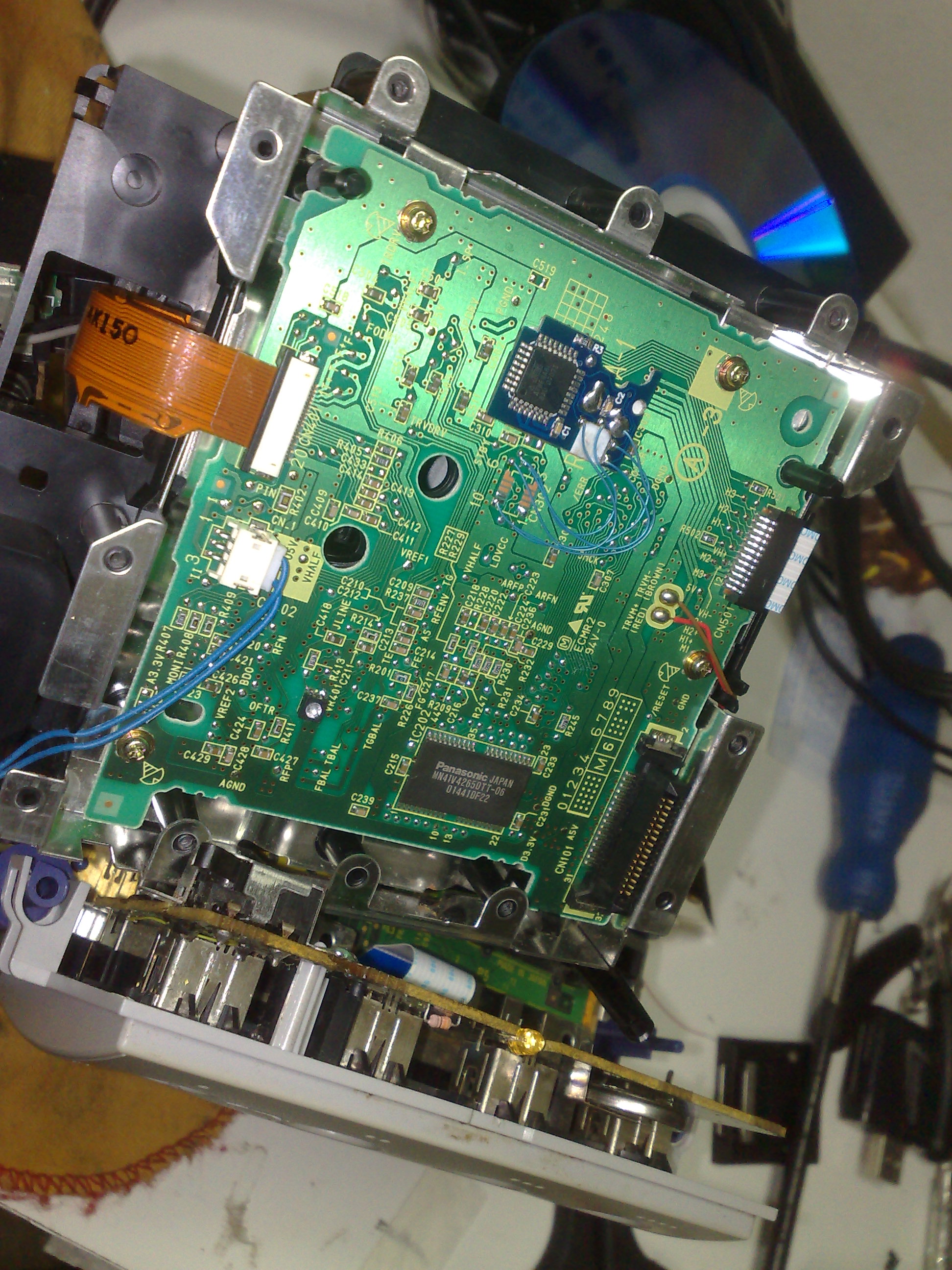

Hello my friends thanks, wiikey is working on my gamecube, thanks to everyone who helped me without even knowing it, without it this topic would not be possible, I would still be trying to find a modchip fo my beloved cube.

- Hugo_Peters
- Posts: 96
- Joined: Sun Apr 03, 2011 9:17 am
- Location: The Netherlands
Re: Open source Drivechip
Er, well I'm very happy for you, but you probably posted this into the wrong section.skygames wrote: Hello my friends thanks, wiikey is working on my gamecube, thanks to everyone who helped me without even knowing it, without it this topic would not be possible, I would still be trying to find a modchip fo my beloved cube.
Emu, what do you think?

what do you mean?Hugo_Peters wrote:Er, well I'm very happy for you, but you probably posted this into the wrong section.skygames wrote: Hello my friends thanks, wiikey is working on my gamecube, thanks to everyone who helped me without even knowing it, without it this topic would not be possible, I would still be trying to find a modchip fo my beloved cube.
- Hugo_Peters
- Posts: 96
I mean, what does Emu thinks of this misplaced post?liquitt wrote:what do you mean?Hugo_Peters wrote:Er, well I'm very happy for you, but you probably posted this into the wrong section.skygames wrote: Hello my friends thanks, wiikey is working on my gamecube, thanks to everyone who helped me without even knowing it, without it this topic would not be possible, I would still be trying to find a modchip fo my beloved cube.
GameCube:
is it misplaced? thought he reflashed his wiikey somehow
Nice job!skygames wrote: Hello my friends thanks, wiikey is working on my gamecube, thanks to everyone who helped me without even knowing it, without it this topic would not be possible, I would still be trying to find a modchip fo my beloved cube.
Also very handy, as there is a huge amount of Wiikeys compared to Xeno's.
