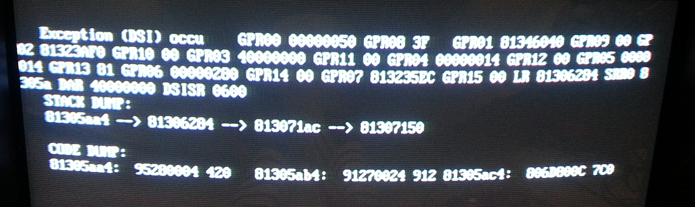

  • clang + my own GC's IPL + libogc from git: iplboot boots, detects SD card, crashes with error screen below
(829.73 KiB) Not downloaded yet
