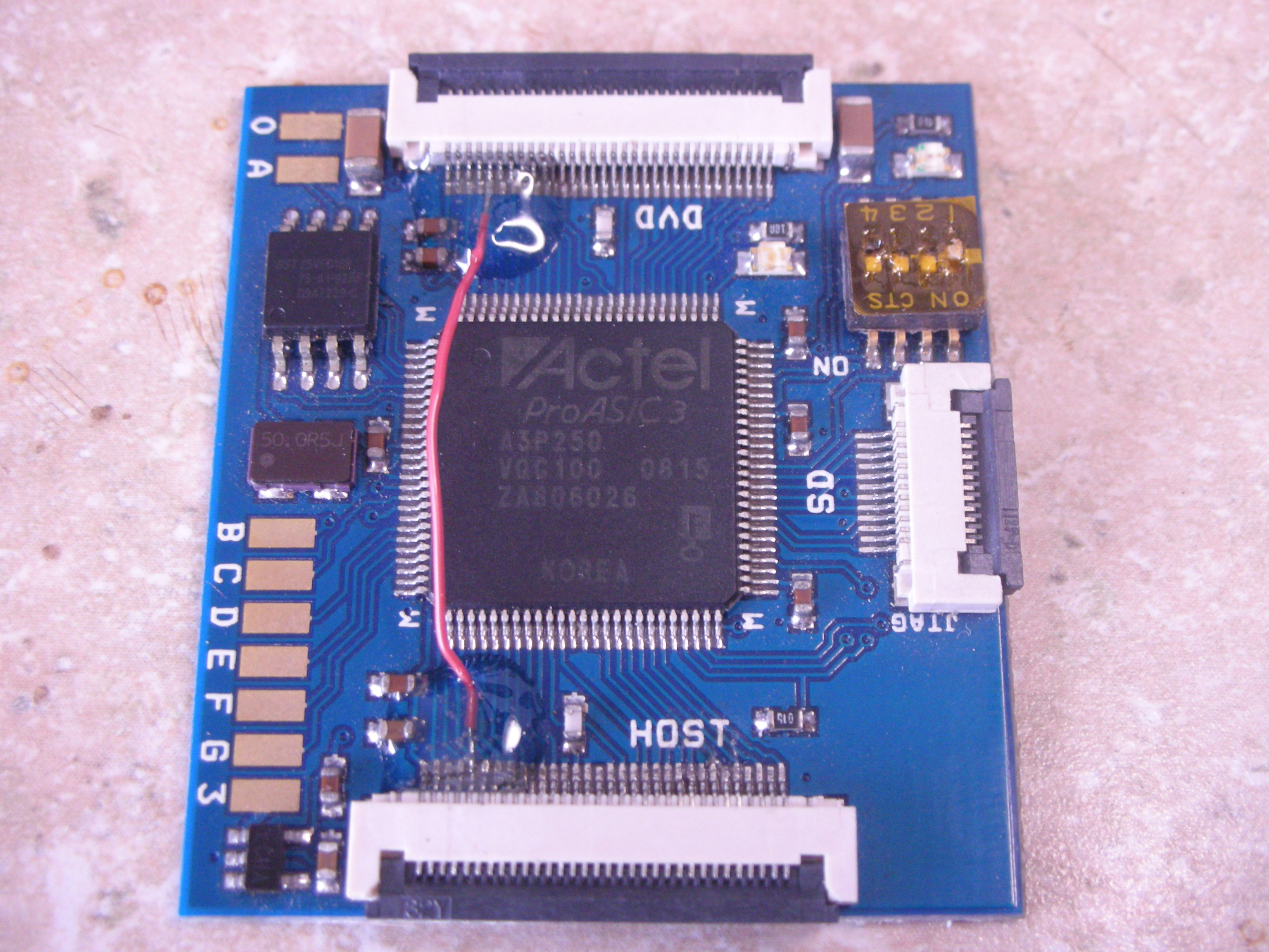

On the GC-Forever Wiki's Audio Streaming page, it says that I can get original audio streaming titles working again with the WKF installed by doing a wire mod but I can't find information on what that mod is. Does anyone have a link?

I think I just found a picture to do this mod on the WKF for DVD streaming audio fix. I hope this is the right one.
https://www.gc-forever.com/forums/downl ... php?id=967
Re: DVD Issue After Wasp Fusion Install and Audio Streaming Question
Post by emu_kidid » Mon Sep 16, 2019 5:07 am
SkydivinGirl wrote:
Sun Sep 15, 2019 6:48 pm
Yes, that's the one, it should pass audio data from the real drive through to the GameCube.

I did install and successfully test the wire mod. Streaming audio is working perfectly from the DVD drive. :D
