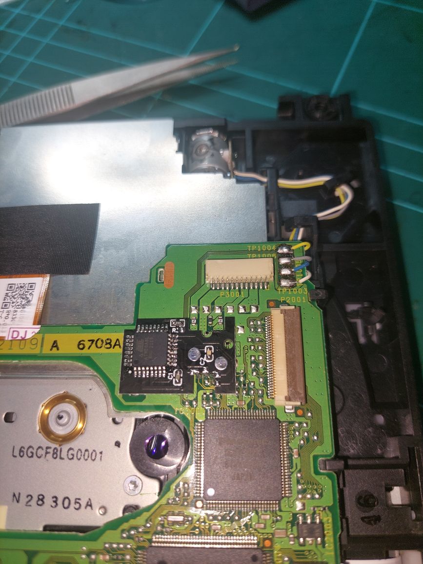

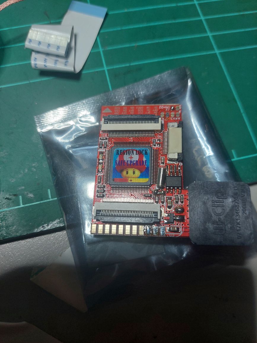

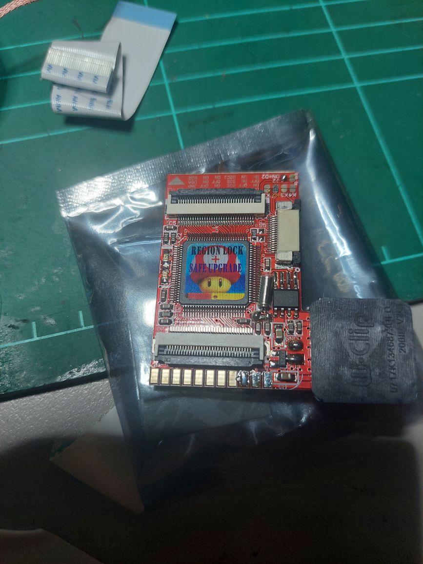

Post by 1nick9 » Sat Jun 11, 2022 1:38 am
yeah i was installer. mostly used yaosm for dms-d2b. then d2ckey for short period was only. then d2sun lites as worked dms-d2e (softmods was taking over at bout this point so drive install requests was low for little. never used d2pro as by time needed to was d2sunlite lot cheaper), was cheap and worked well. still used yaosm for early rev. do have a d2sun still, the higher end version as got it for a d2e for myself and chips was long dead by then but found d2sun still on ic2005 (dunno if still up). ended up coming across some dms-d2b boards so swapped for wiikey that mate sent me 2x. installed one then noticed i had the dumps of it so tested actually worked with dip atmega8 as local electronics shop stocked that, was unsure work off the 3.3v point so just put it on 5v. as datasheet showed its range not as low as L or newer A for supply. worked np so stripped the wiikey for easier tracing n did my clone of it.
oh do have flatmii in one wii too. didn't bother adding to upload shit from there site as all captured in website captures on archive, can if people wish me to add it.
heres some pics seeing said was going to take some of what got.
