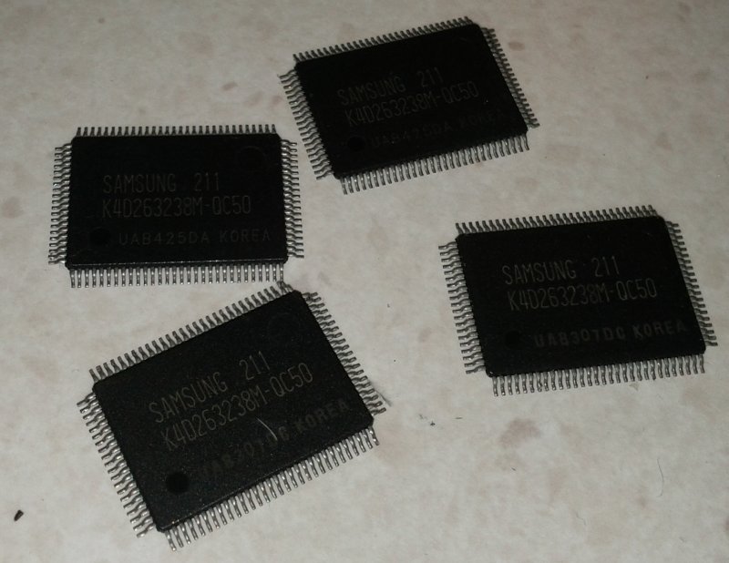

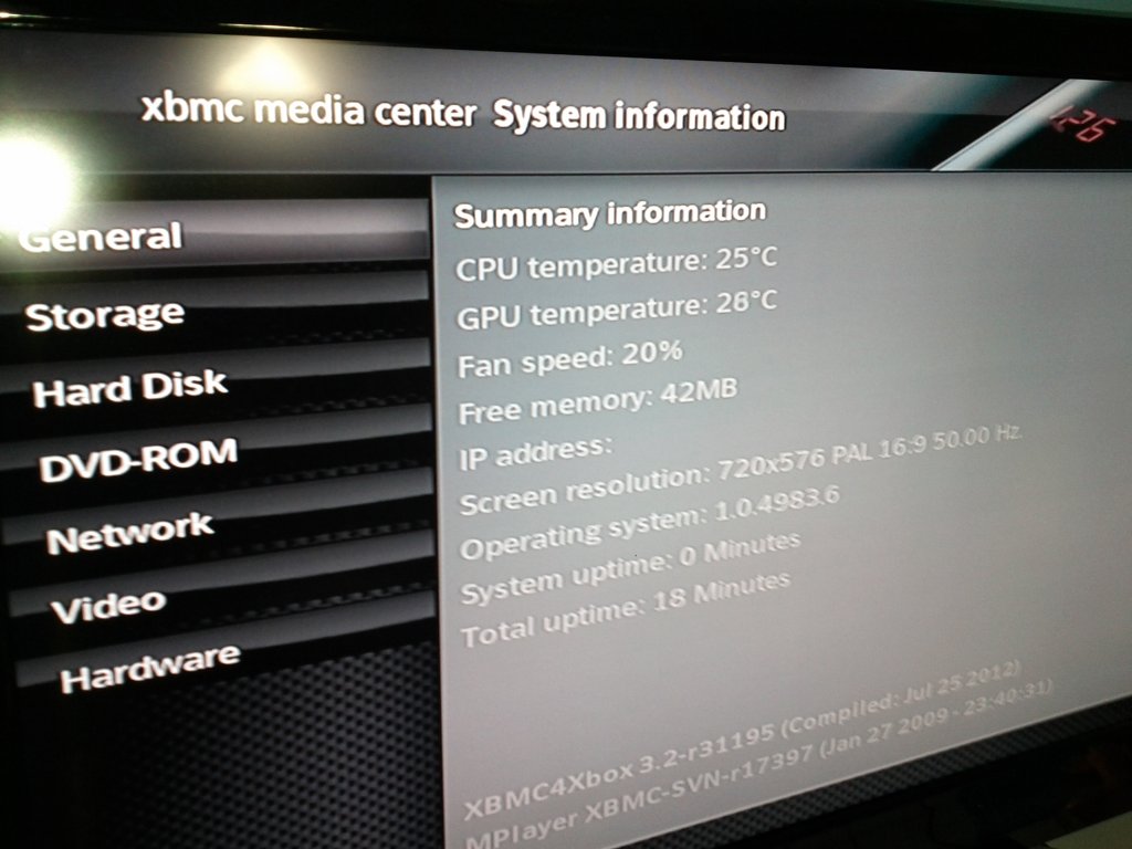

1. The 4 RAM chips (16MB x 4)
2. XBMC showing me that there's about 40mb free (most would have been paged to HDD)

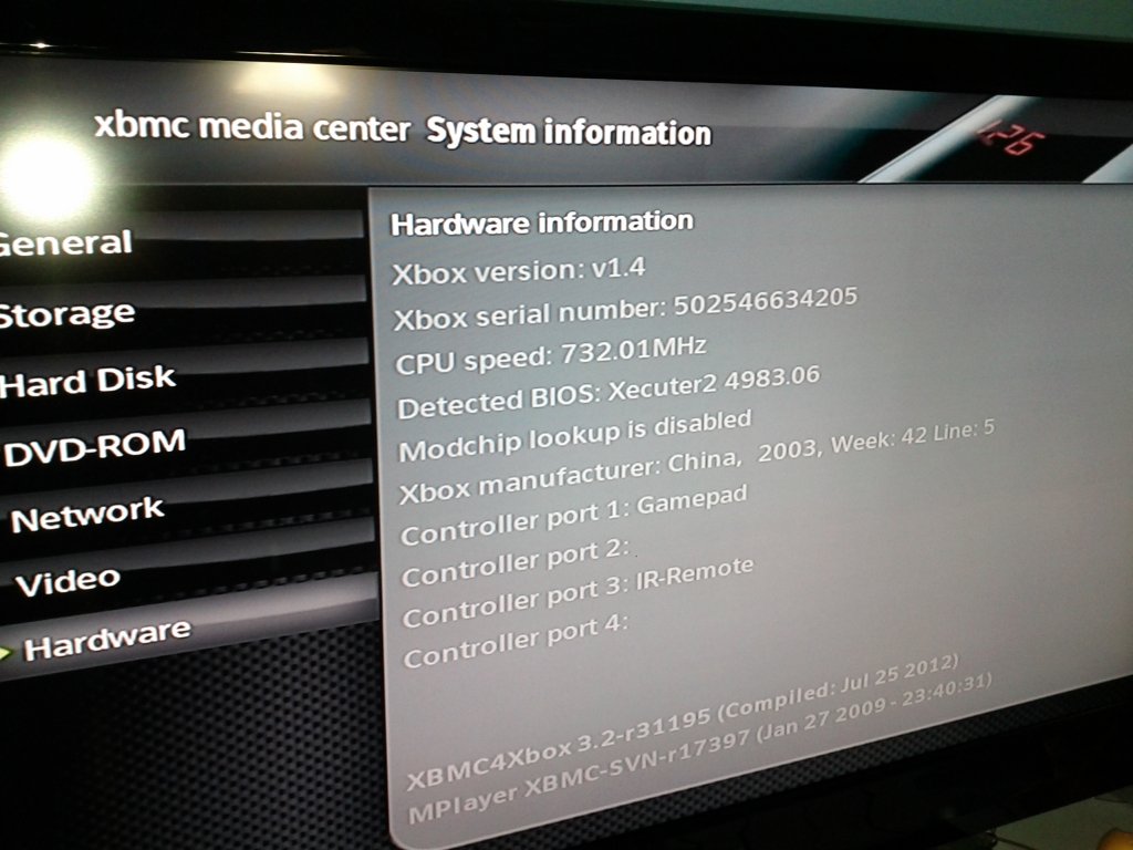

3. Additional XBMC info cause I felt like sharing :P

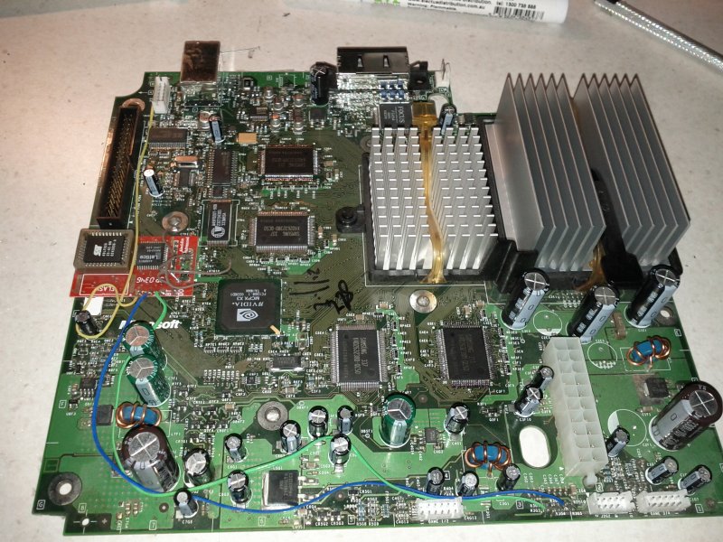

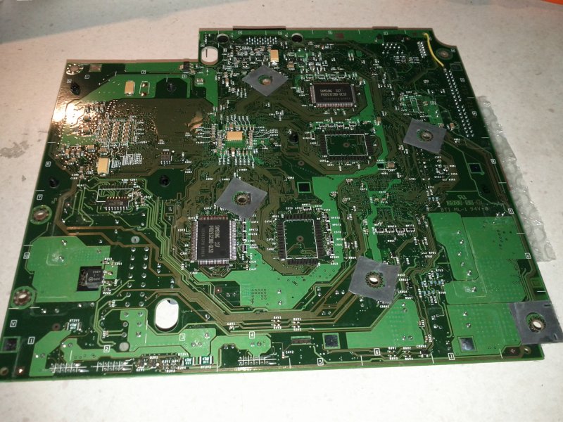

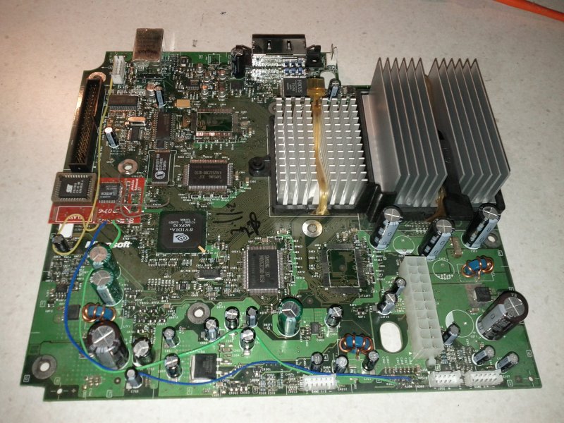

4. The mainboard removed, stock with the empty additional RAM spots - TOP.

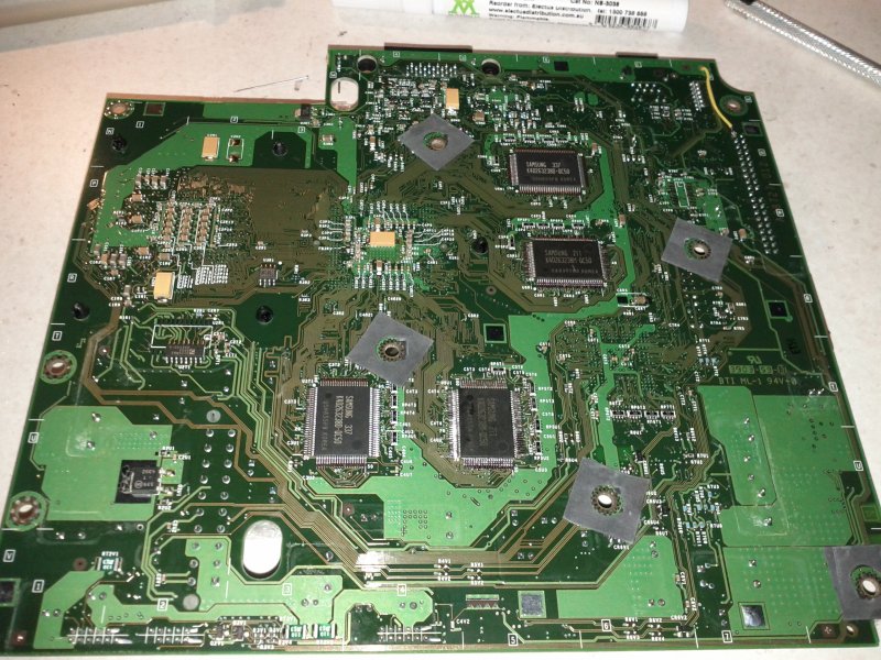

4b. The mainboard removed, stock with the empty additional RAM spots - BOTTOM.

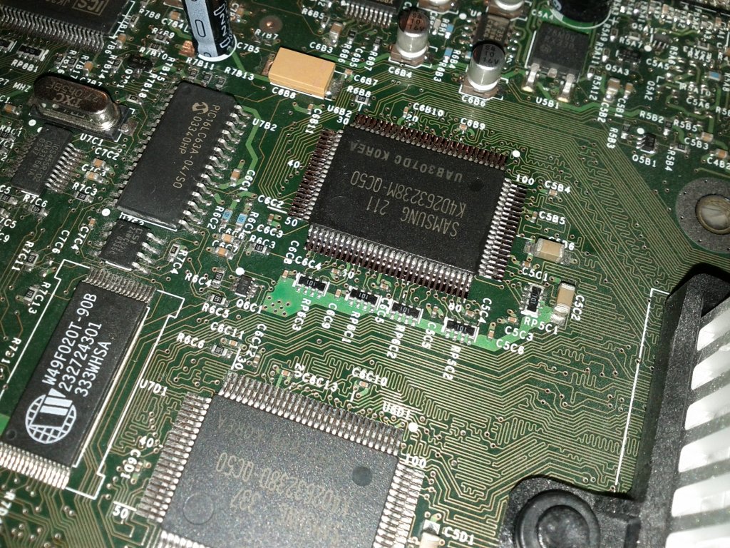

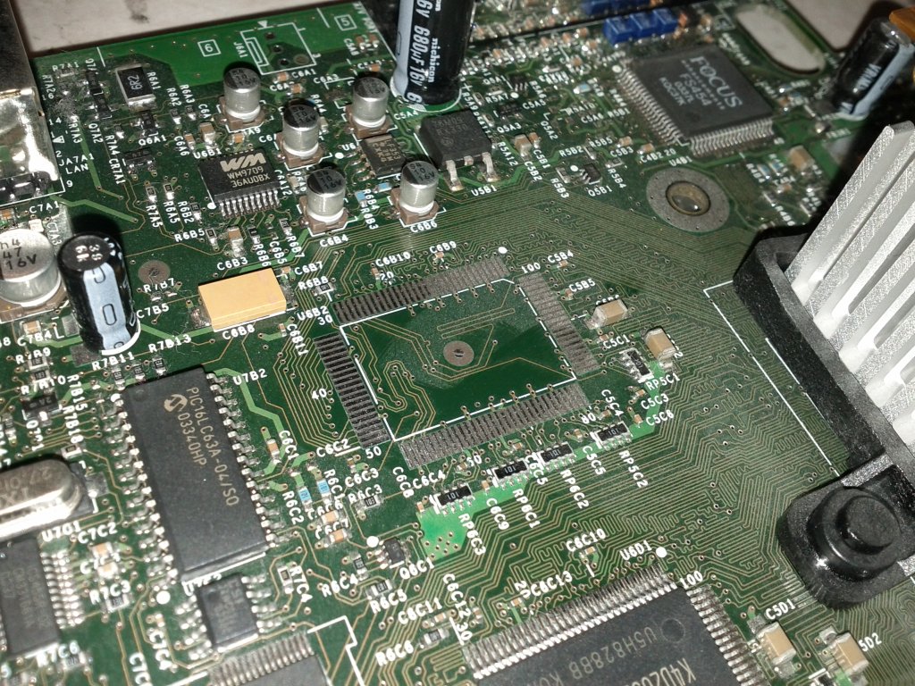

5. One of the empty RAM spots, board was a bit dusty! "before"
5b. One of the chips freshly installed! :D "after"
6. The mainboard after, all RAM slots populated - TOP.
6b. The mainboard after, all RAM slots populated - BOTTOM.

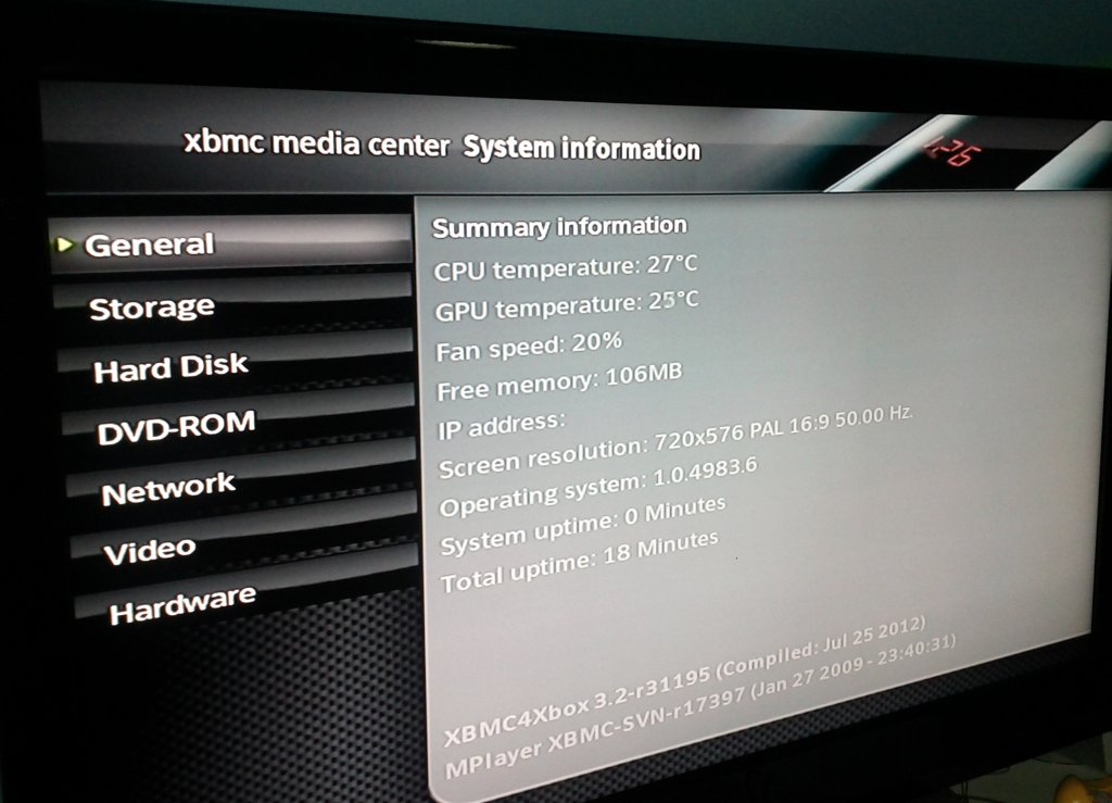

7. XBMC reporting 100MB+ free now ;)
