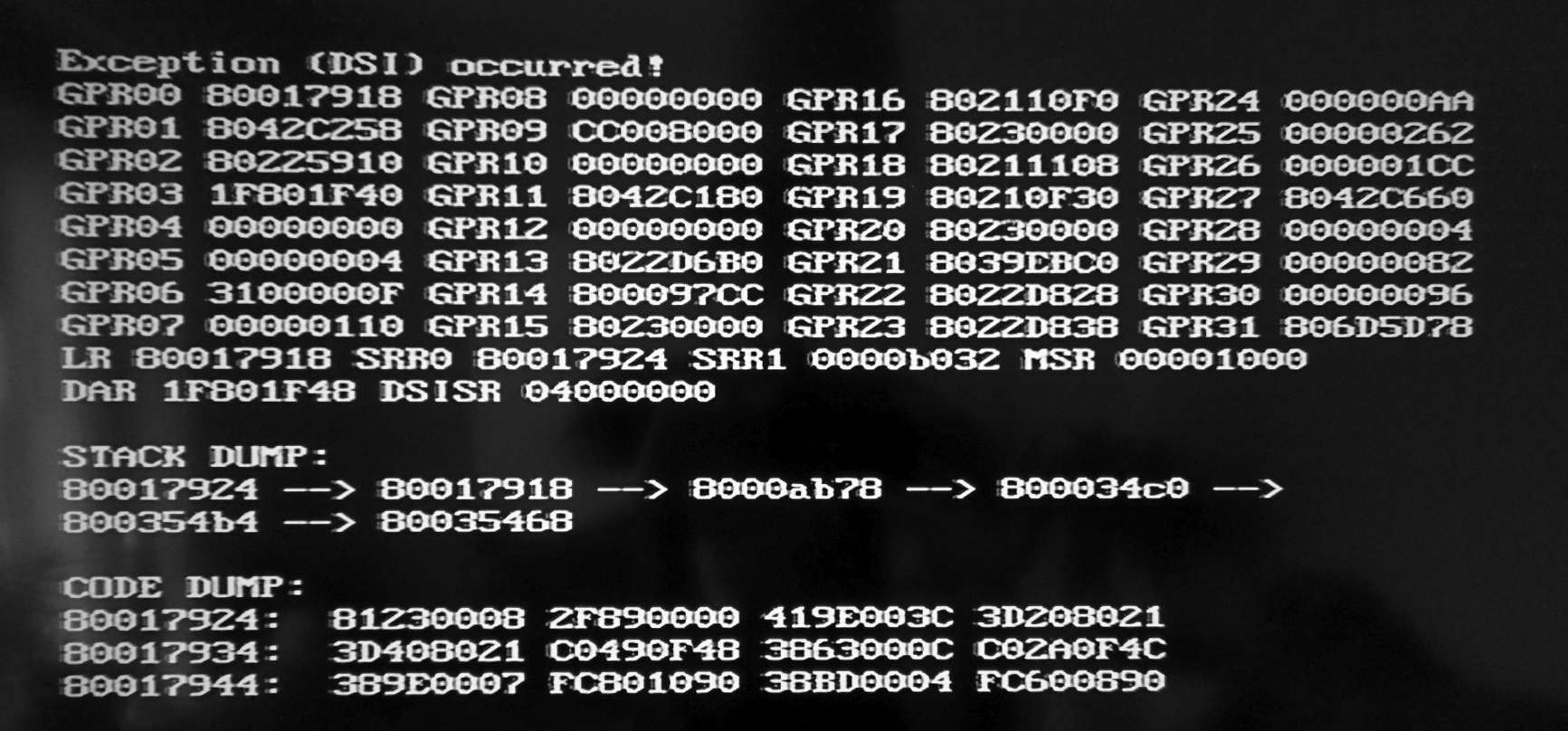

Post by Madowax » Wed Jun 17, 2015 9:02 pm
andzlay wrote:Hey guys,
haven't been using my GC for a while and first thought this would be a hardware issue like some soldering broke, but I tested a bit and now I think it's software related.
Nightly Build Version: I got this error on r296 and also tried r289.
Hardware: PAL GC
Hardware configuration: WODE with FW 2.9B (Boot Version 01.01; FPGA Version 02.00; HW Version 1);
Using a 64 SDXC "SAVETEC Ultra Performance, Class 10"
BBA is plugged in, but not connected
Boot method: Patched swiss_r296(pal).iso with PWCI to use it as a startup ISO for WODE
Info: The SWISS iso gets mounted in WODE and I select it to boot in the GC menu. Swiss boots to device selection. I select WODE and press "A" and receive a "Exception (DSI) occurred!" (photo attached here)
When I eject the auto-mounted SWISS iso and manually select a ISO or even the stock-WODE menu with the hardware display and buttons I can play my games.
I also tried to mount a unpatched SWISS ISO but same error.
EDIT: Tried an older version now and everything works. I'm back at r174 now
I luckily discovered that you can use r296 with wode (2.9 Fw), but you need a sd adapter with sd card inserted in the memory card slot, A or B makes no difference, in that way no error and Swiss works flawlessly, glad if this could help someone. ;)
